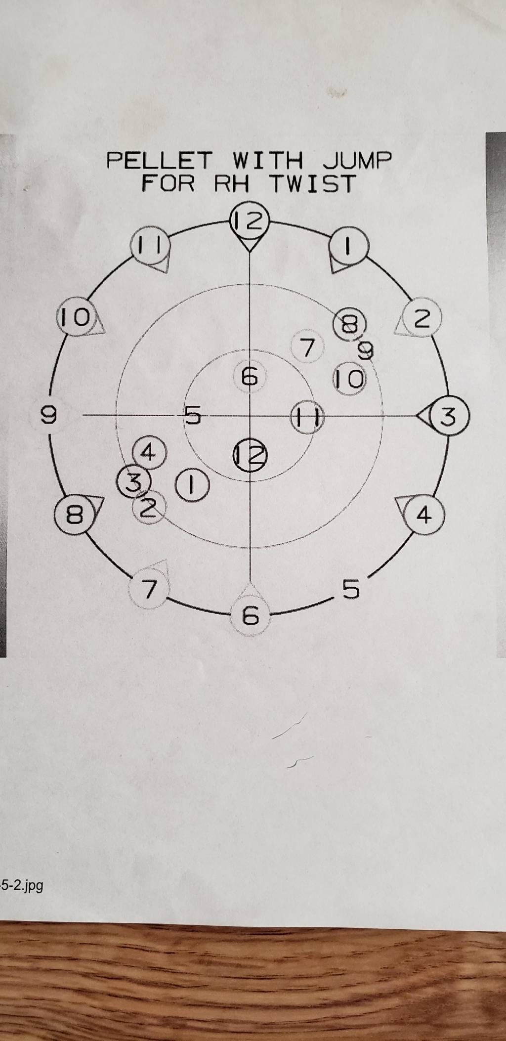

This is for the experienced BR shooters, looking for some knowledge
Let's say we have perfect equipment (airgun + pellets) for a right hand twist barrel, if I have a left to right wind perfectly constant from the muzzle all the way to 100 yds at 5mph (or whatever the speed is at but constant same wind), will the horizontal deflection be the same as if I have the same opposite (now right to left) wind.
In other words, If I have a 5mph wind coming from 9 o'clock will the deflection be the same as if I have a 5mph wind from 3 o'clock for a right hand twist barrel?
Just taking the vertical deflection aside. Will the hold be the same horizontally for both conditions?
Or put in another way, what will deflect more the pellet, a right or a left wind?
