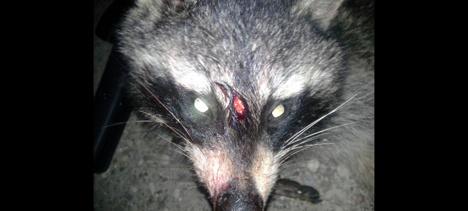

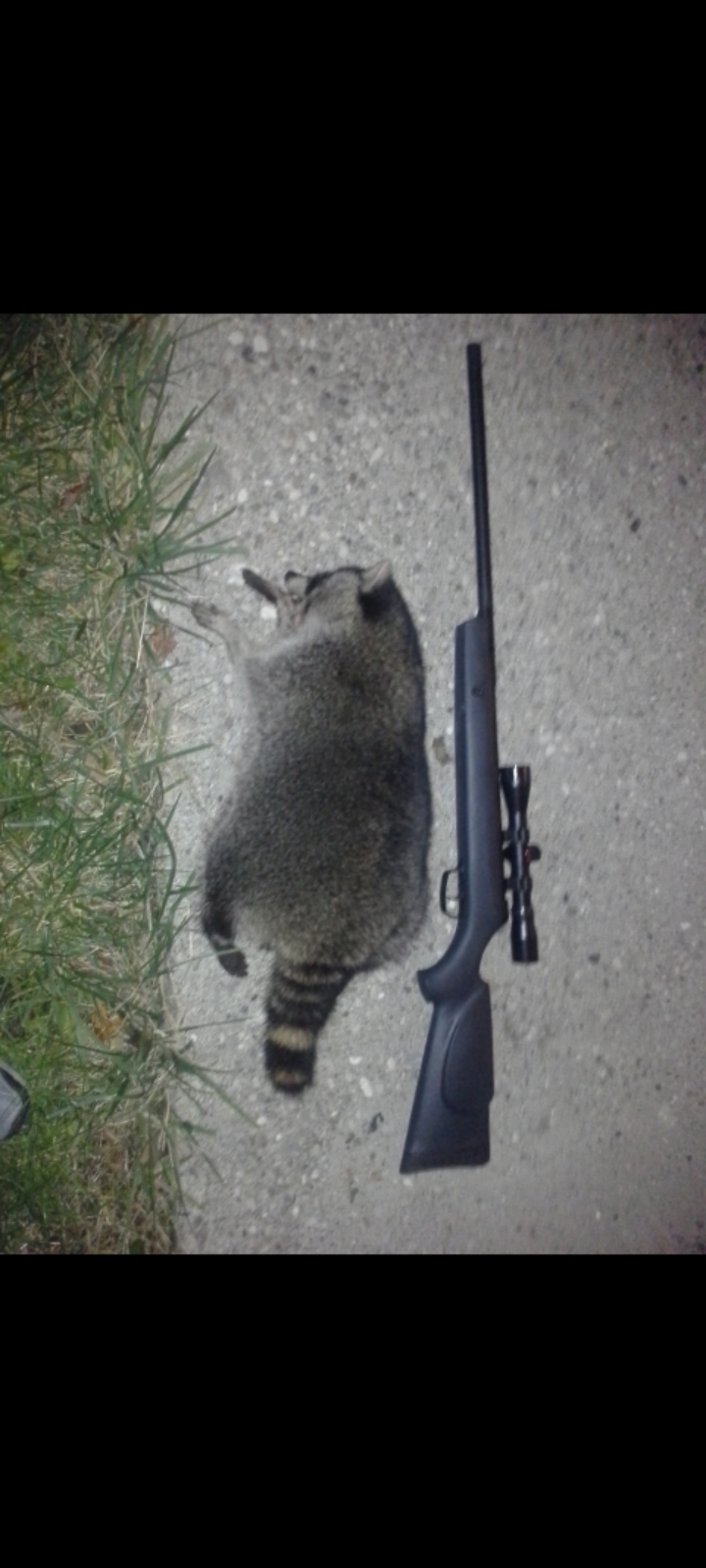

Shot placement is just as important as energy. Even 12ft/lbs will take a raccoon. $99 Gamo at 7 yards.
So i guess all the coons and squirrels are playing opossum when i shoot them with my .177 10.3 G pellets and a whopping 11.6 FPE at the muzzle ? 20 to 30 yards .

7 yards is point blank. Nice work but that certainly don’t apply to down range hunting
at 25 yards that 12 ft lbs is down to 7 or less. Depending on pellet weight.
What I'm saying is 12ft/lbs at impact is more than enough for a big raccoon as you can see the size in the picture. But it only worked because of shot placement. Vitals or head shot doesn't need a crazy about of power to be effective. I've killed squirrel and rabbit at 30 yards with that same gun that starts at 12ft/lb at the muzzle. 7fpe at impact will absolutely kill rabbit, squirrel and prairie dogs. Calculate what you need to begin with power wise to maintain that amount of energy at the distance you're going to be shooting based on the most accurate ammo you can find. Even if it's a lower BC. Again the shot placement is the most important and we owe that to what we're trying to harvest or dispatch. Those are minimum power levels. It's certainly okay to use more power but it's not always necessary.
