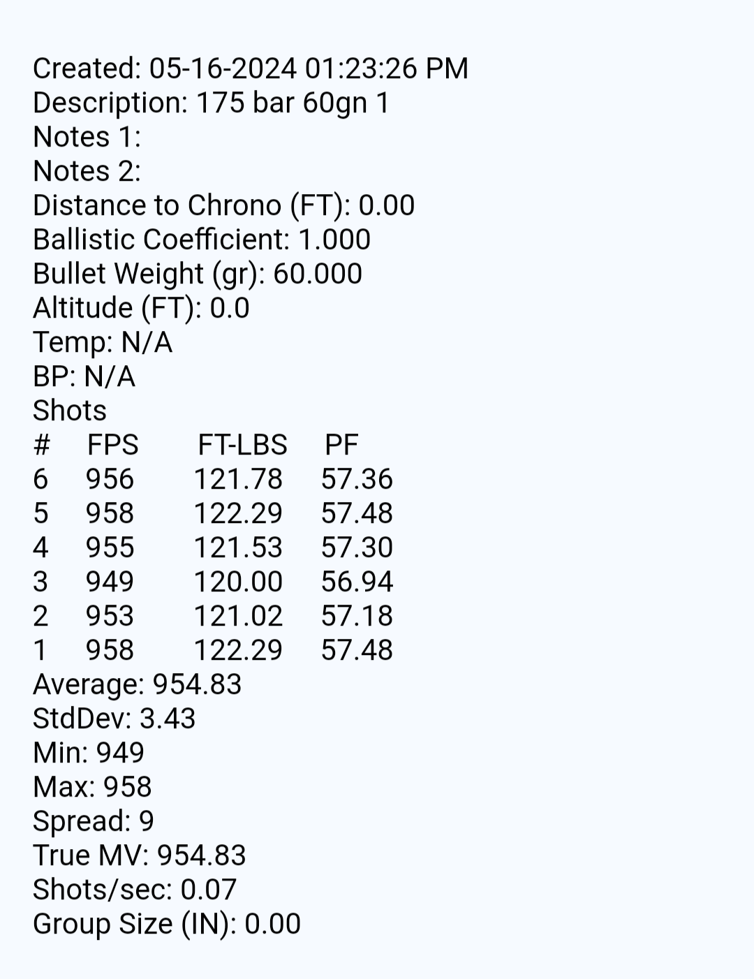

My Vulcan 3 I have tuned to shoot 60gn slugs @ 954 fps / 121 fpe ....at 100 yards it's still moving at 837 fps / 92 fpe. I set that so I can take coyote out to 150yds and still have plenty to spare. I take max range I am willing to take a shot at and make sure the minimum fpe is met for whatever game it is I'm shooting.
