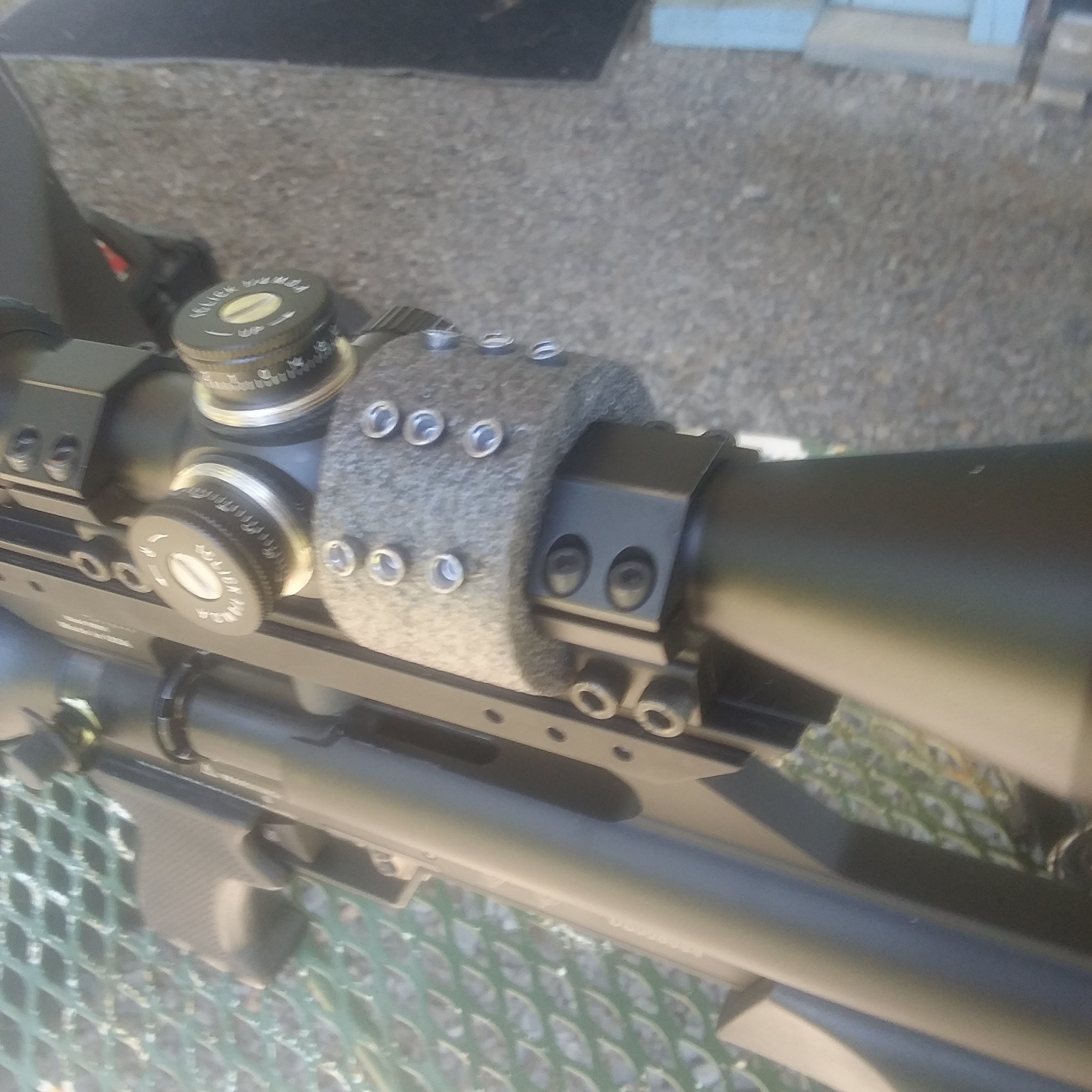

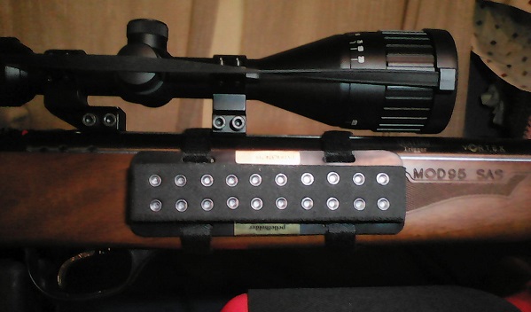

I have been looking for an easy way to access pellets while shooting my Talon SS. Vantage1200 on YouTube had the perfect one using foam pipe insulation tubing. Reloading is now easy as pie, Thank you Vantage1200. Bill

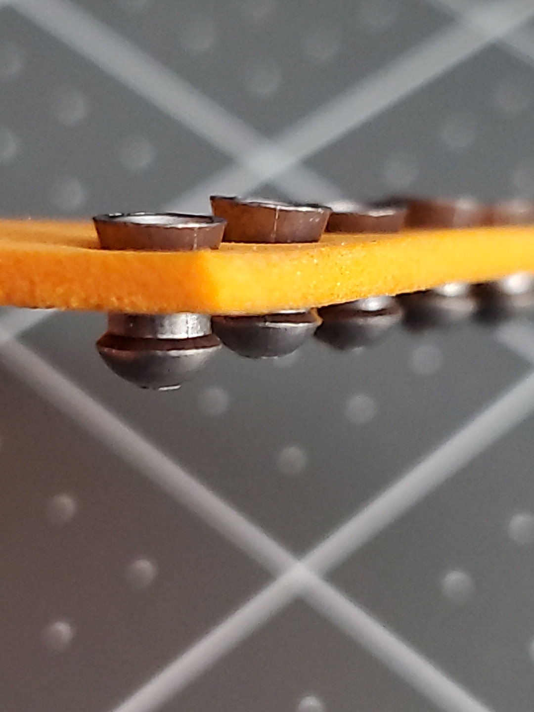

I do much the same thing with the pellet packing from Pyramyd. I tear the small round from one of the layers and punch 10 holes in it with a plastic spudger (about the diameter of a pencil) for .177 pellets. I like to load up 3 of these and drop them in my pocket when I go squirrel hunting.

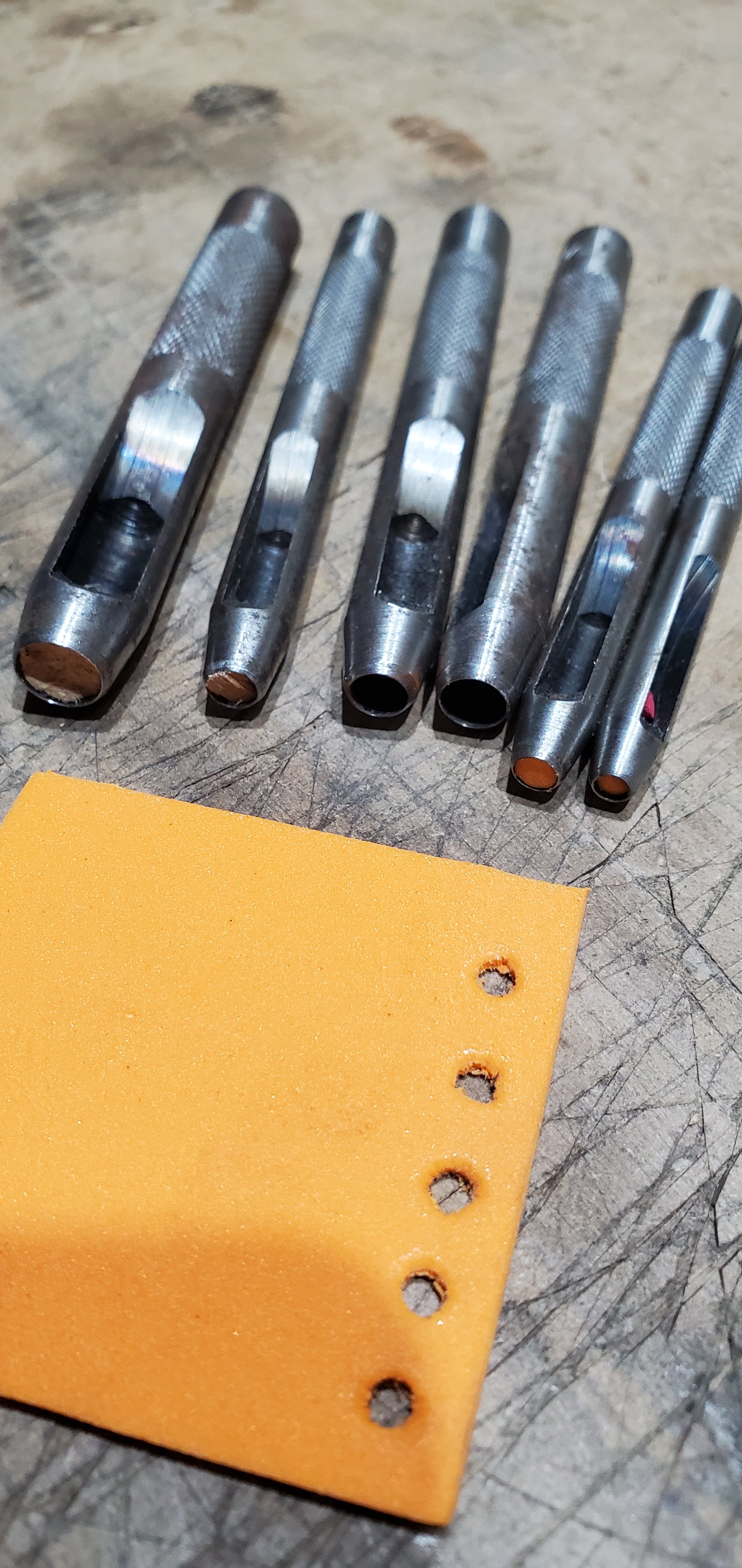

Drill bits work, sort of but the foam self heals. I used to work with rubber and foam sheets a lot at work. Two ways I learned worked well. One way is to use a thin wall brass tube like they sell in hobby shops. Cut it maybe two inches long and with a tiny triangle file, cut notches in the end of the tube to make it into a rotary bit. Put tube in a drill press and turn it on and it’s now a cutter. You can also skip the notches and either tap it into the foam with a mallet to cut holes like a leather punch.
If you make pellet holders out of thin foam strips you could easily use a leather punch.
Another way I used often with very thin metal, plastic, foam and rubber was to select a drill bit of desired size, then find a piece of plexiglass or aluminum or steel and clamp it in a drill press or milling machine. Now drill a hole with your drill bit. Remove drill from chuck and with a file , grinder or sanding disk face off the shank end so it’s flat and has a crisp edge. Now put drill shank side down in the drill chuck. Check to see if drill shank will easily enter the hole you drilled with it. If not, adjust your drilled piece so shank enters perfectly. Now you have an expefient punch press to punch holes perfectly.
In the machine shop I used gauge pins for a perfect fit instead of the drill shank but not many home shop guys will have them. They were nice because they come in one thousandth increments for a perfect fit.
