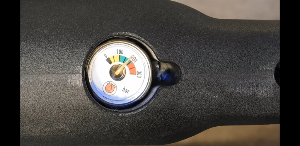

Howdy. I'm new to the site and to PCP world. I bought a Hatsan Vectis last week. Zero'd in the scope and the thing is amazingly accurate! UNFORTUNATELY, after about 50 shots, I managed to send two pellets down the barrel and jammed the setup. After using a wooden dowel to un-jam the barrel, now the gun isn't firing. Lever action cycles the round into the chamber, then squeeze trigger and click. No air release. The tank has about 1.5 bars in it, which is middle level of green for pressure.

1-2 bar in your gun means 100-200 bar, being 200 bar the max pressure recomended.
I think that you have a little miss understanding about the pressure gauge, not a big deal if you stay in the green area, like you said, is the safe spot.
