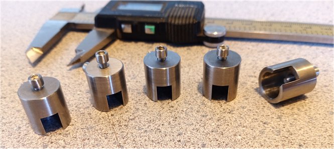

I shoot .30 44.8 FX Pellets out to 100 yards at 1", same for .25 25.9 Dead Center pellets. But I only have the Wildcat. I made a few IHS and can change barrels from .30 to .25 and install my preset IHS for each. But, that's just my case. For some reason I've been eyeing an M3 :unsure:

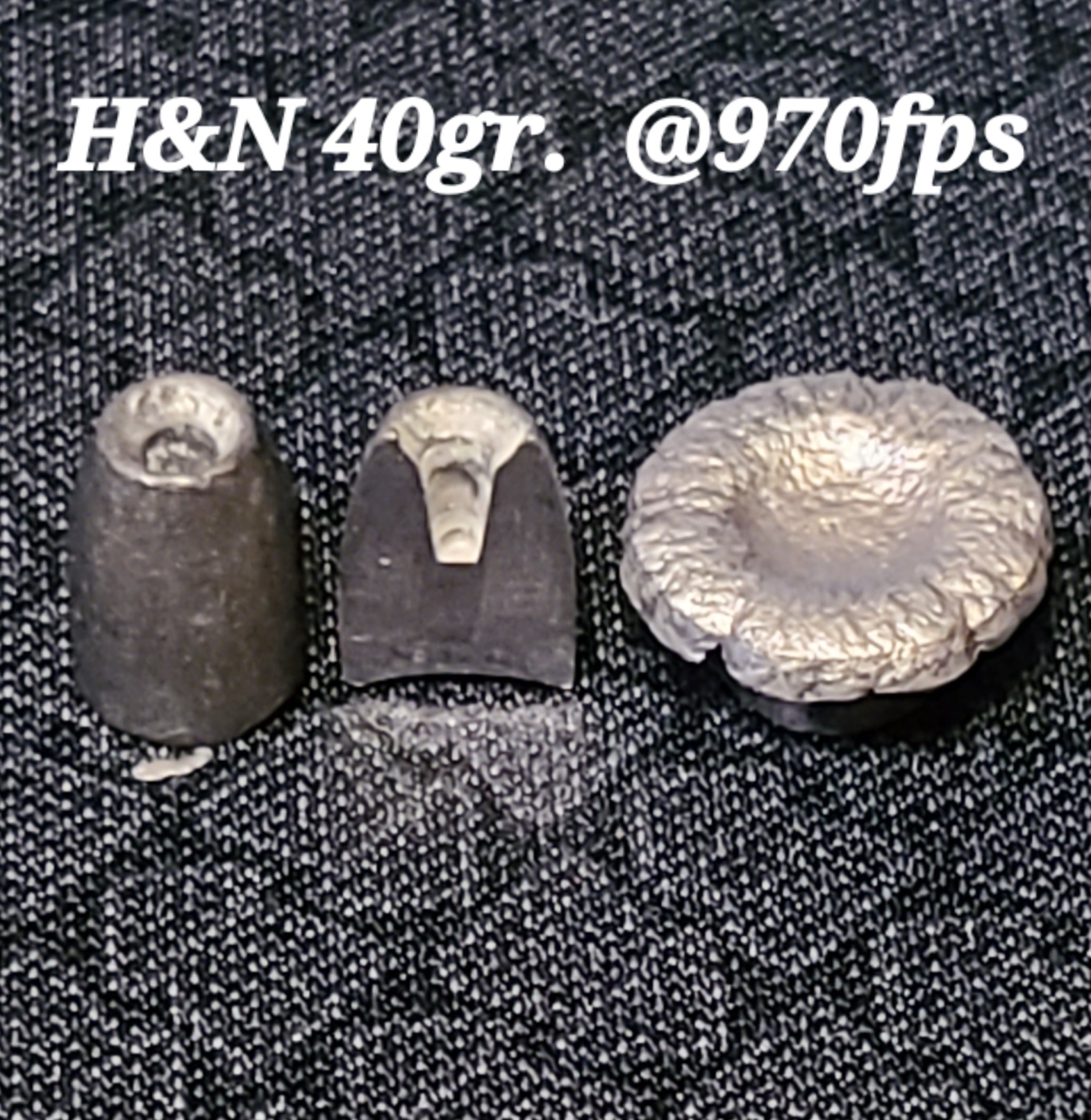

Apparently you have to shoot pellets to know about shot placement.
I started shooting pellets 10 years ago.

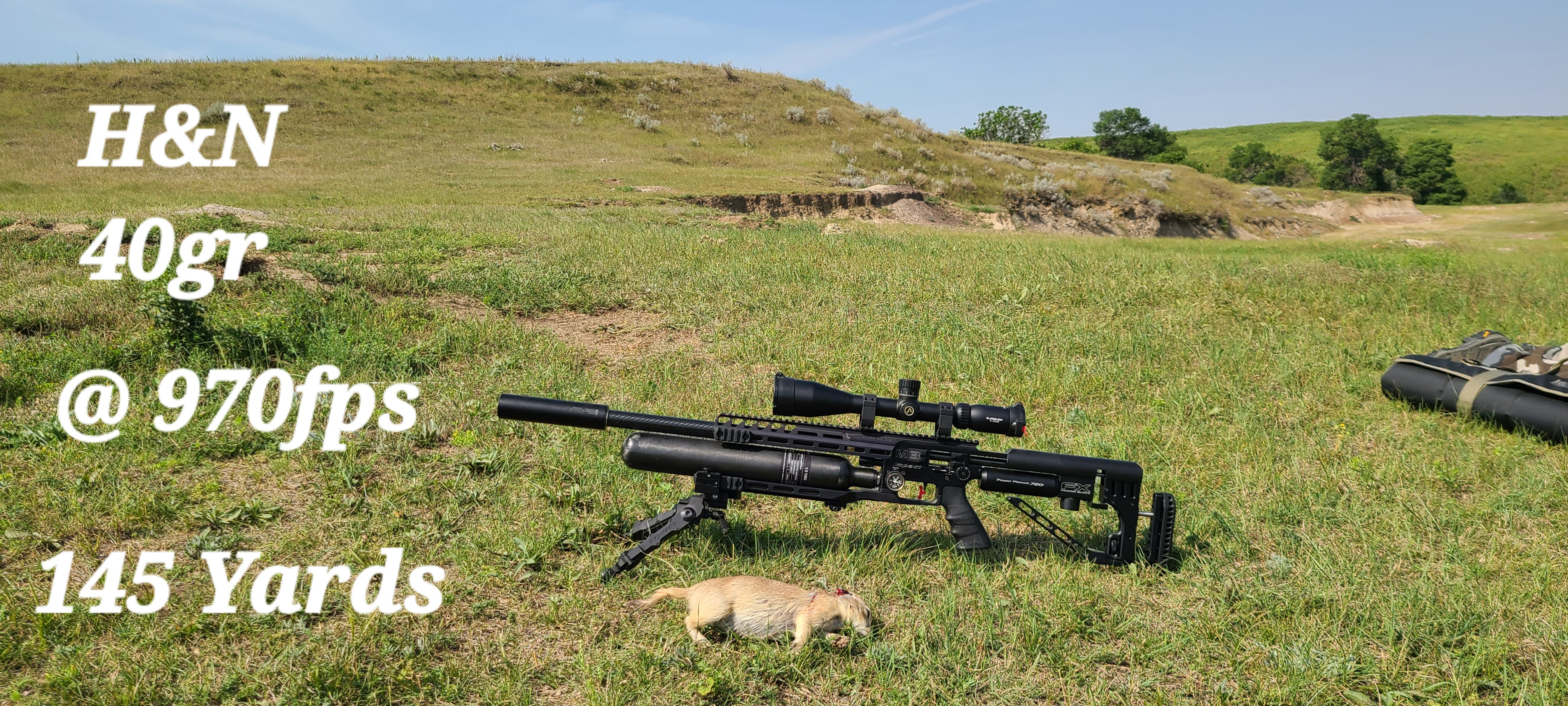

The 1st time I went pdogg'n with pellets I knew there had to be something to make a more humane kill and extend my range.
W.I.N.D Weather In North Dakota if I didn't shoot in the wind I would hardly ever get to shoot.
In North Dakota the prairie dog towns I shoot at are hunted by guys, (me included) with centerfire rifles.
Even with a suppressor, after taking a few shots most of the prairie dogs are down under 200 yards. Making shots from 300 to 400 yards with my 204 Ruger is what I get, so 145 yards with my Impact M3 is well within the maximum range of that rifle.
At 145yards the H&N 40gr traveling at 970fps still retains 62 ftlbs of energy wich is equal to or more than any .25 caliber pellet has at the muzzle and makes a complete pass thru stopping the prairie dog in his tracks.
