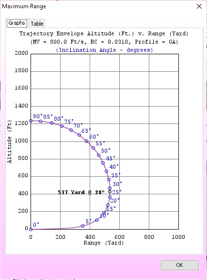

With a typical PCP 22 caliber rifle (mine is a Benjamin Maximus at about 800 fps I think), How far can the pellet (15.89 grain) travel at a maximum distance? For example, pointing up maybe 20 degrees into the air, how far will the pellet travel? (I would never do it recklessly, by the way).
Just a question.
Maximum looks to be about 537 yards if launched at about 28 degrees.
According to Chairgun 800 fps

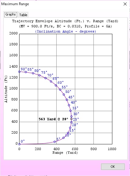

900 fps
Couple of interesting things. First the angle does not change when you increase power so 28 degrees. I would have expected a higher angle myself. Second we increase velocity by 1/8 or 12.5% but we increase range by only about 5%.

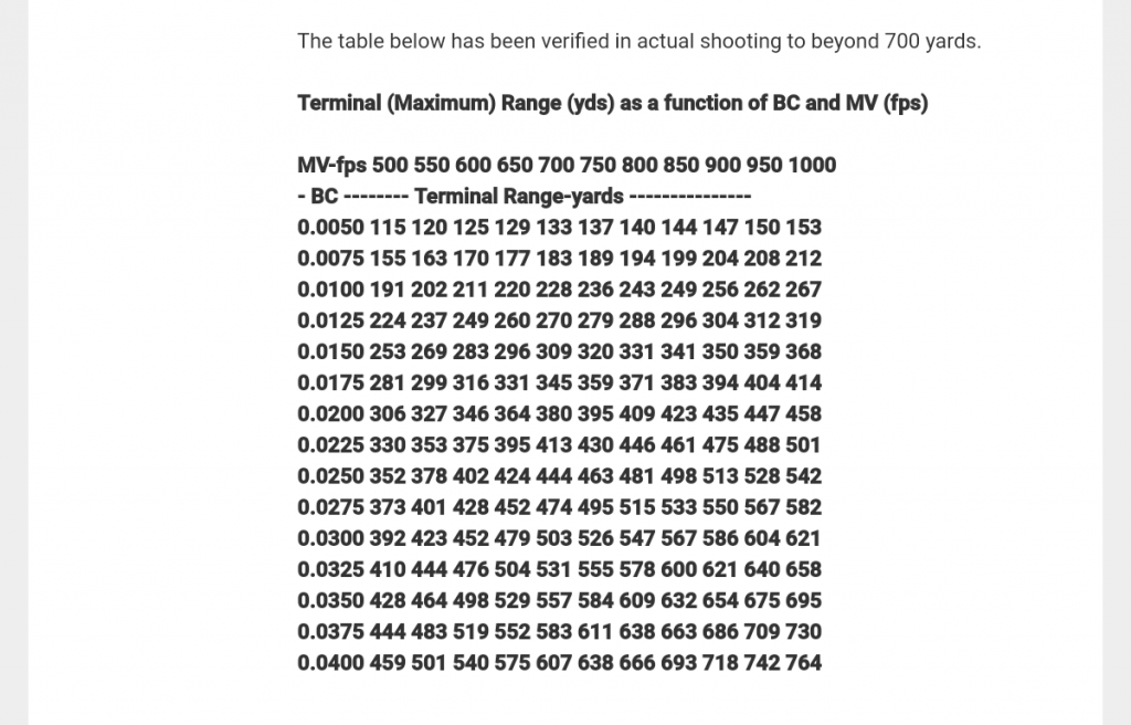

The maximum distance under most circumstances would be achieved at a 45 degree incline, not at 20 degrees. The maximum distance of a 22 cal pellet at a know speed would be affected by air resistance of pellet, air temperature, elevation or air density.
Sorry - this is not correct information. Do not assume that because 45 degrees is halfway to vertical it would give maximum distance. The max distance angle is actually around 25-30 degrees depending on the speed.
His answer is correct if using any freshman level Physics text. However, this excludes air resistance. Without air resistance, max range is always at 45 deg no matter the projectile. Once you add air resistance, things get more complicated.

So "under most circumstances" means his answer was incorrect, as ctshooter stated.
