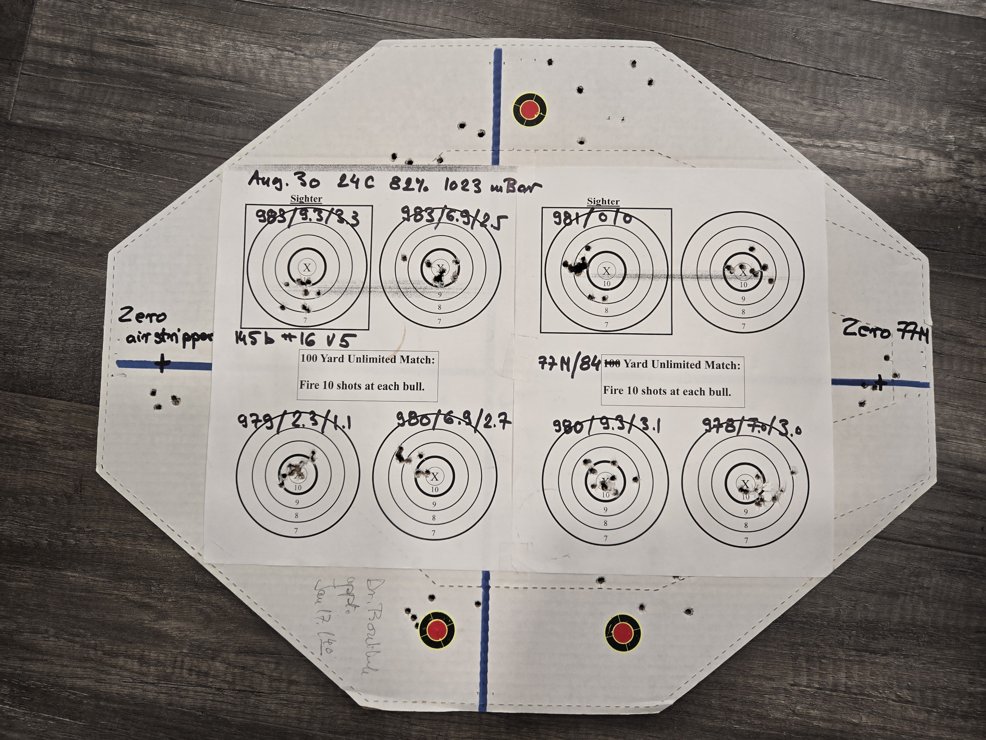

Hey Vana2
The MRD's works very well for 50 M rings, but nothing special for 70 M and for 100 M is a disaster in my eyes.
My last attempt to test the MRD's @ 77 M, 10 shot groups. Expecting the .22 heavier slugs shall do much better.
My gun range was designed for centerfires in mind, the long distances have a lot of "leaking wind" through the side.
So far I have tried tons of pellets in .22. The H&N 18 gn and eventually 21 gn is my second choice for 50 M.
I am tinkering dedicating this Impact MK2 for 100 M rings, I have the other .22 gun for 50M. Also my .22 Leshiy2 behaves satisfactory with 20-100 Y silhouettes.
I tried for a year (or two) the .25 slugs didn't worked extremely well I wanna try now as a .22. I have all the parts - can build plenty of scenarios, only what I don't know yet the .22 slugs how easy to propel with pellet probe.
Winter here, yes I can tune in my garage for ES/SD but that means nothing without shooting the rings.

What liner are you using for the MRD’s? I dabble with them at times out of my .22 slugger. I switch to a 1:16 for them.
Anything heavy or longer in the caliber of the liner seems to do better with the 1:16 for me.
.25 heavy mk1 and 2, Hades and slugs 30 and over.
In .22 monsters, 33.95s and slugs 21 and heavier
