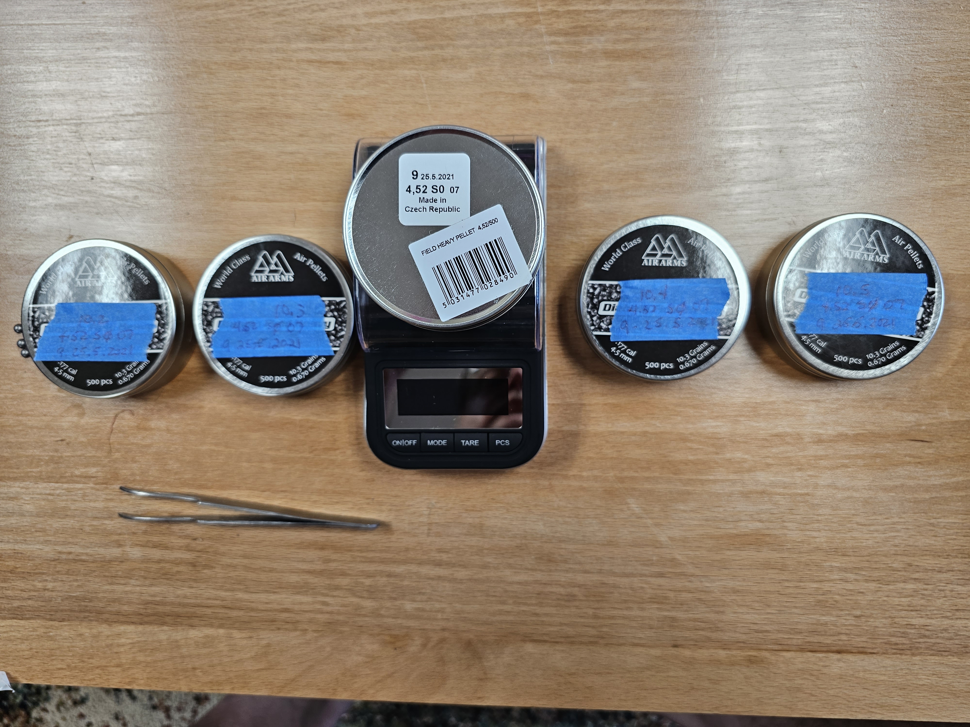

I have been ill for a few days. As a means to kill some time I did a pellet prep bing yesterday. I prepared about 3000 pellets for the final lubrication phase for use in my TX200. I don't do that phase until I am ready to shoot them.
I typically use AA Field Heavy 10.3 grain in 4.52mm as they work well in my rig. They are usually very clan with a consistent head size. As such I do not generally clean or sort by head size. However when I get an inconsistent batch I do head sort.
I sort into bins routing to the nearest 1/10th grain. It usually takes 4 bins. I pull any damaged at that time as well.

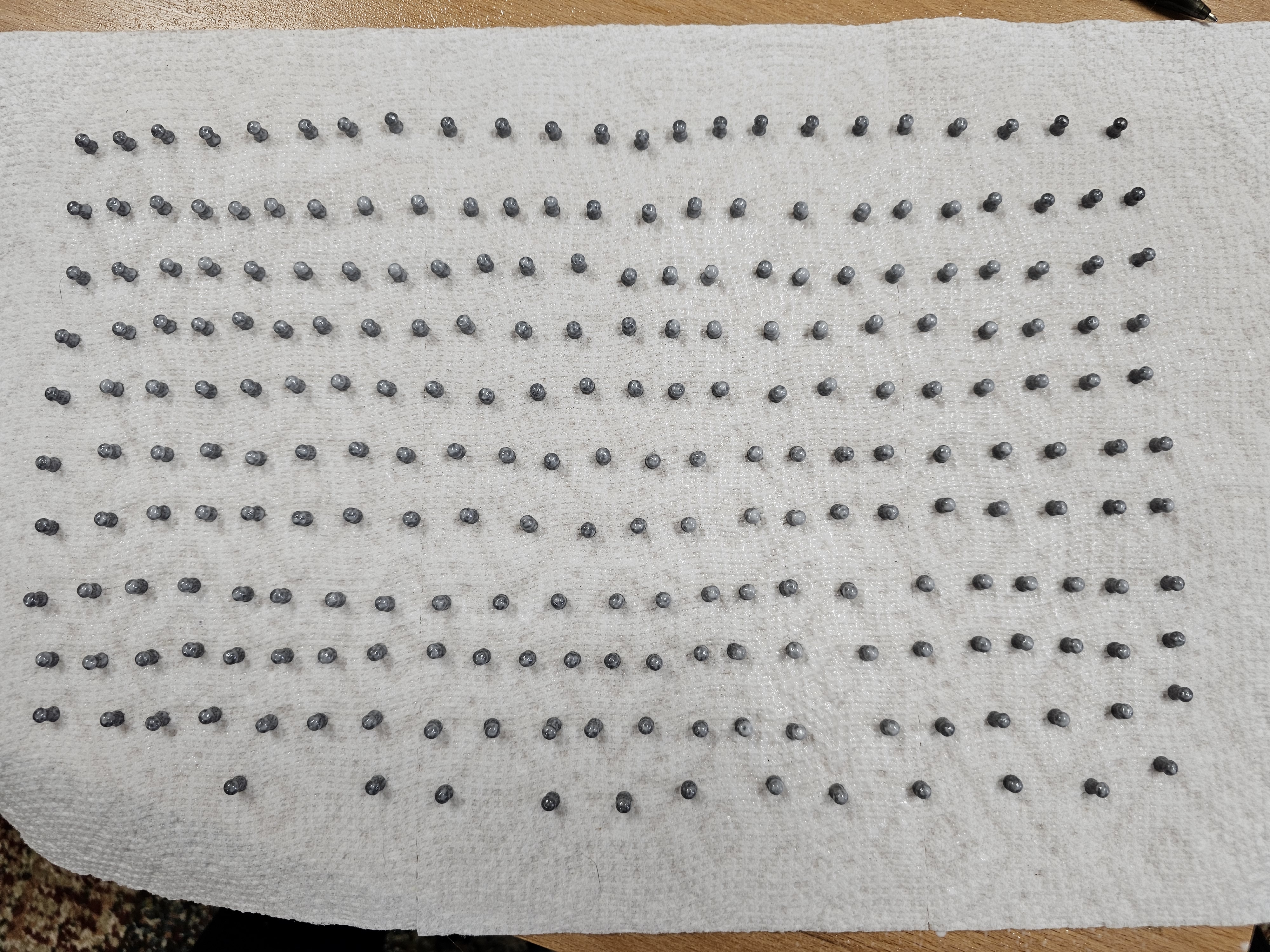

After that I then set them up for lubrication. I use bees wax. I stand the up to keep the lubrication from getting behind the skirt.

I was playing around tonight at the range. I have been out for a week with bronchitis so I'm way out of practice. I was playing largely with leftovers of lots. So, these are from various lots. Not real comparable as a result.
All are AA Field Heavies advertised as 10.3 grain 4.52mm head. I was shooting 50-yards as usual.
1. Reasonably consistent feeling heads sorted to 10.5 grain.
2. Reasonably consistent head size sorted to 10.4 grain and wax lubrication.
3. Pretty inconsistent lot sorted to 10.3 but head sized to 4.50mm head. They were wax lubed.
While overall sizes were not dramatically different the consistency to flyers were different.
I shot the smallest 10-shot group ever at 0.63". 🤩 I have it on video as well.

When I was competing, I did similiar prep, but standing up each ine of them little buggars was to much trouble!! I used a clean T shirt cut into 6" wide x 12" long strips. I sprayed a gob of beeswax in the middle then added a small handfull of pellets in the middle. Then picked up each end and raised/ lowered each end to coat my pellets, and keep the lube out of the skirt.. Only takes a few minutes and works excellent....sure beats trying to stand each one on end !! My arthritus thanks me every time !!
