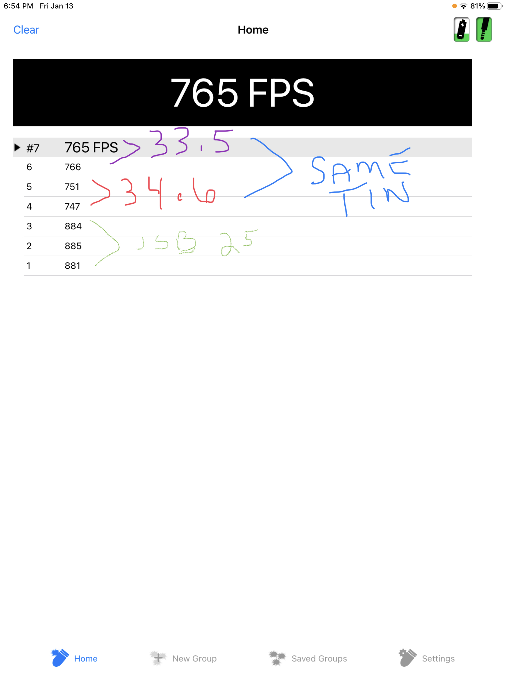

Been pissed off at this gun for a while. Swapping regs, complete tear downs, new lube on crucial parts and various hammer settings below the plateau. So tonight I weighed what I had left in my tin. I chose 2 pellets that were in the lightest group and 2 from the heaviest group. I switched to my .25 that is set up to shoot 25gr pellets because I know it’s shot strings are flat. The first 3 shots are with 25gr pellets just to make sure the gun didn’t go off its nut. The next two were the light then the last two were the heavy from the same tin. Now if you’re a numbers guy and you are happily shooting 765-766 then start getting 747-750fps off and on, this could have you questioning your tune or components. If you’re not a numbers guy the bad news is the two pellets from each weight went into the same hole. But not the same POI at a measly 30 yards. Sorry for the chicken scratching but this stuff goes in my personal notes so I don’t get all professional. Bottom line is bad pellets make you shoot more pellets. Is there something sinister about this or do they just rack you hard for crap pellets now. Do our guns shoot so well now that this is now noticeable. Who knows.

If you have a decently powered airgun the pellets having slightly bent skirts isn't a big deal IMHO. The force of the air pushing the pellet Will expand the skirt to conform with the barrel sufficiently. I believe the bigger deal is variance in pellet weights. More than a .2 grn difference in weight (18.1 vs 18.5) will effect POI

I bought my first tin in almost 4 months yesterday. Hades 25’s. Normally my gun loves them. This tin they were having some issues. Inconsistent accuracy. Skirts all looked really good. Put the gun on the chrony and my ED’s were 20-30 fps. I had an older tin of JSB 25.39 King’s. Problems went away back to one hole groups and consistent velocities.

I can't tell you how many days I spent fiddling with my Daystate trying to figure out why it was shooting all over the place before I realized every tin in the batch I ordered had unseen pellet inconsistentencies. My shots were fluctuating 30+ fps with two pellets looking exactly the same.. those were JSBs.
