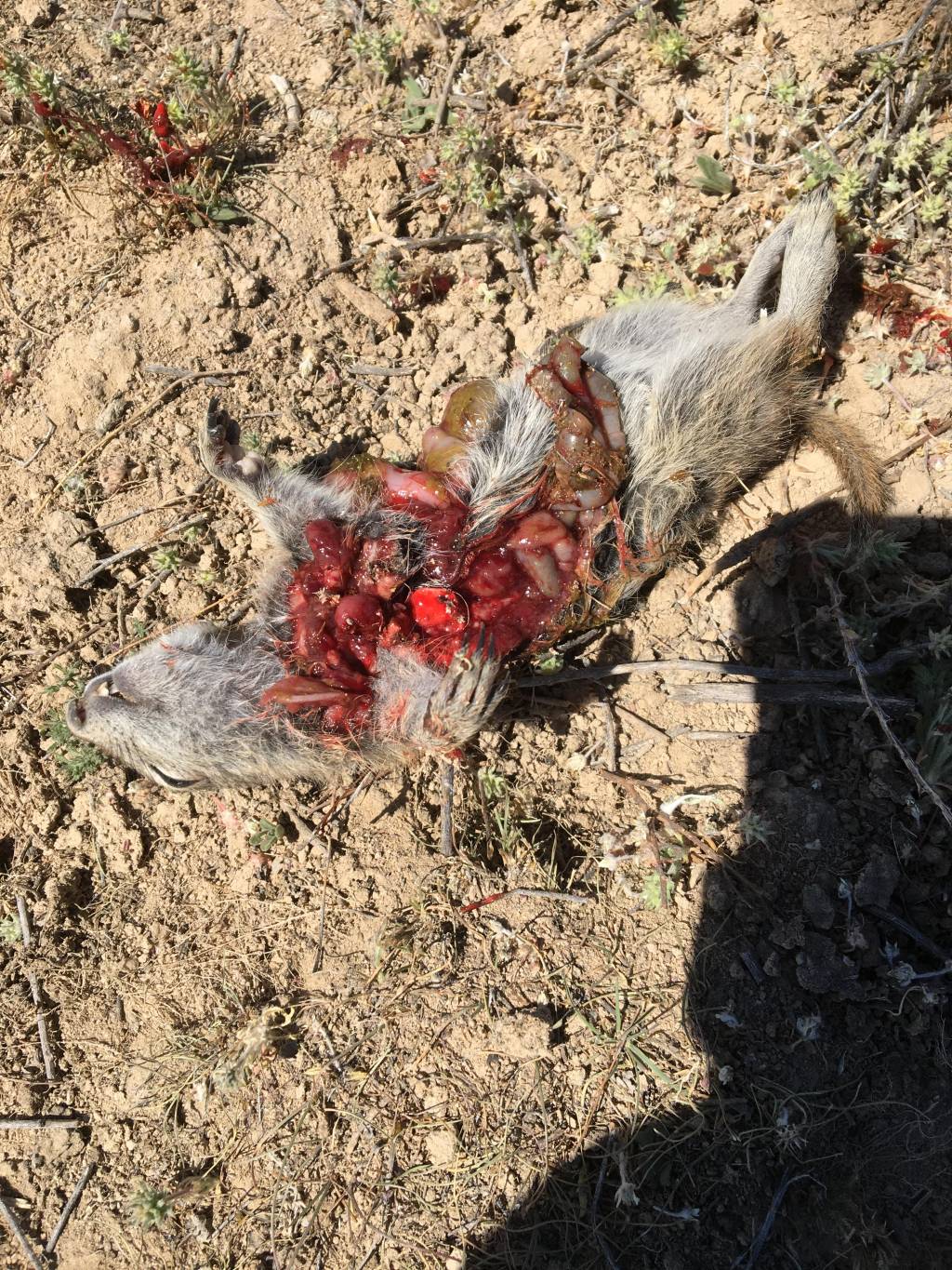

Heres a polmag hit out of my edgunPoly mags if they shoot good out of your gun
