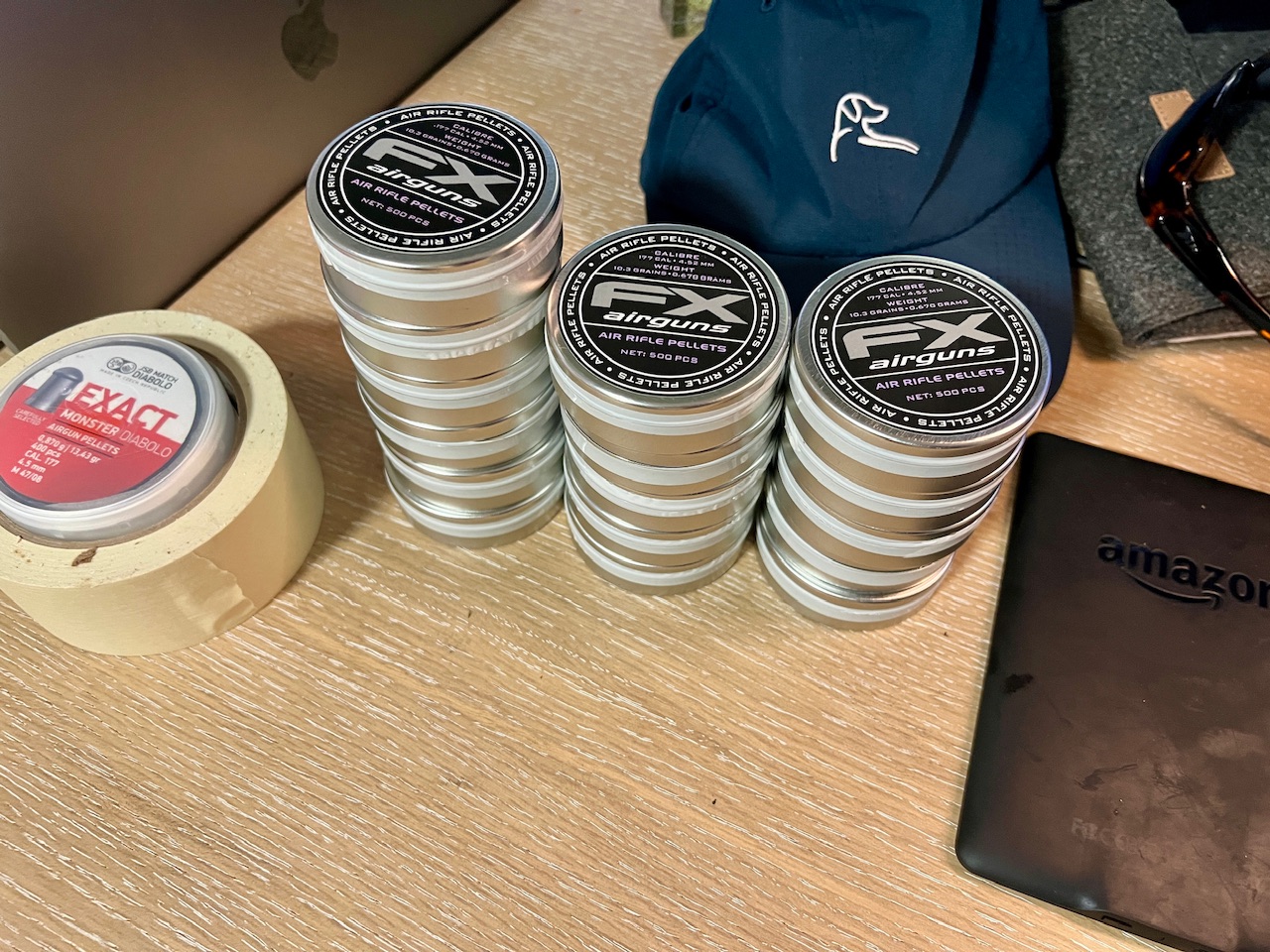

I find it easiest to find a good pellet, and just make an order once or twice a year. My family gets be Trenier gift cards for my birthday and Christmas, so that does well to purchase twice a year.
My Christmas spoils.
