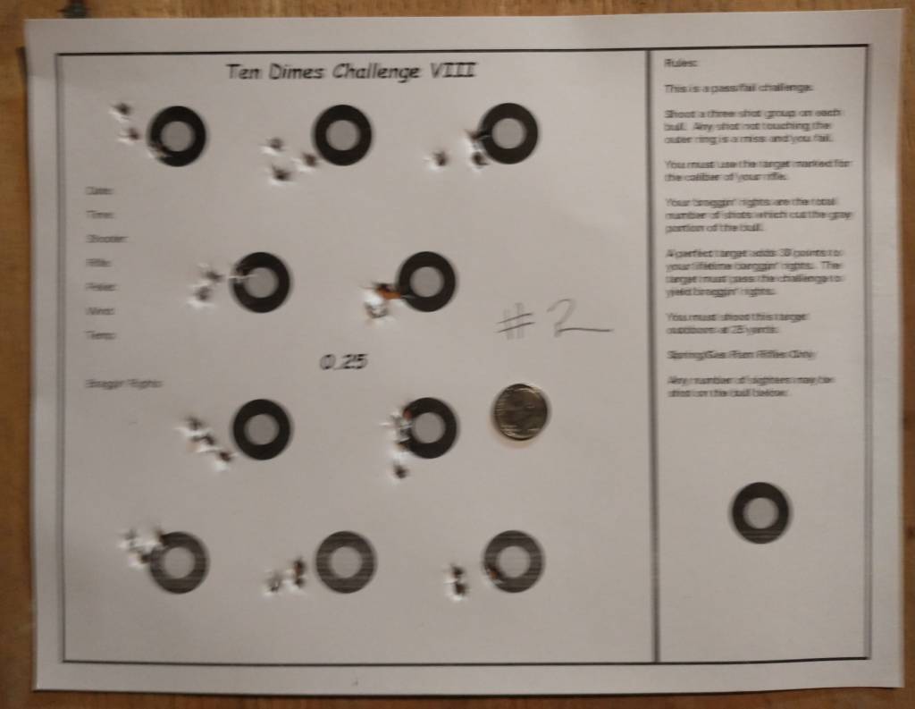

I have rerun the test I did out of doors last week. Which can be found here. I've done it indoors. As I mentioned these are H&N Baracudas at about 688 fps.from an HW-98 in .20 cal mounting an SWFA 10x42.
This time shot 30 shots per target and did not remove any fliers. I was indoors and there was no weather to contend with. The distance this time was 25 yards vice 25 meters.

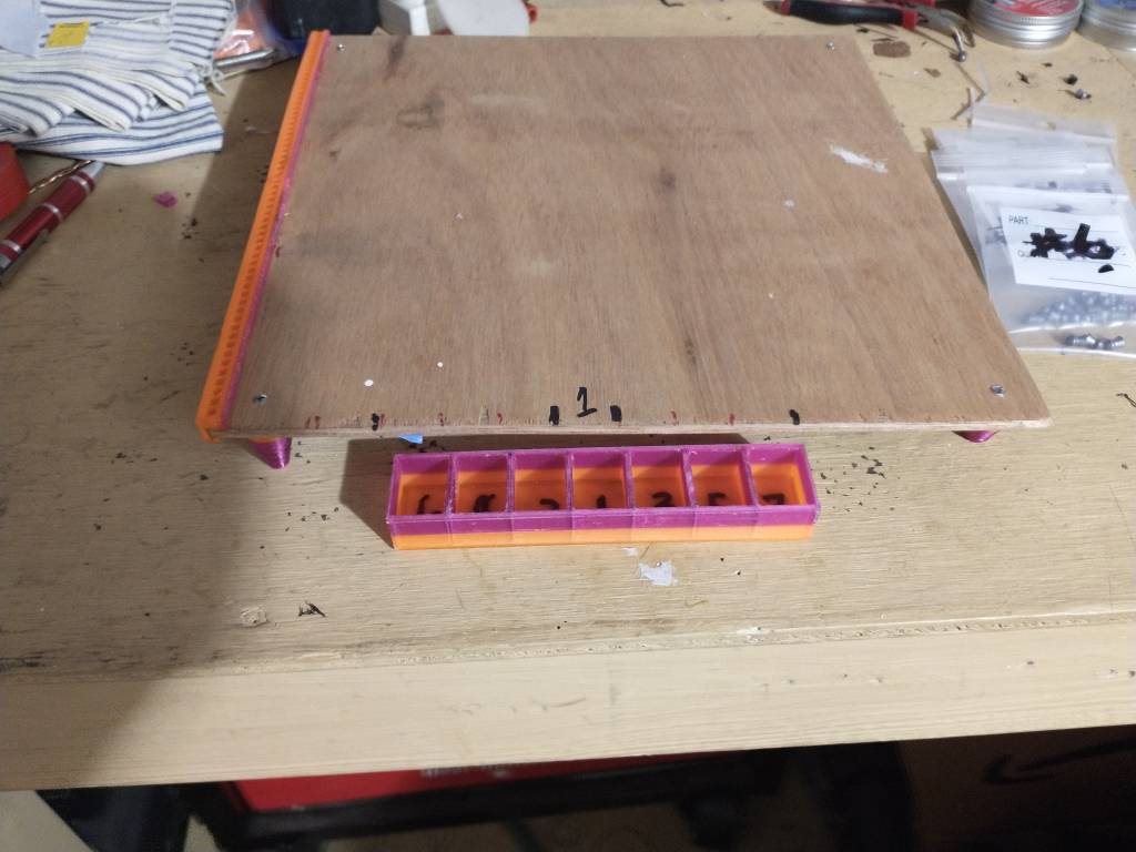

I rolled a few hundred pellets on a Yrrah style roller I made. The catch box had 7 cells in it. Nearly all the pellets fell into the cells numbered #1, #2, and #3. The center cell was #1. The cell "above" it, that is the one on the high side of it was marked #2 and the cell below it was marked #3.
A very few pellets fell into the cells higher (4 and 6) and lower (5 and 7) but there were not enough to collect 30 samples in any cell other than #1, #2, and #3.

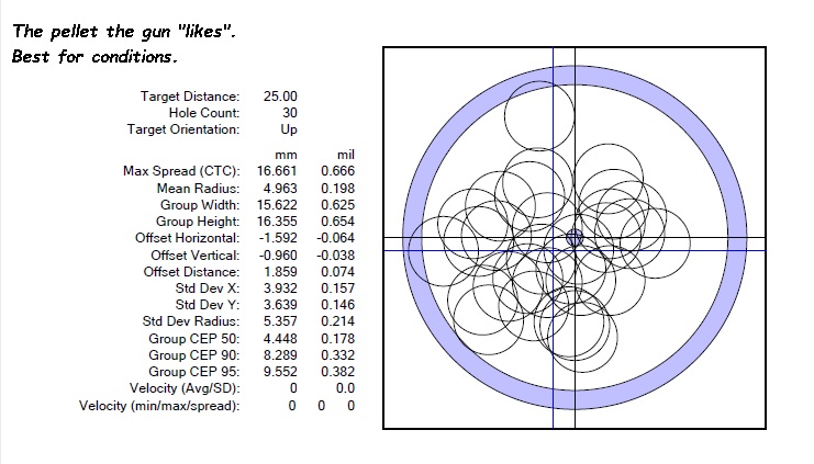

I shot groups for the three cells (1,2,3) and control groups "from the tin". I also shot a set of groups with the rifle's favorite pellet to establish a provable limit of my ability with the rifle under those conditions. This proves the test platform is sufficiently accurate to measure any difference which appears in the data.
I have included each target here and the aggregate group from "On Target" for each target IN THE ORDER in which they were shot.

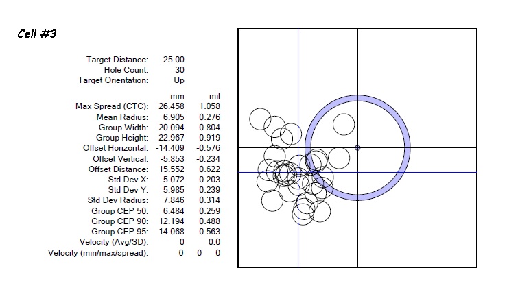

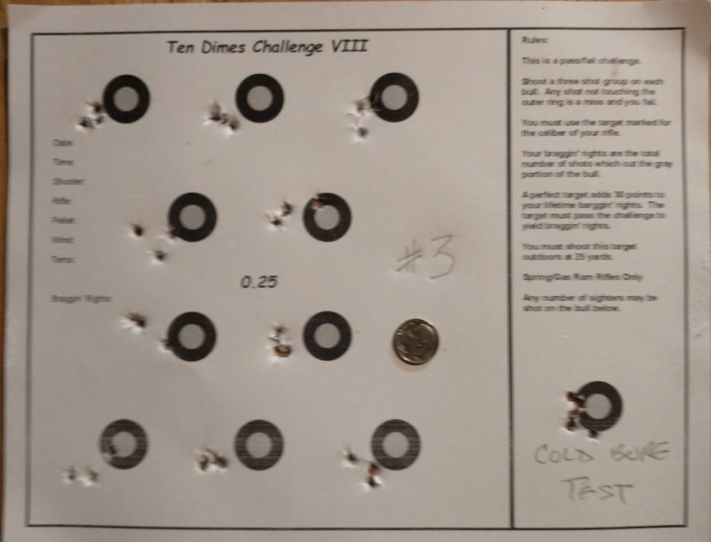

CELL #3 (Rolled further than center)

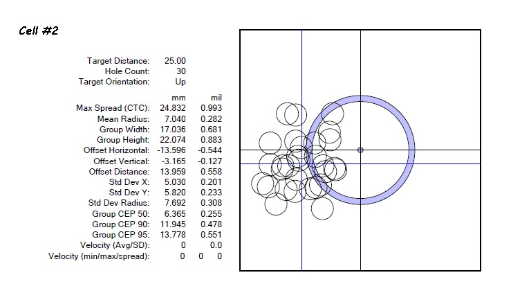

CELL #2 (Rolled short of center)

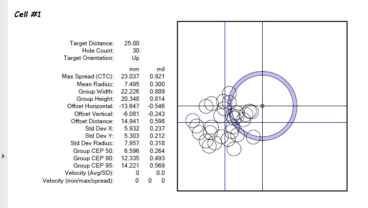

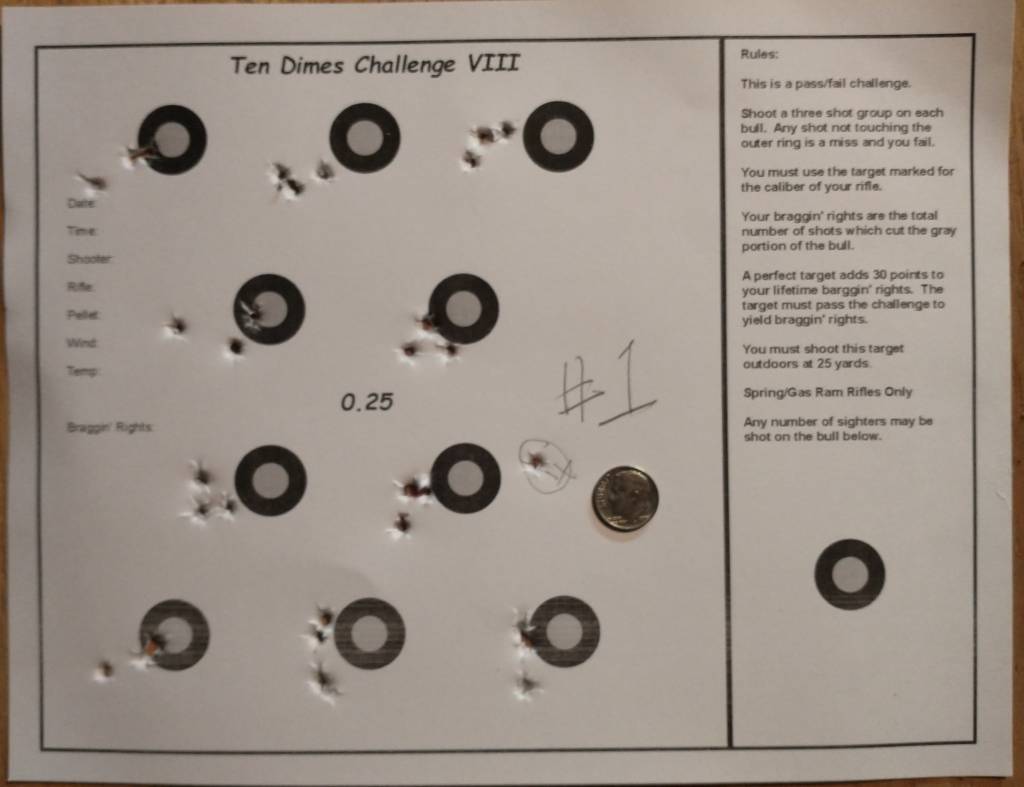

Cell #1 (center cell)

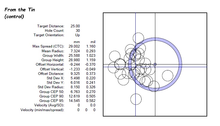

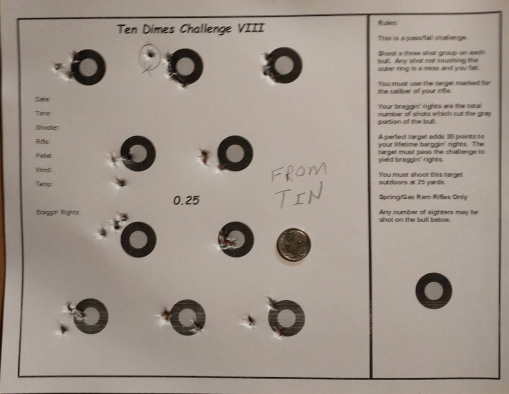

CONTROL GROUPS

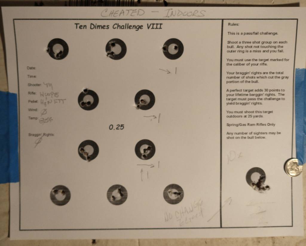

No doubt someone will say, "Why didn't you use a PCP? ... they are more accurate." Some people can't shoot springers. Some can. To that end I have shot one additional target which shows the level of accuracy with which the rifle and shooter were performing on the other targets. In other words THIS TARGET is here because it proves the accuracy of which the system (meaning shooter, rifle, and platform) are capable is more than sufficient to measure a difference in the test pellet. This is the pellet the gun prefers ... This proves we have enough accuracy to measure a difference.

I did not put conclusions in with the data. I left that for the reader. Some will say, inconclusive. Some will say, obviously there is no benefit. Some will say, clearly rolling them helps. Some will say the test bed was not sensitive enough.
I will not conclude anything. I will direct you to the 95% circular error probable numbers at the bottom of the aggregate groups. They are:
The CEP for the "preferred pellet" which establishes we have sufficient accuracy in our test bed is 9.552 mm, about half the diameter of a dime. That's PCP country for most shooters. The average of all 4 test groups is 14.153 mm, still smaller than a dime. Clearly the test bed is more than accurate enough to measure the difference..
have you thought about weigh sorting them after rolling? could you post a picture of your Yrrah roller table?
I can, sir, and I'll go out in the shop and put that up here in a few minutes.

I did all the rolling a couple of days ago. This has been lying in the shop getting mistreated but idea is there. That is a piece of "Luan" AKA "Door Skin" sanded to 400 grit and oiled with tung oil. Slick enough for sure but still with enough bite to make rolling positive, not slippery. Some say glass is better. I printed an edge stripe so that I could mark the starting point with a pellet and marked the edges of the board so that I could replace the catch tray in the same spot after dumping (number one filled fastest). I printed four feet so that I would always have the same tilt as long as I put it in the same place on the table. Should have been plenty good enough.
Well what I see is the preferred pellet is much better than the test pellets , don't switch.
:) Ha! I picked the worst pellet I have found for the rifle as the test pellet because I wanted the largest error to start with. You know the diameter of a dime is 17.9 mm. Even the bad pellets are good enough to take hunting.
That's a ten shot group on the sighter bull of the preferred pellet target. Point of aim was the bottom of the black circle on that bull. I did not include that data in the statistics. Just shot that one for fun and to confirm zero. Needed to take back a couple clicks of right windage after I saw it.

Try using a thick piece of glass to roll on
the wood grain will hamper the pellet rolling. Also be careful as to how fast they roll, they'll "skid" out and skew the test. I got decent results by having the "rolling table" be raised about 3/8-5/8 inch
Yes, I agree with you, the slower they roll the better result you will get. The feet on my table are 40mm on the high side and 20mm on the low side. The table is 12" wide. They roll pretty slow.
