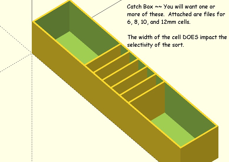

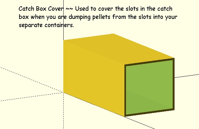

Below each image is the STL file for that image so that you can print the part if you wish.
View attachment yrrah-roller-box_cover.1628793157.stl
View attachment yrrah-roller-catch-box-6mm.1628793460.stl
View attachment yrrah-roller-catch-box-8mm.1628793461.stl
View attachment yrrah-roller-catch-box-10mm.1628793461.stl
View attachment yrrah-roller-catch-box-12mm.1628793461.stl

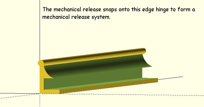

The next two pieces snap together to form a mechanical pellet release and a hinge.
View attachment yrrah-roller-edge.1628793780.stl
View attachment yrrah-roller-latch.1628794017.stl

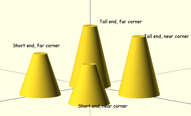

The slope of the table is very important. You will need these 4 feet. They are sized to work with the catch box height as well. Get yourself some small rubber feet at the hardware and stick them on these. There are 4 feet. The table SLOPES IN TWO DIRECTIONS, right to left and back to front. You will observe that no two legs are the same height. Before you glue them to your table make sure you understand how to lay them out.
View attachment yrrah-roller-feet_x4.1628794354.stl
