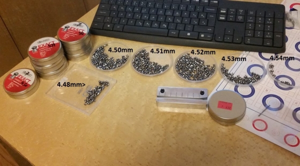

I shoot a .177 Thomas FT rifle. I bought a pellet gauge and sorted a tin of 13.4 gr JSB Monsters which I shoot about 820 FPS for 20 FPE
The majority of my pellets were in the 4.54 head size with 4.53 and 4.55 being on the outer fringes for a .01 mm plus or minus for the 400 count tin which I thought was pretty tight tolerence.

I bought the 4.52mm and a 4.53 mm TBT head sizers like you recommended
I tried the 4.52 sizer first .
Here's the 5 shot group left target sized and the 5 shots right unsized
Looks like the 4.53 unsized group shot better than the 4.52 sized group? 1/4" grid paper
Weather was crappy and I was pressed for time before dark.
So the next I decided to use the 4.53 pellet sizer and was pleasantly surprised. The 4.53 sized group was considerably better than the 4.54 unsized group
Circles are 1/4" for comparison
I just haven't had time to do much more shooting and testing but this is really interesting to me and I agree there is something to it? I just ordered a pellet seater tonight and will also be testing to see if there are any benefits to that as well?

Beside sizing your pellets Try weighing them also You will be surprised at the number of OUTLIERS in a TIN
Don't buy a CHEAP SCALE if you decide to do this. I have four cheap ones and finally bought the DIGITAL one from Franklin Arsenal that you can get at Midway.

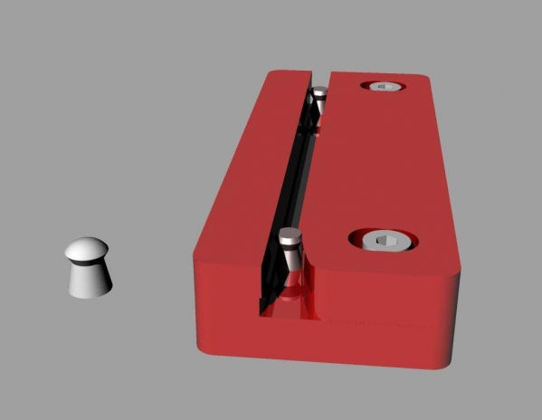

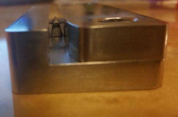

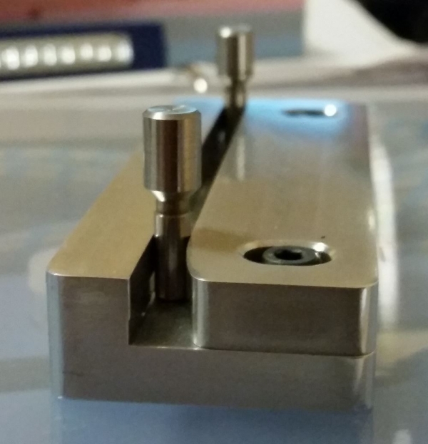

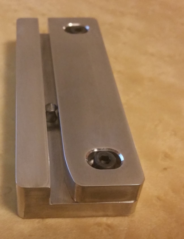

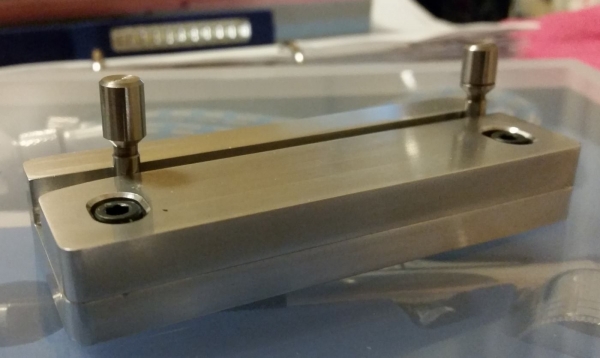

Dont know from the pictures messed up by PhotoBollox if you covered this, but here goes...
Some Generation 1 Sizer & videos - https://www.pimpmyairgun.com/viewtopic.php?f=167&t=1933
Reactions: CampFussell

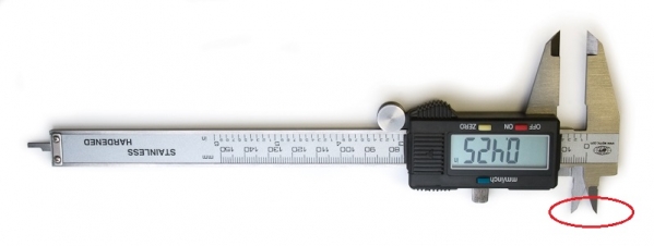

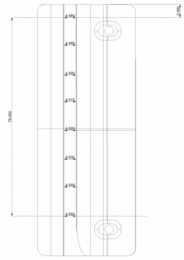

How to mark increments ?
...tighten far end...then use a caliper to make your pencil marks with the caliper...and then finally bolt down hard...and verify measurements are correct for pencil marks...
Looks like this is going to be made by plenty of machinists...
NB: Has added benefit when not using this Pellet Sizer...Its a paper weight on your desk ;-)
