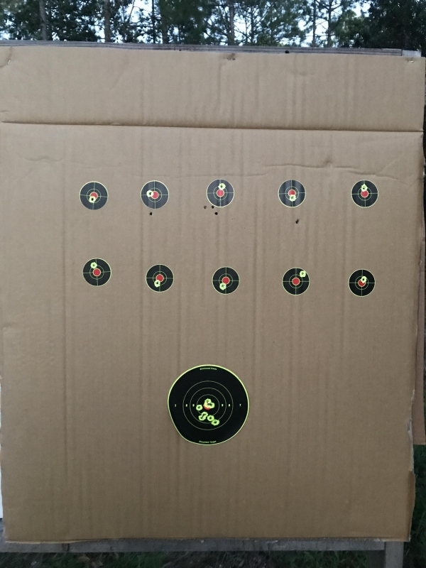

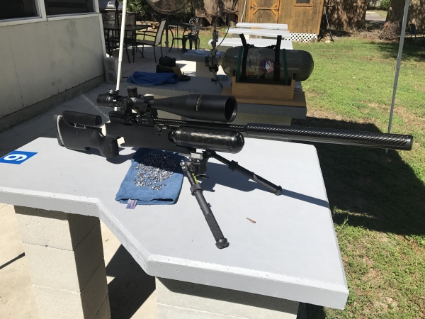

yup its worth it, question is... what routine works for you? All shots @ 100 yards, wind 3-6 mph switching. I'll admit i had some shots with bad wind reading.
2" splatterburst
1" splatterburst ( shot sorted at mostly the 1")
.25 cal RAW, 34.4 gr

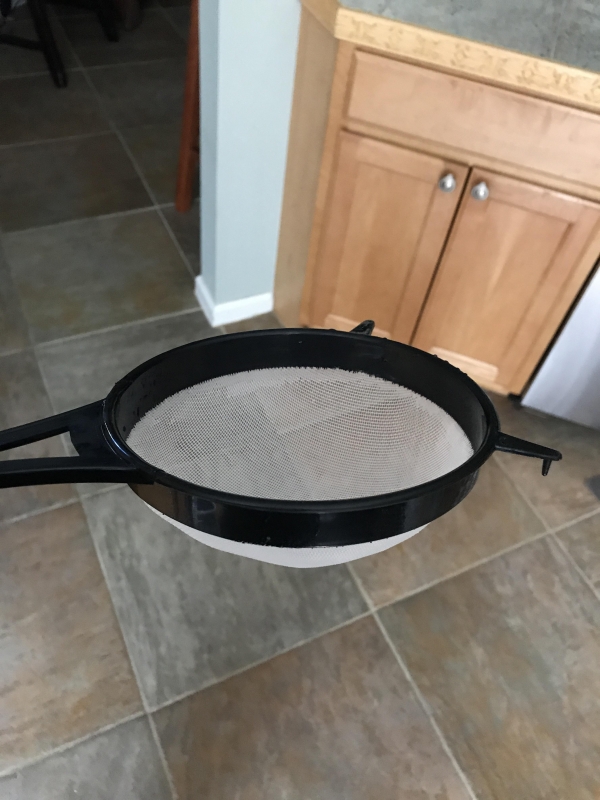

Yes gentle! Especially the .177's, i use a plastic strainer and my finger to slush them around. Then rinse with hot water. Lay them out on a micro fiber in the sun. Also is you have hard water, the lil dishwasher jet dry works for keeping water spots drying on the kids.
my house water is softened and filtered so im good with air dry in sun.
The kids sunning to dryness!!
