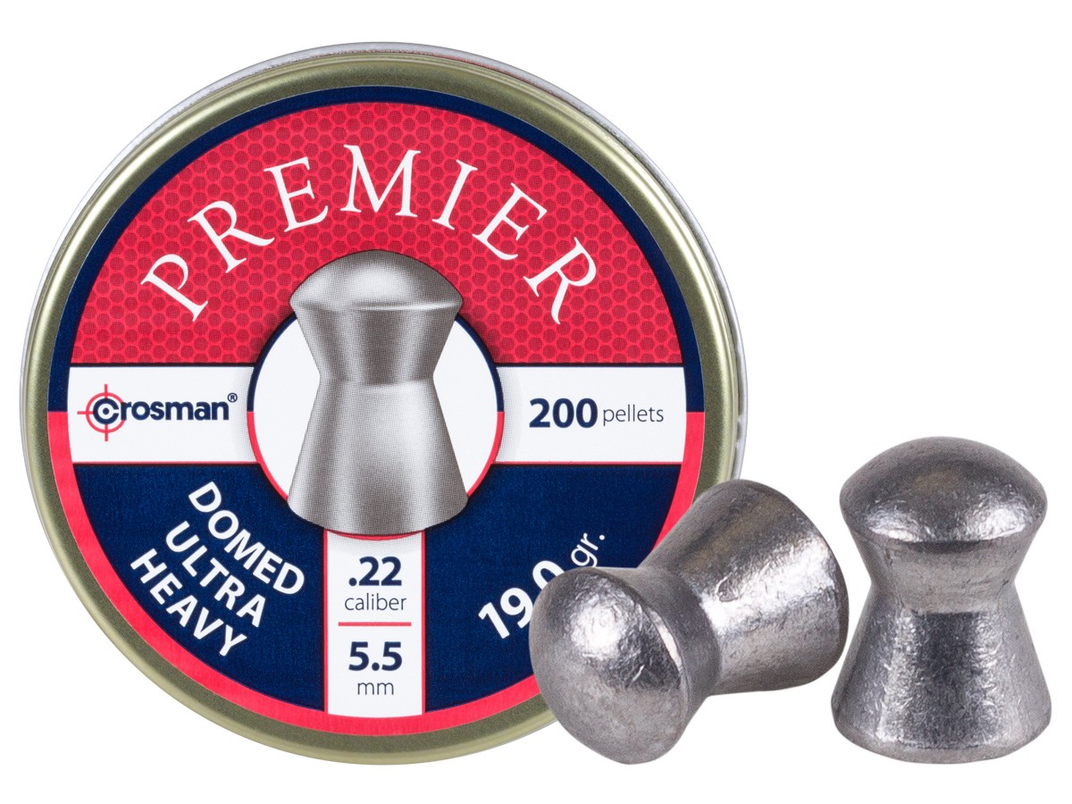

It sounds to me as if the pellet in question has a steeper drag rise than the GA profile, which would seem correct looking at the pellet pictures shown in the thread. It is possible that the wadcutter drag profile may fit it better, though that one might be too steep a drag rise.
A purpose drag law could be created from the BC values at the different ranges by getting the form factors and thus the drag coefficient but, it is a fairly long-drawn-out process and needs a bit of imagination as to what is likely or unlikely. There is also the danger that the calculated values are based on measured drop which is the least accurate method, the reason being that there are a number of other things which can effect drop. The most accurate method with one chrono is by measuring MV and time of flight, possibly with one microphone and a laptop, though it would be difficult at the long ranges. Even with the time of flight and the MV, it may still be difficult if the reference drag laws are not the correct shape.
The Rifle Premium Round weigh 18.67gr. They state a 0.025BC.
Comparing your actual photo of the Rifle Round with the following... — might that be the same pellet — rebranded?
The Crosman Domed Ultra Heavy weigh 19.00gr.
The BCs that were measured by different shooters were mostly disappointingly low for such a heavy pellet:
▪ 0.017BC | MV 898fps | Range 30y
(by HAM)
▪ 0.021BC | MV 860fps | Range 5–83y
▪ 0.031BC | MV 750fps to 650fps | Range 25y
(Note: All these were calculated using ChairGun and GA.)
This pellet seems to behave more like a wadcutter than a dome....: The higher the velocity, the higher the drag (or, the lower the "apparent BC").
Maybe that's why you see such a weird trajectory — the GA standard projectile does not work for this shape at higher velocities.... 🤔
Matthias
