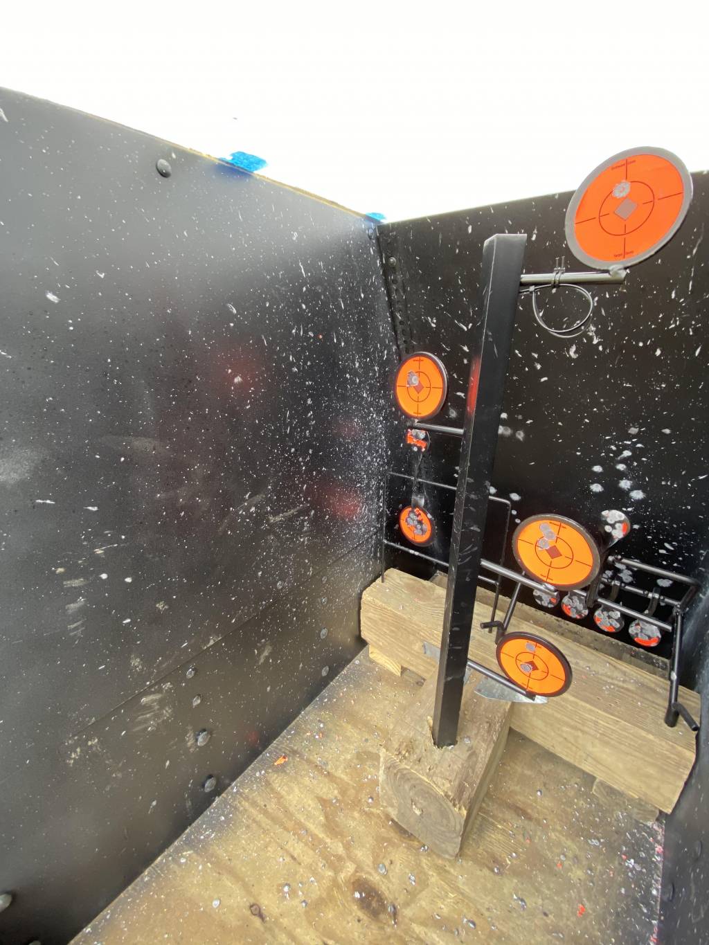

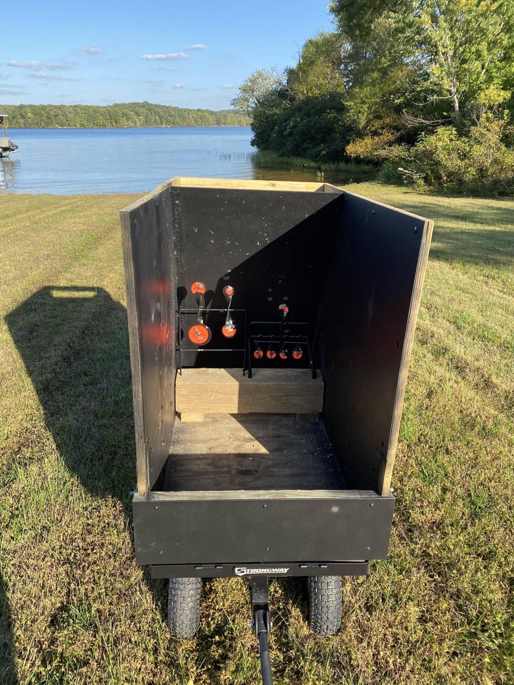

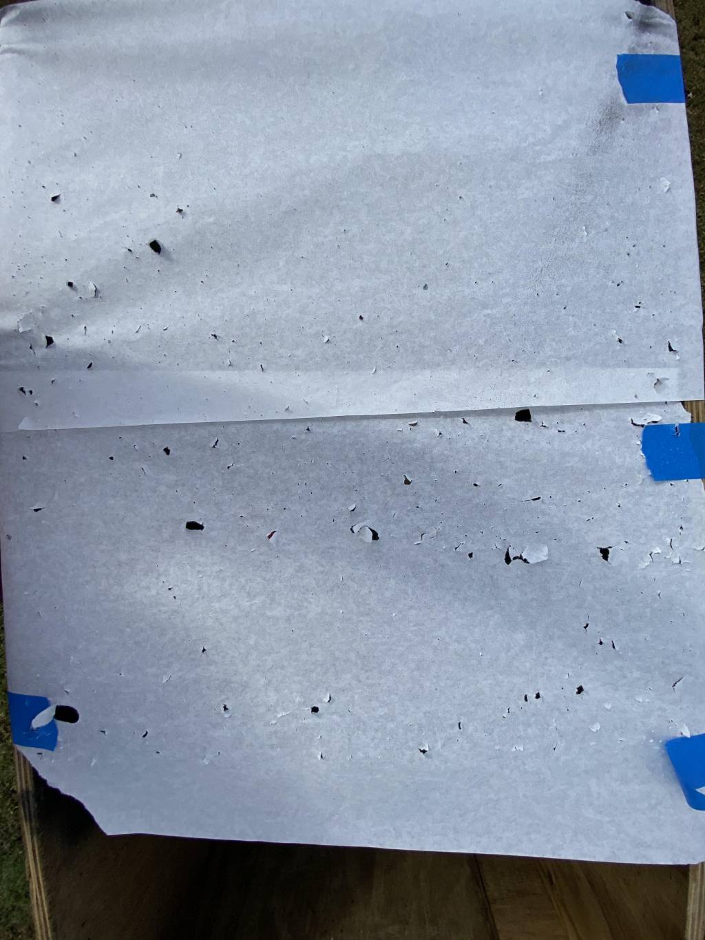

I made this box on a wagon frame to control the splatter. It has a cover on it now after I put paper across the top to see if anything was going that way; it was.
Man you read my mind was thinking of the same thing minus the wagon, but I love it even more. Since the general consensus is yes lots of ricochets going to do this to be safe with my metal targets.
