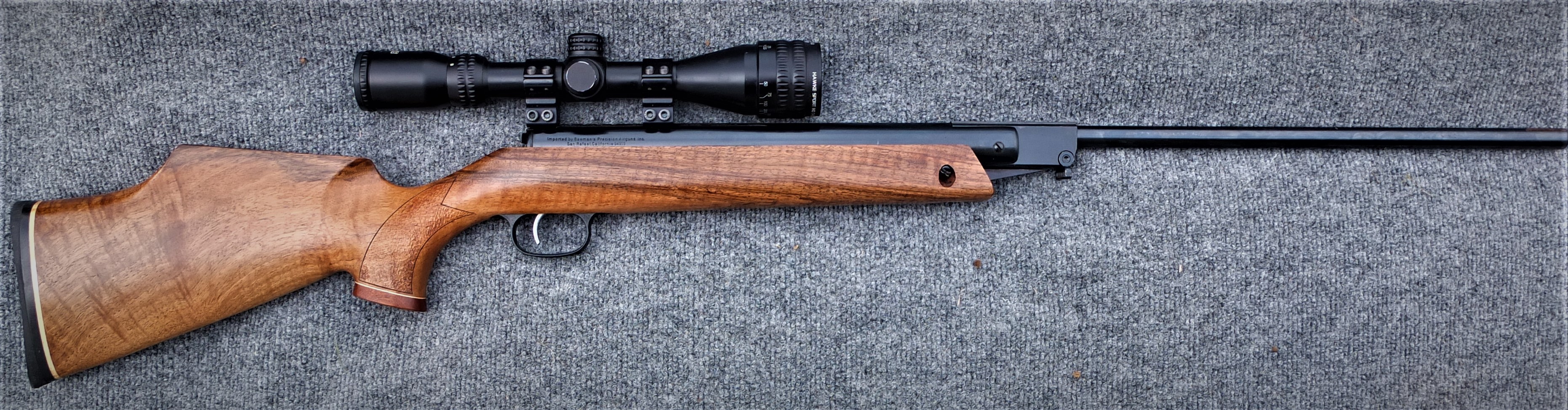

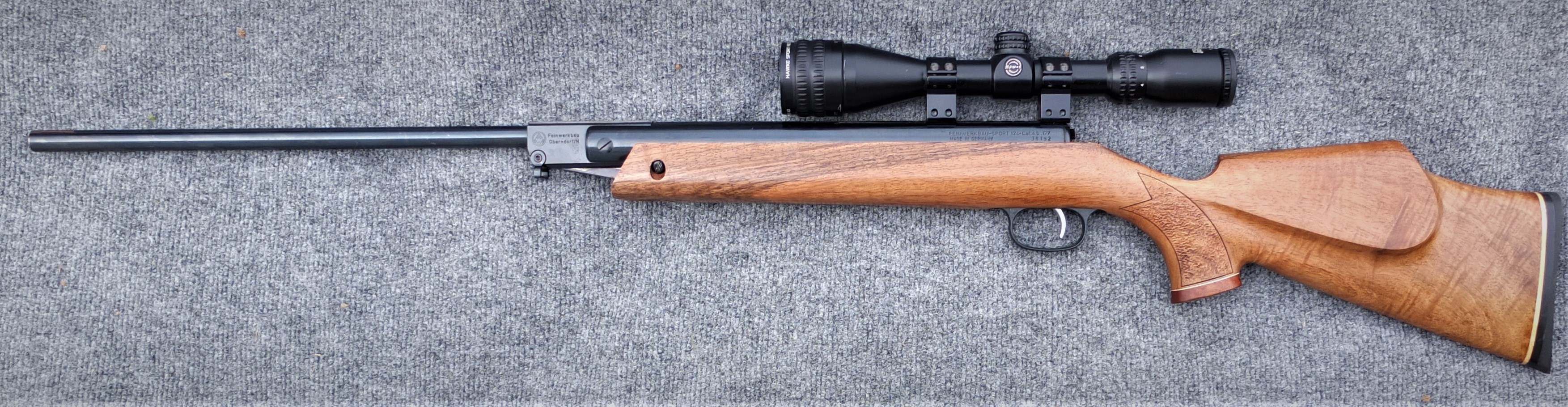

I just put a 124 barrel on my HW100, which of course is a PCP.
That said, and taking the "springer-ness" variable out of it, it's really not pellet picky that I can tell.
It shoots all weights of JSBs very well, and Crosman Premier Lites almost as well.
The 8.4gr JSBs are what I've settled on because thats the weight I prefer for my power settings.

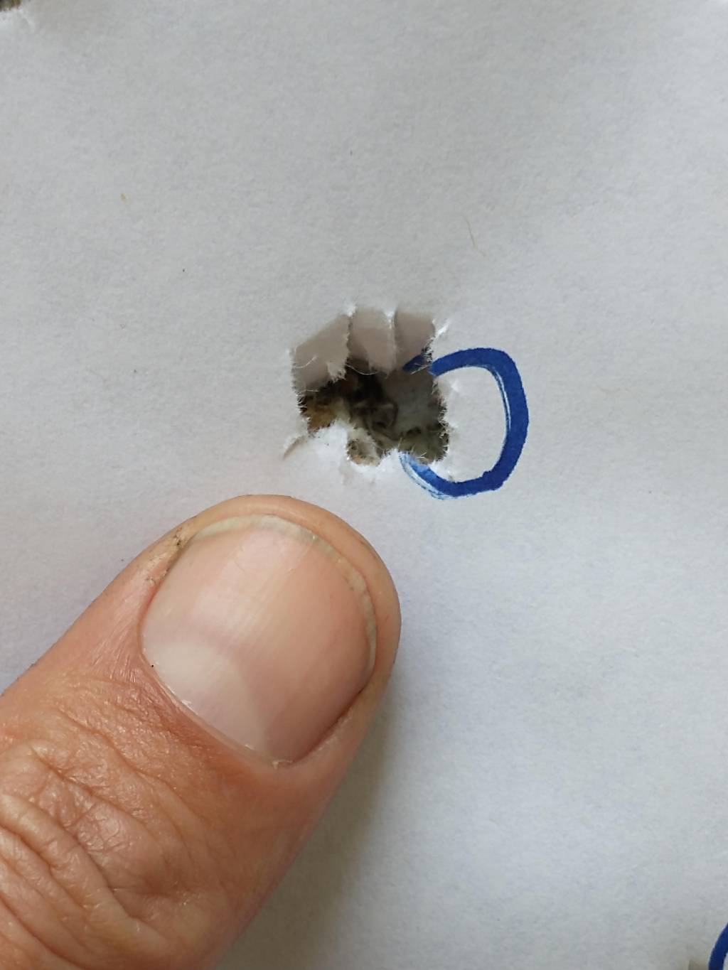

Here's 14 shots, a full mag:
