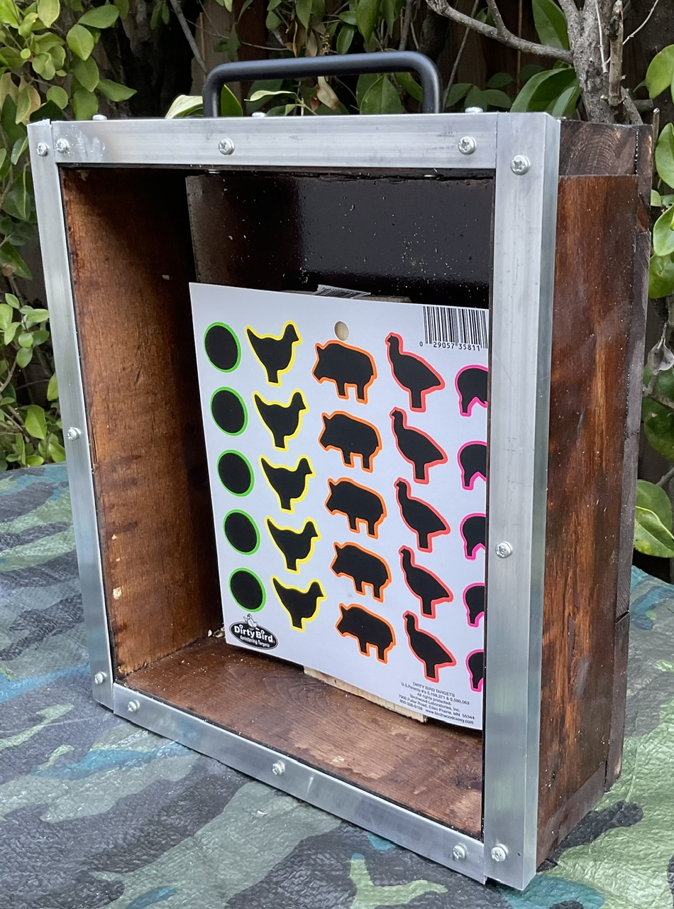

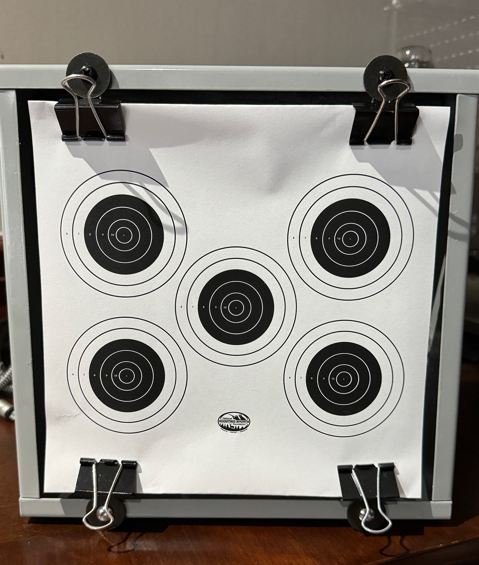

I have many boxes over the years.
I try to have a removal back to make getting the used duct seal and pellets out.
My latest was made from a single 1”x4“x8’ board.
Cut into 8, 1’ pieces.
Four for the sides and four for the back.
Some duct seal and some aluminum strips and a carry handle:
I have the face covered with heavy cardboard

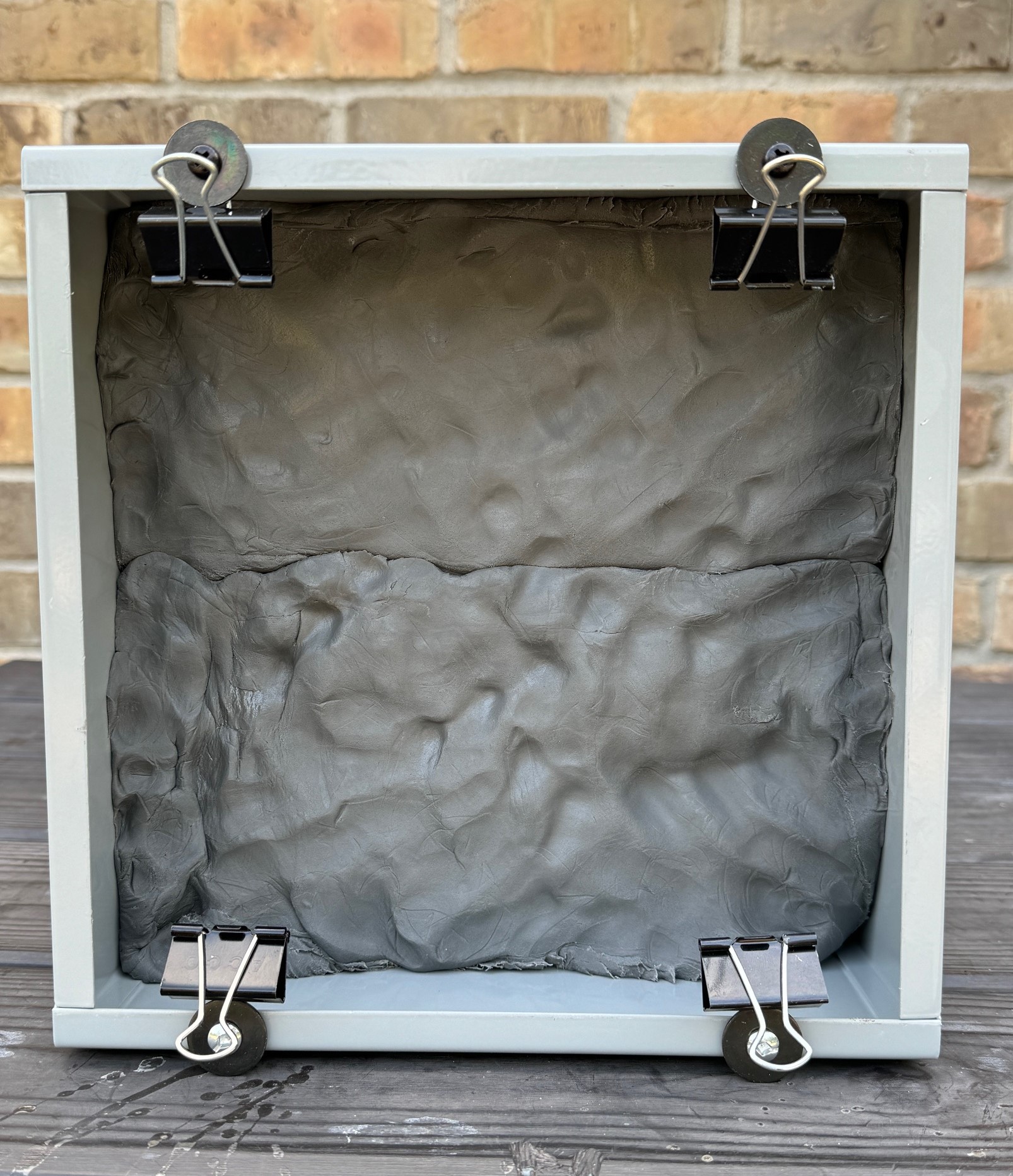

I just got some cheap 8x8 or so baking pans at goodwill and filled them full of plumbers putty. I found a 25lb tub on amazon a while ago but I just looked and couldnt find it again.
Plumbers putty is strong, nothing out the back. I just put my 8x8 shootnsee sticky targets directly on the putty....stays out in the rain and cold under a couple trees....no issues
