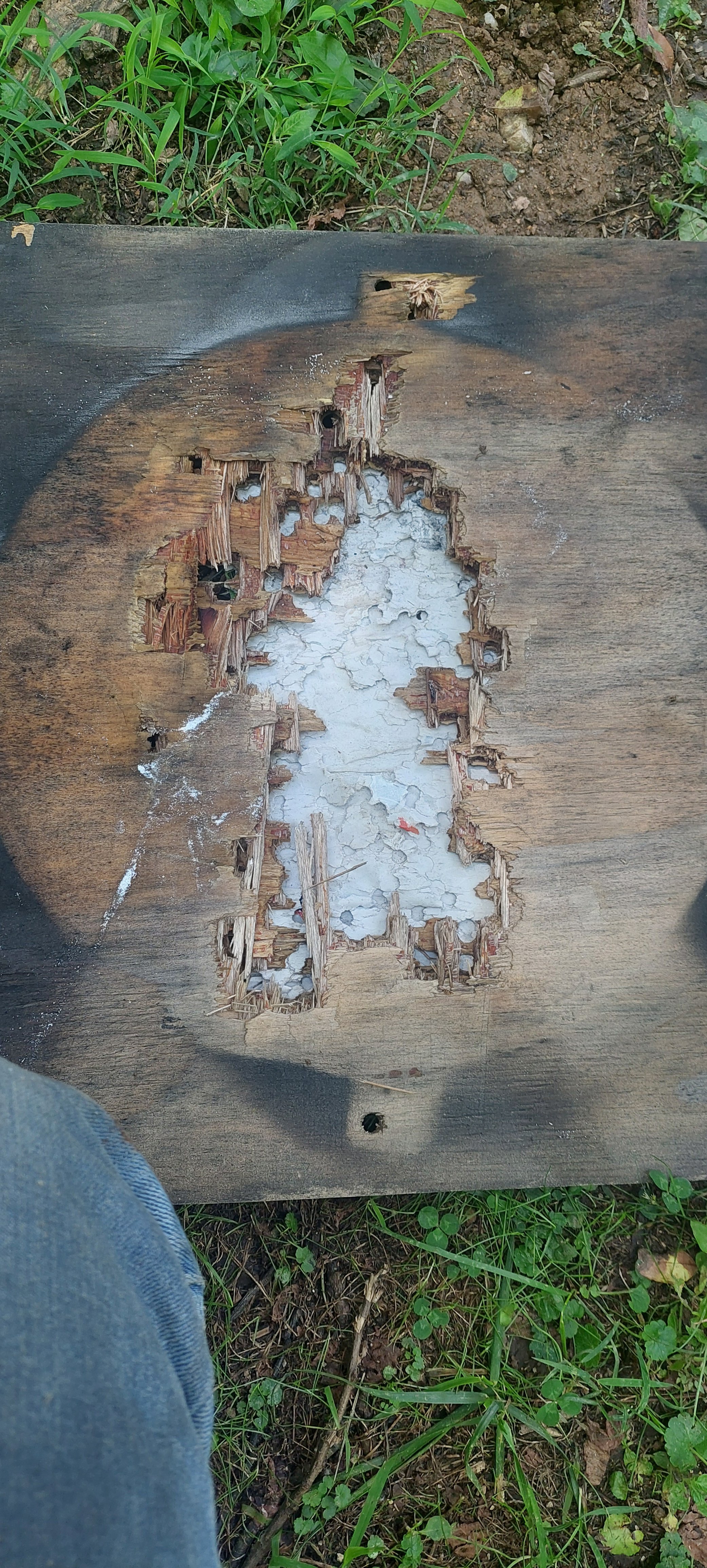

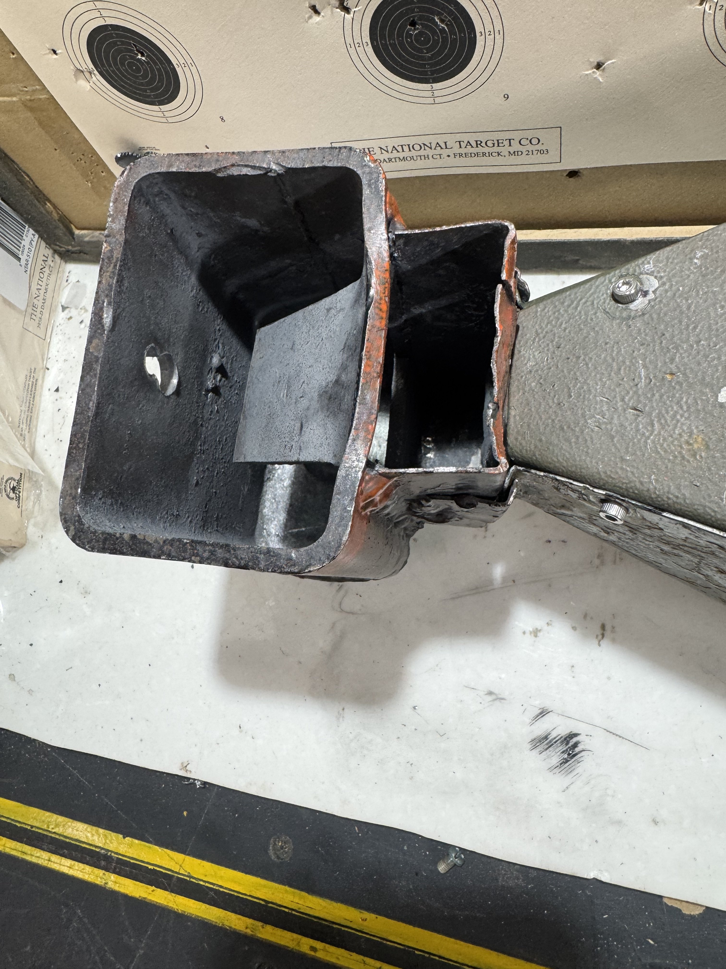

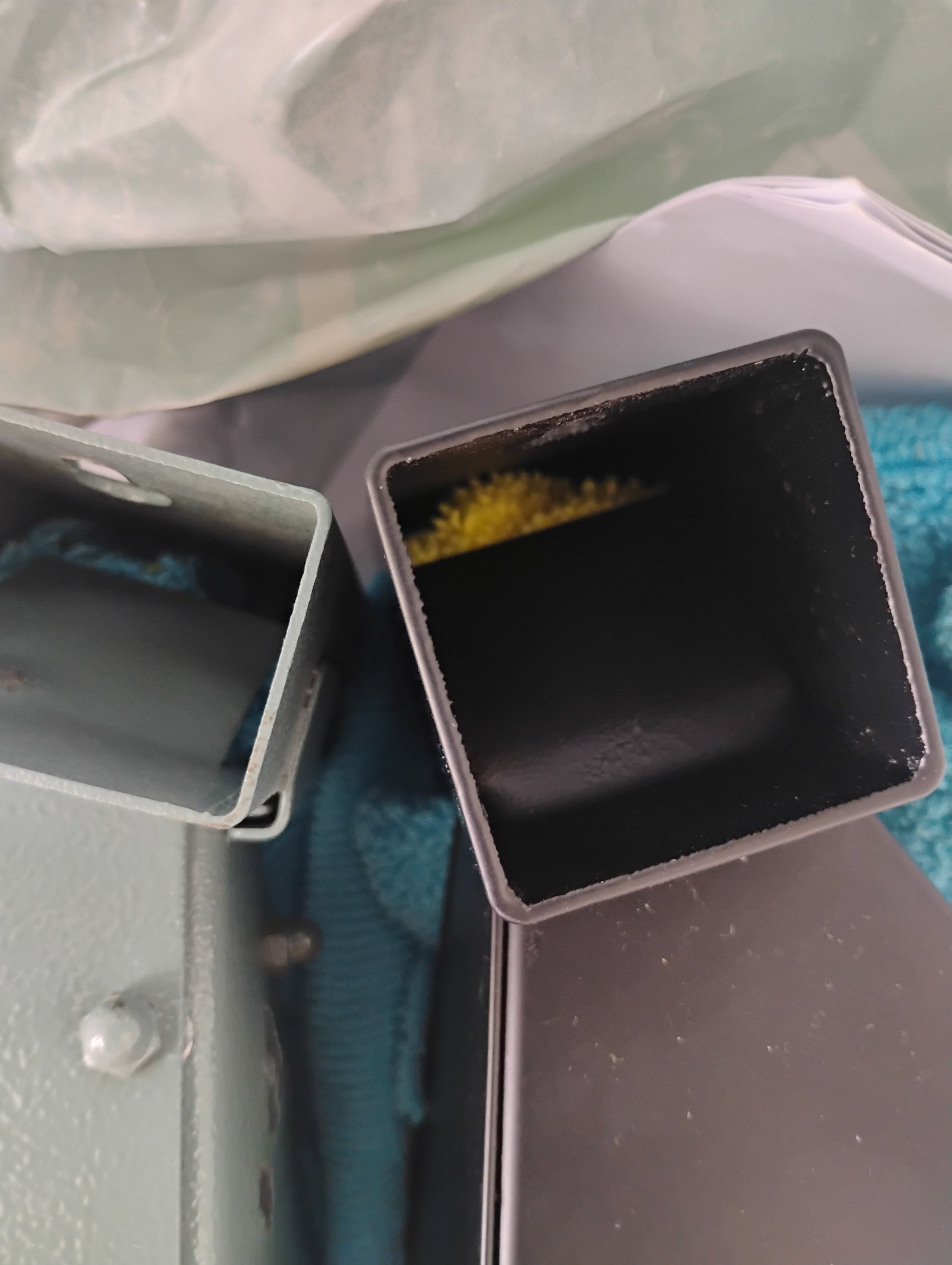

I use the 5x5 targets on the funnel shaped pellet trap. It’s a nice 20 dollar trap and the target packs are cheep and I can make targets to slide in. But when you start to shoot 200,300 pellets a day the trap takes a beating.
I found a piece of 1/4 inch 4x6 steel box. About six inches. I’m guessing you could get one at a steel yard as scrap end cut. I cut a U shape in the face and hammered the bottom in so it made a 45 deg angle.
Then I welded the little edges that hold the trap funnel to the part that catches the pellets.
Now I can shoot this thing all day and it does not eat through the deflector. It’s 1/4 inch steel. And the funnel gets beat up but I just hammer it back flat and it’s like new.
I drilled the back for a nail hole to hang it . And welded the bottom closed with a loose nut to allow water to drain. To empty it I dump it in a bucket. That way all the lead is collected.

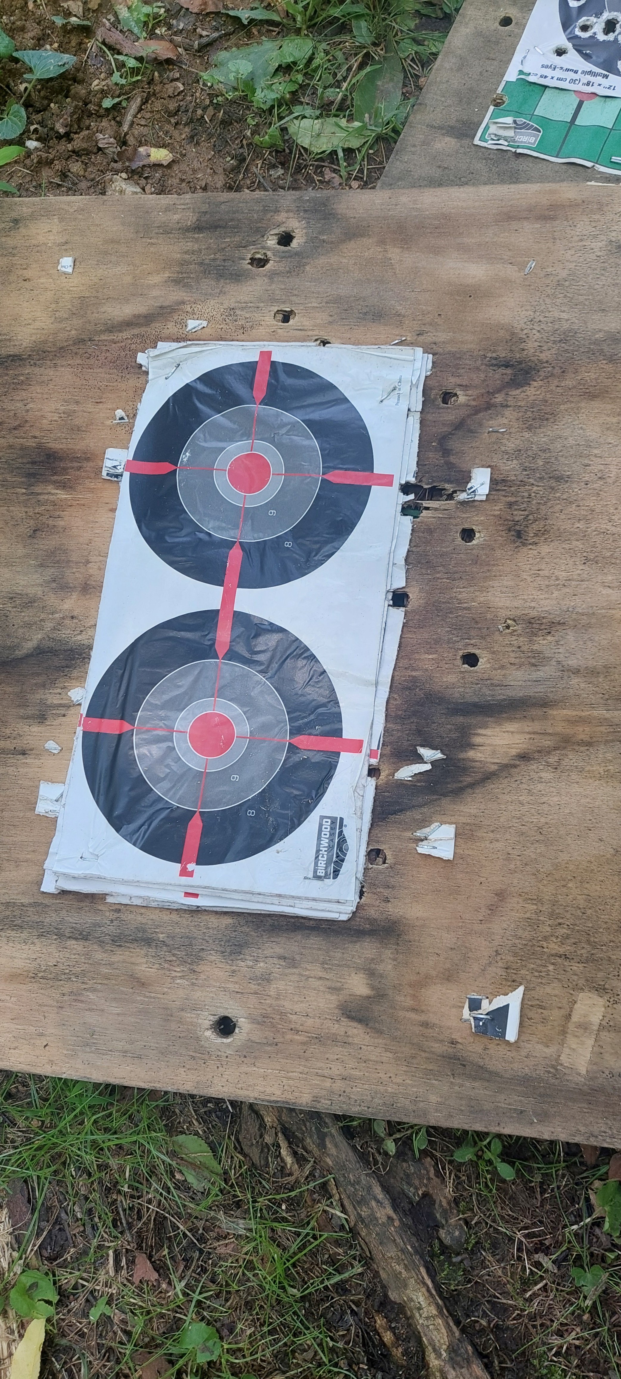

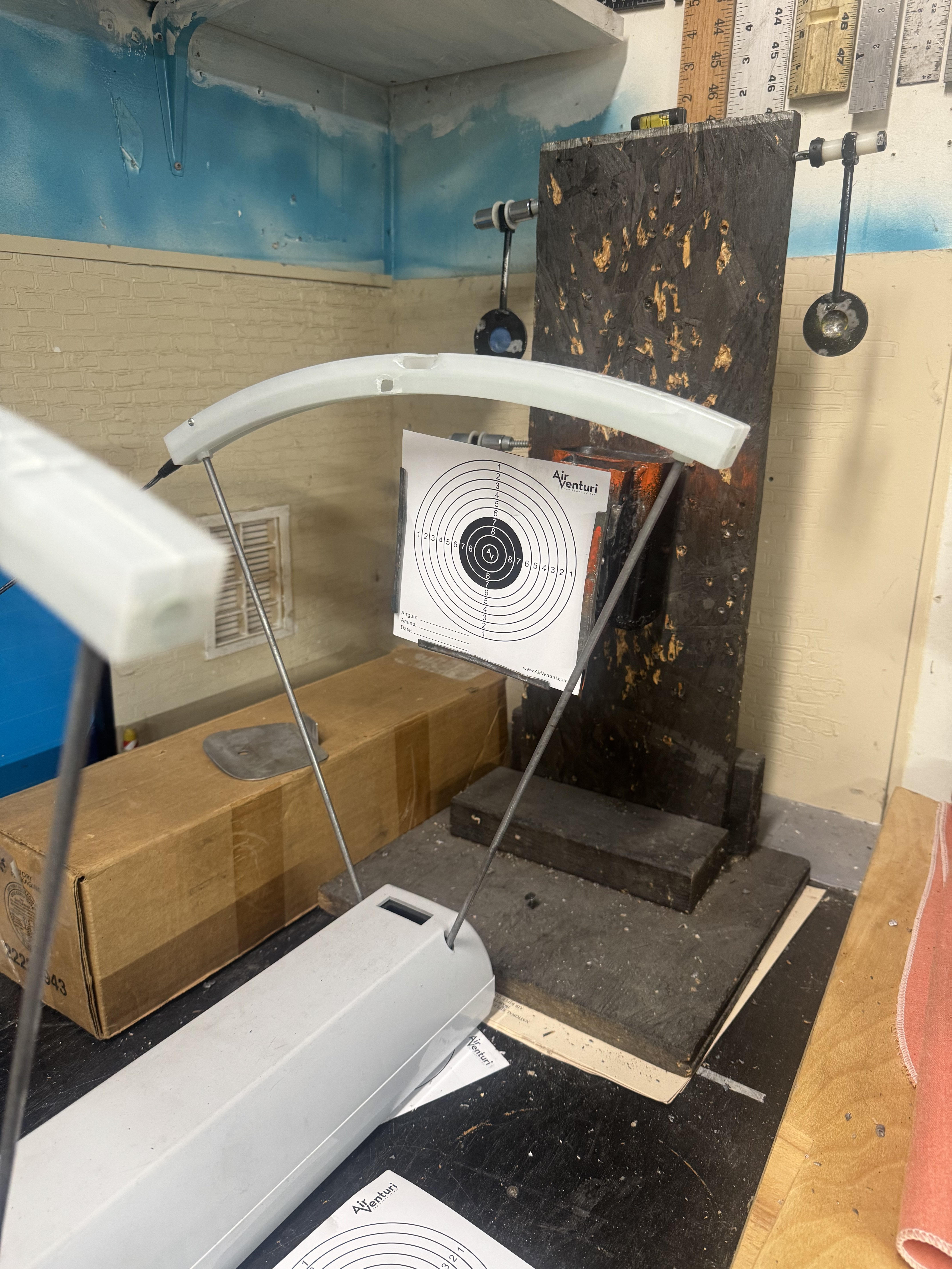

I nailed this to my target board. It is a base with a stand made from wood with what ever spinners I could come up with at ACE.
This whole thing has a handle and I can move it one yard at a time up and down the line for sight in and scope proving. It also has a hole for a wind sock and a clip for holding playing card. Even has a line of holes for wooden matches across the top.

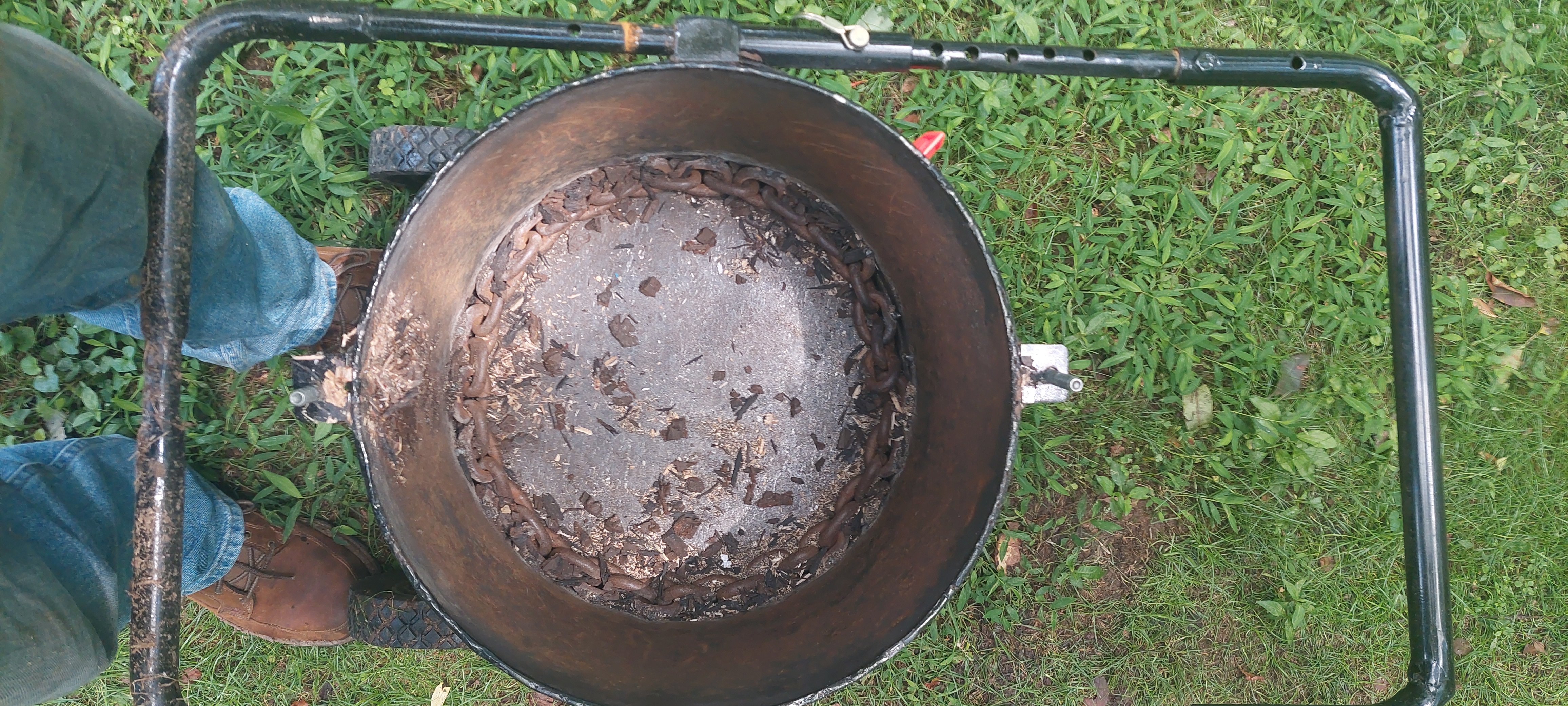

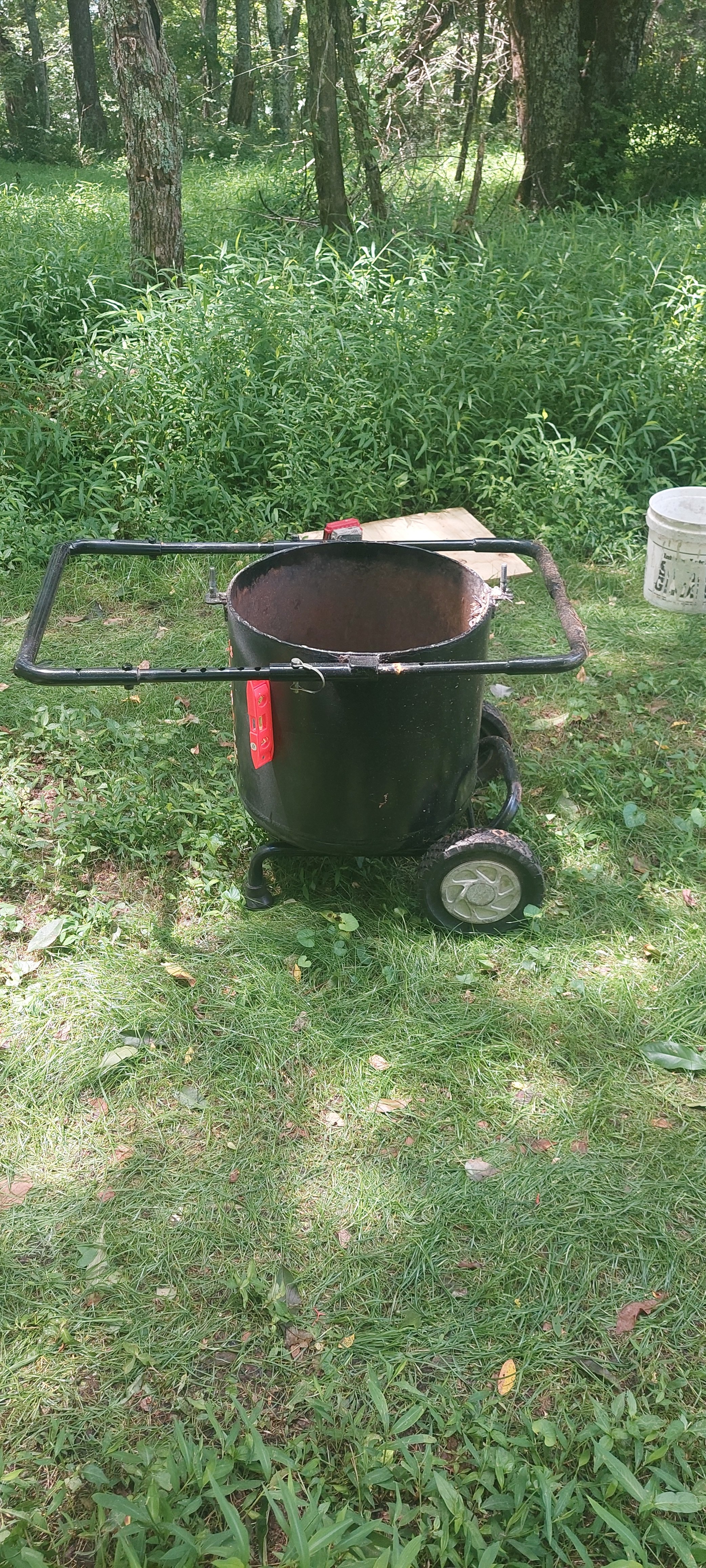

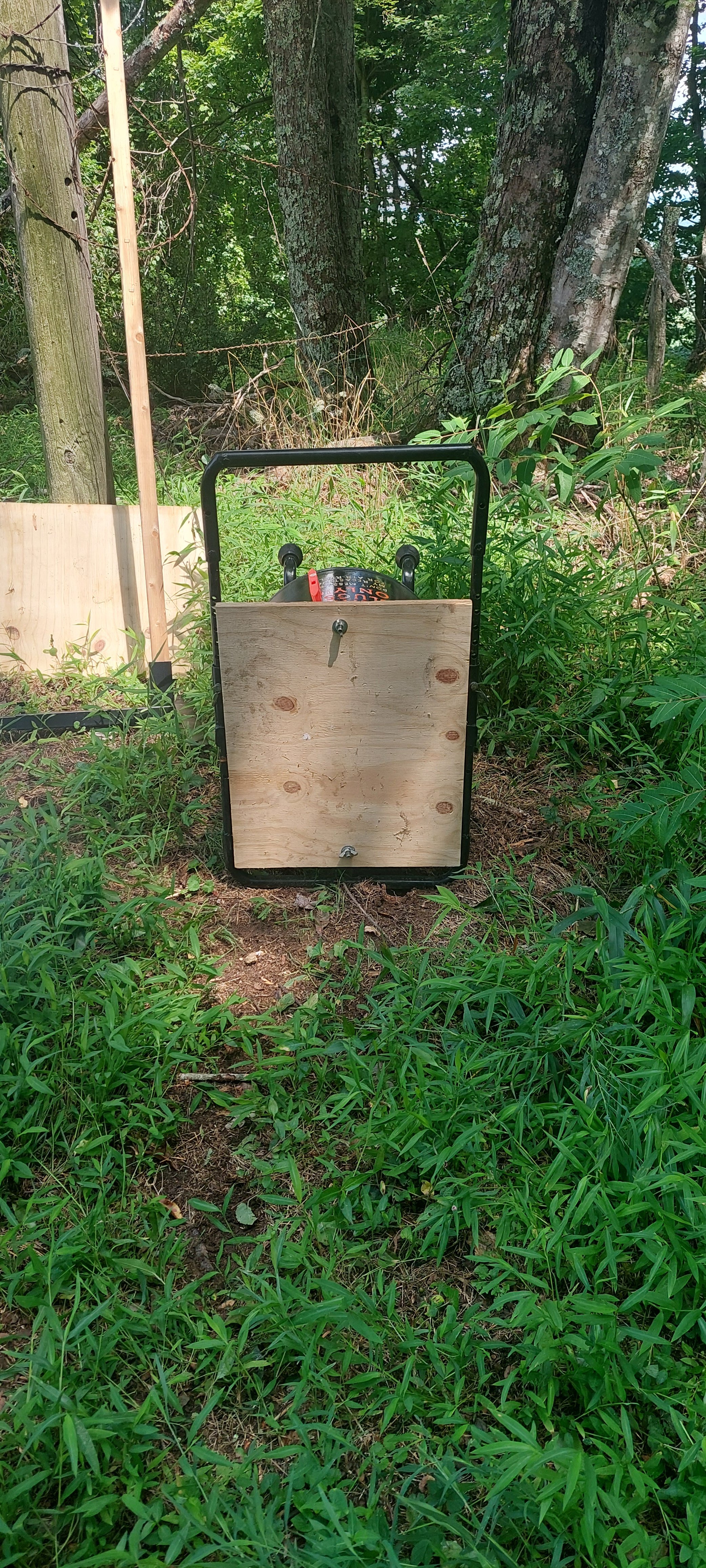

Here my DIY Big Bore Range Lead Trap. This was an old 15 gal compressor tank. Used removed upper portion to double wall thickness. (Chain around edge is because wasn't ordering a custom size.)
Heavy but can roll to any yardage on my private range, handle adjustable for leveling. Just collected 21.5 lbs of my pure lead out of it for recasting.
Filled with rubber mulch(targets actually hold mulch in), 3/8 AR steel is about 11 inches back and haven't hit it, even at 35 yds, with Challenger Elite .457 shooting 300gr slugs at 800fps.
Not sure how much power it can handle but definitely works for me.

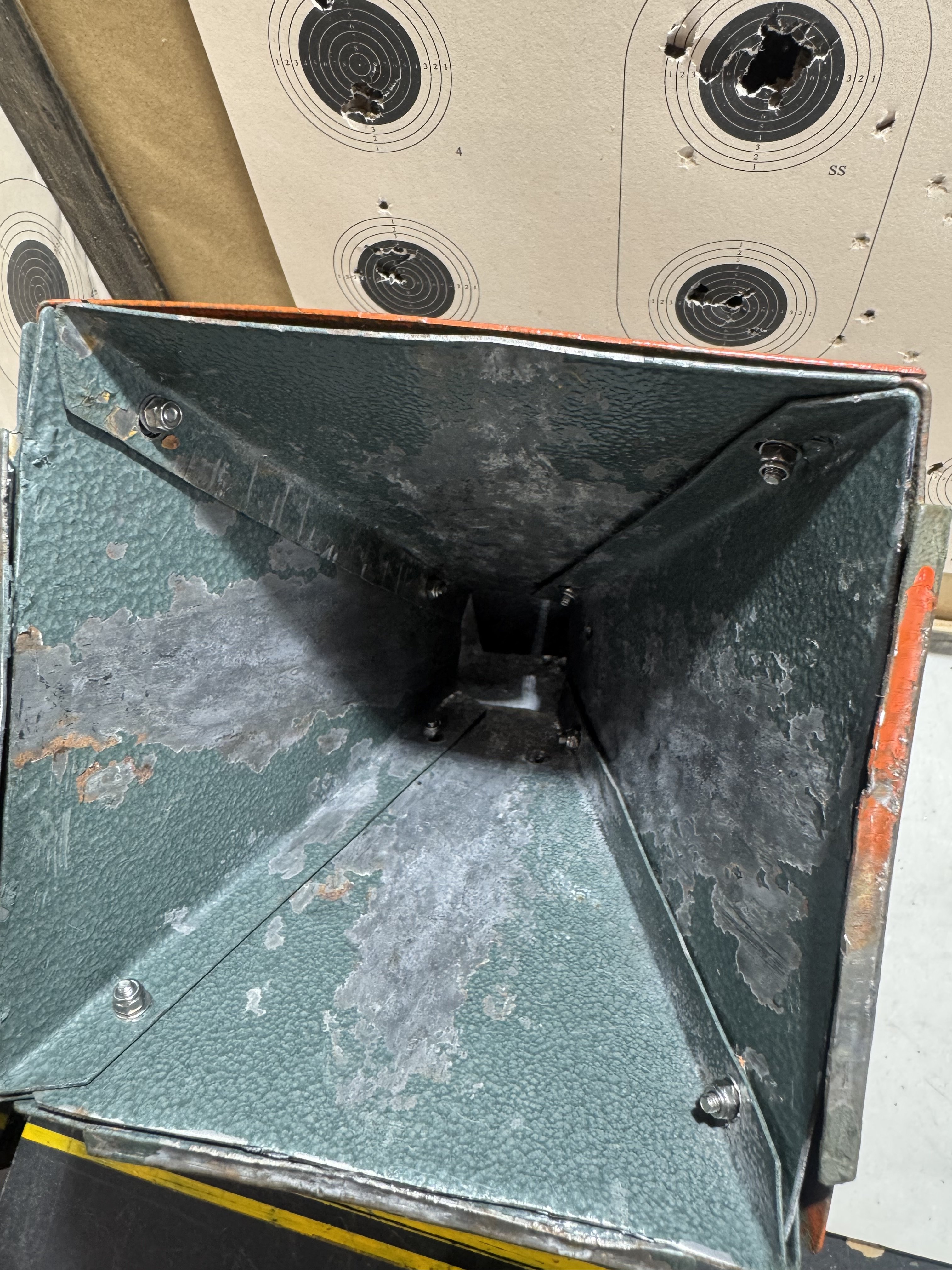

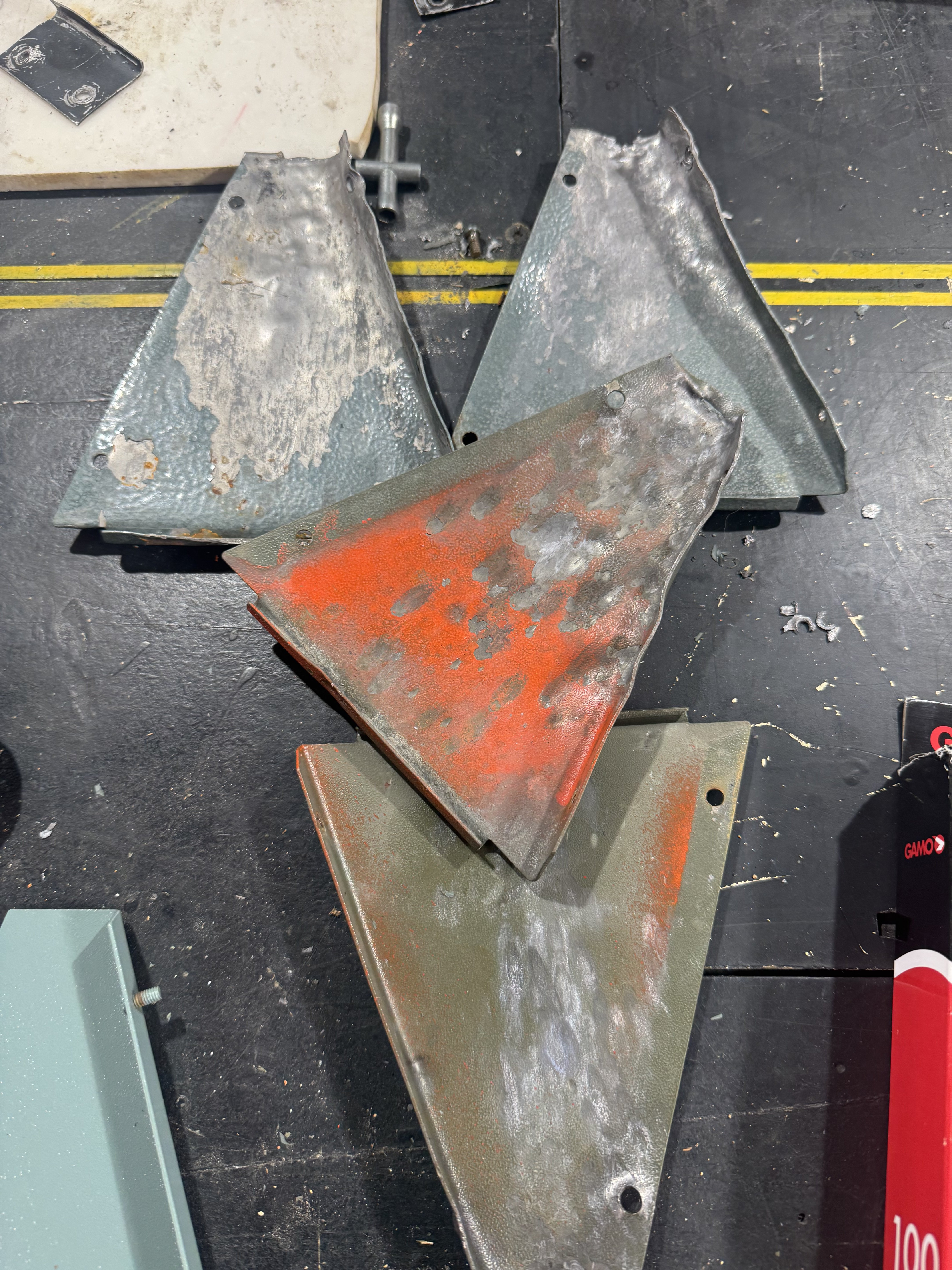

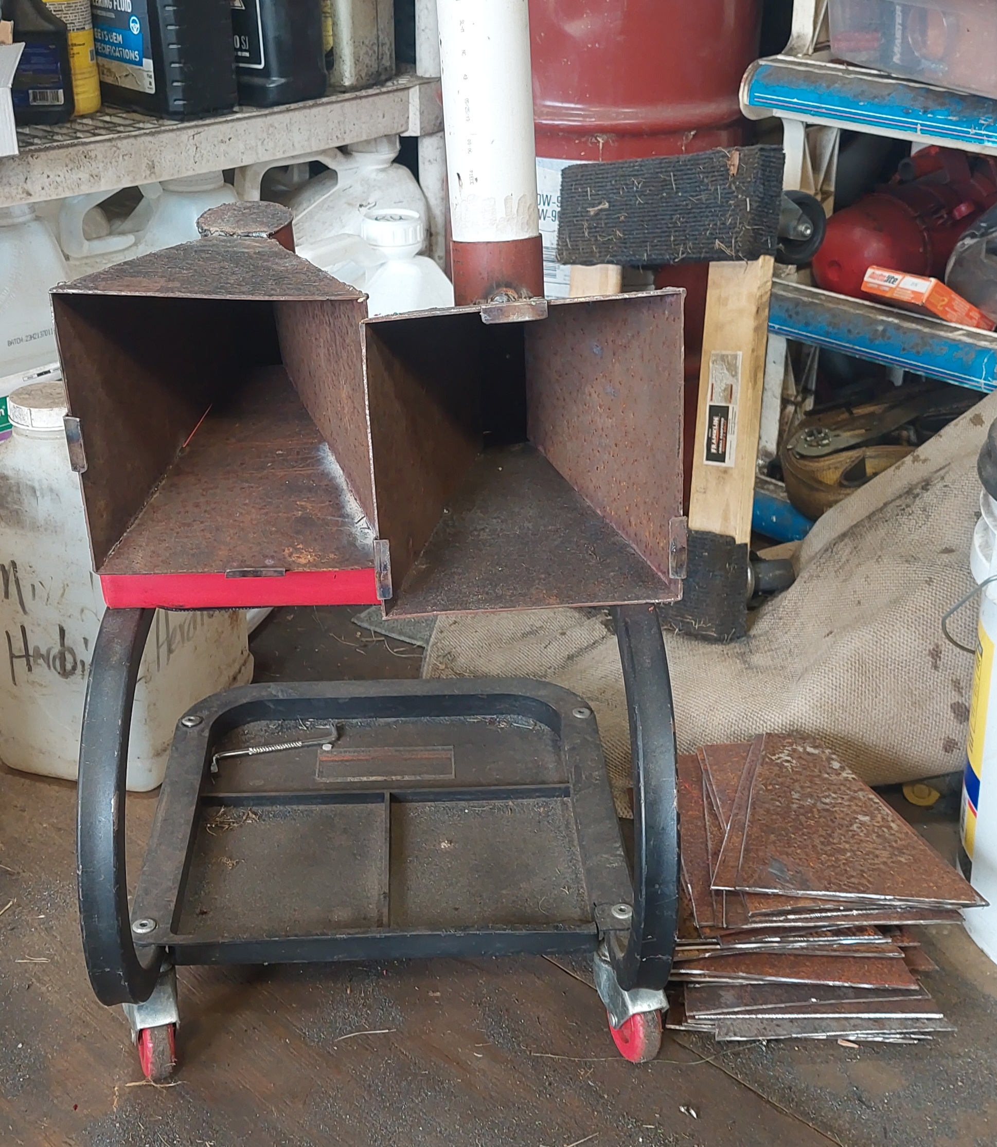

I needed to do some serious maintenance on my pellet trap. So much so I ordered a new one.
I have three cones that are trashed . So I took everything apart. I found I could make one good cone with the lips that hold it to the trap and the paper holder. All assembled then I took the pieces from the left over trap and modified them to act as a doubler. Now my cone has two sheets of steel and the trap is 3/16 box steel.
I have enough left over to line my new cone .

I got the new trap in the mail today.

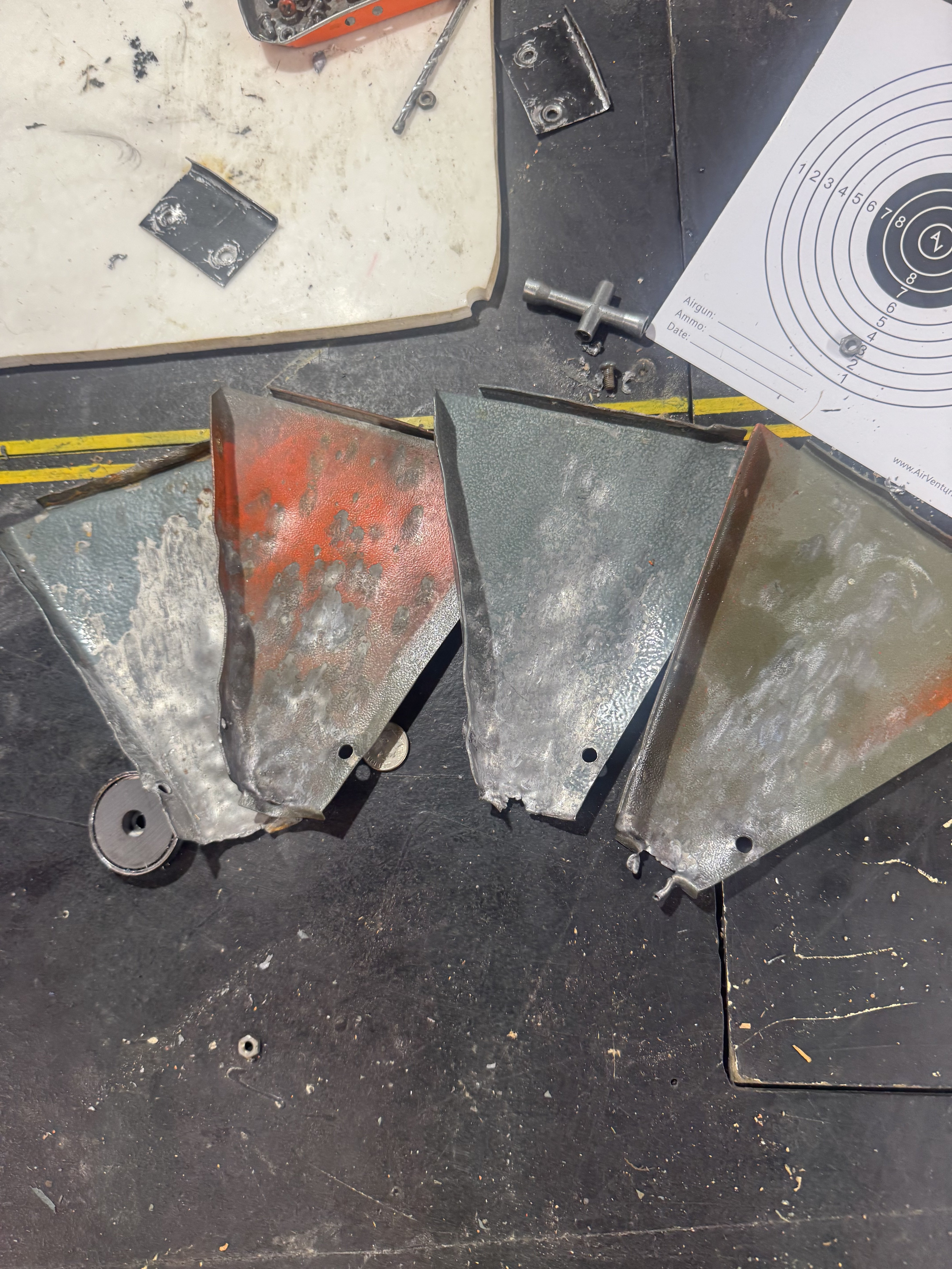

First I removed all the screws.

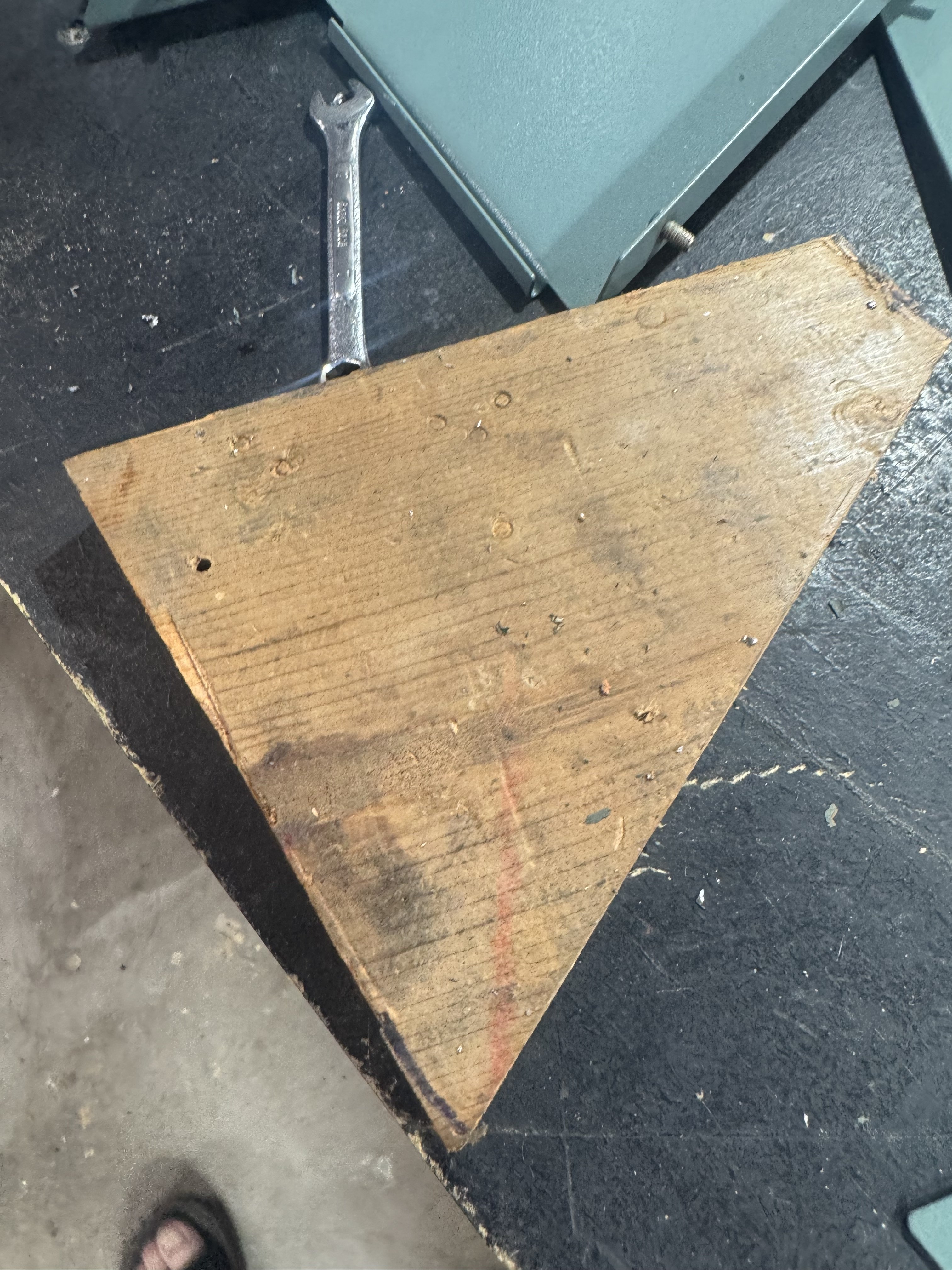

Then using a wood buck I hammered all the old trap plates flat and trimmed them slightly. Front and back just a little.

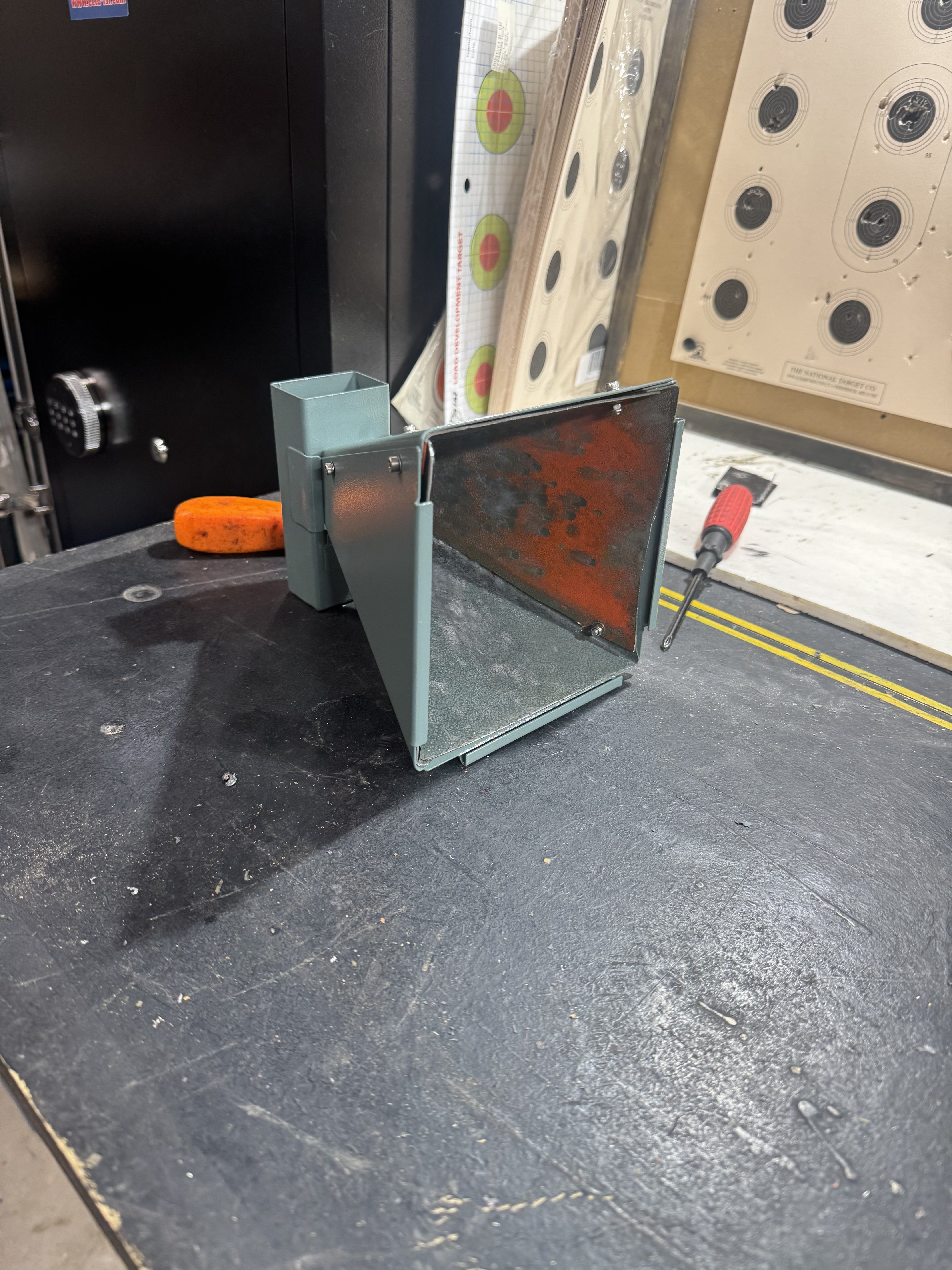

Next I assemble the new trap with the old trap inside. This required longer bolts and nylon lock nuts.
You will need to trim the flat edge and drill new holes to make it all a little smaller. But it is pretty obvious.
That’s it.
Rather than one new flimsy trap and three traps I throw away. I now have two traps that will probably last forever.
