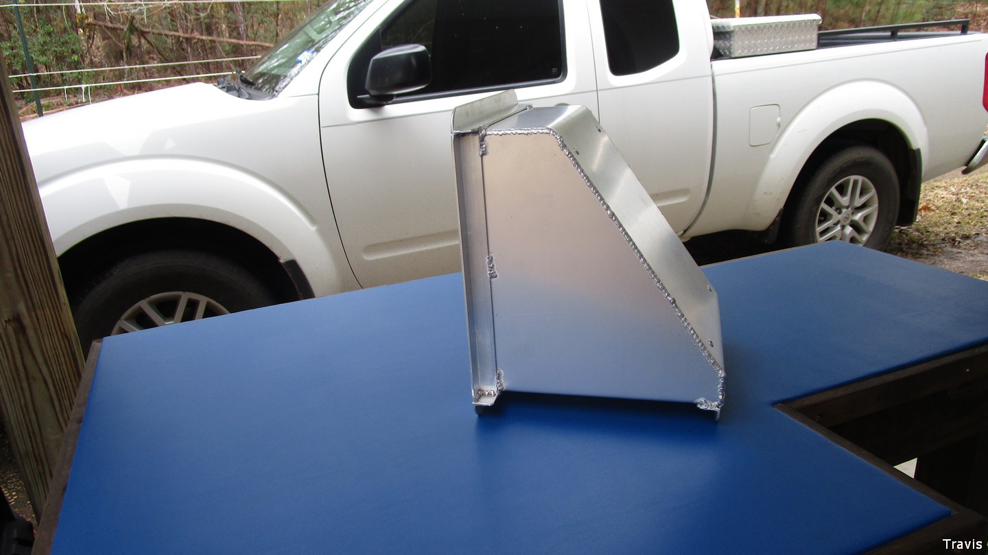

Just looking at some pictures it looks like thin sheet metal . Unless the backstop part is a lot thicker I don't see it lasting .
Maybe if you only shoot sub400fps stuff ... Maybe
Or if you do have it and the back stop gets swiss cheesed have a metal shop /votec/?? That can cut you a bolt in piece of 3/16min plate. Or just donate to a school metal shop and have one build with 3/16" steel and probably last a lifetime vs that sheet metal one
Just seems a lot of them traps like your looking at is basically red Ryder grade ( opinion)

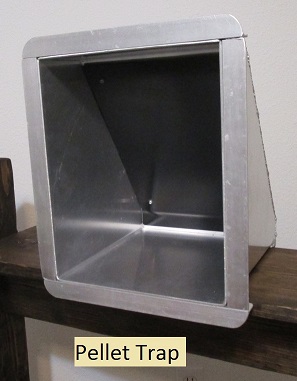

I use this one. Not sure if it meets your needs.

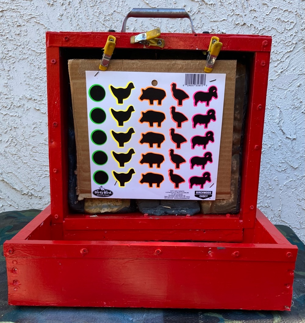

Just build one.
one piece of 1”x4”x8”’ lumber.
8 pieces 12” long.
four for the sides, four for the back.
put some duct seal (It looks like C4 explosive in the electrical section of hardware store).
about 10 pounds of it.
put a bull clip or two on the top to hold your target.

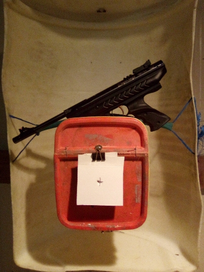

I added a lower box to catch the occasional fall out:

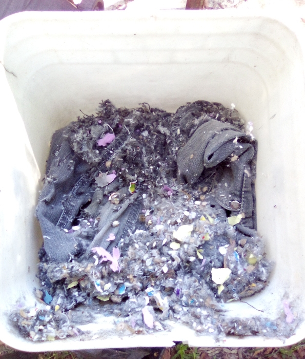

Maybe I should have added that I make my paper shooting back stops using shipping boxes filled with old blue jeans and it works very well.

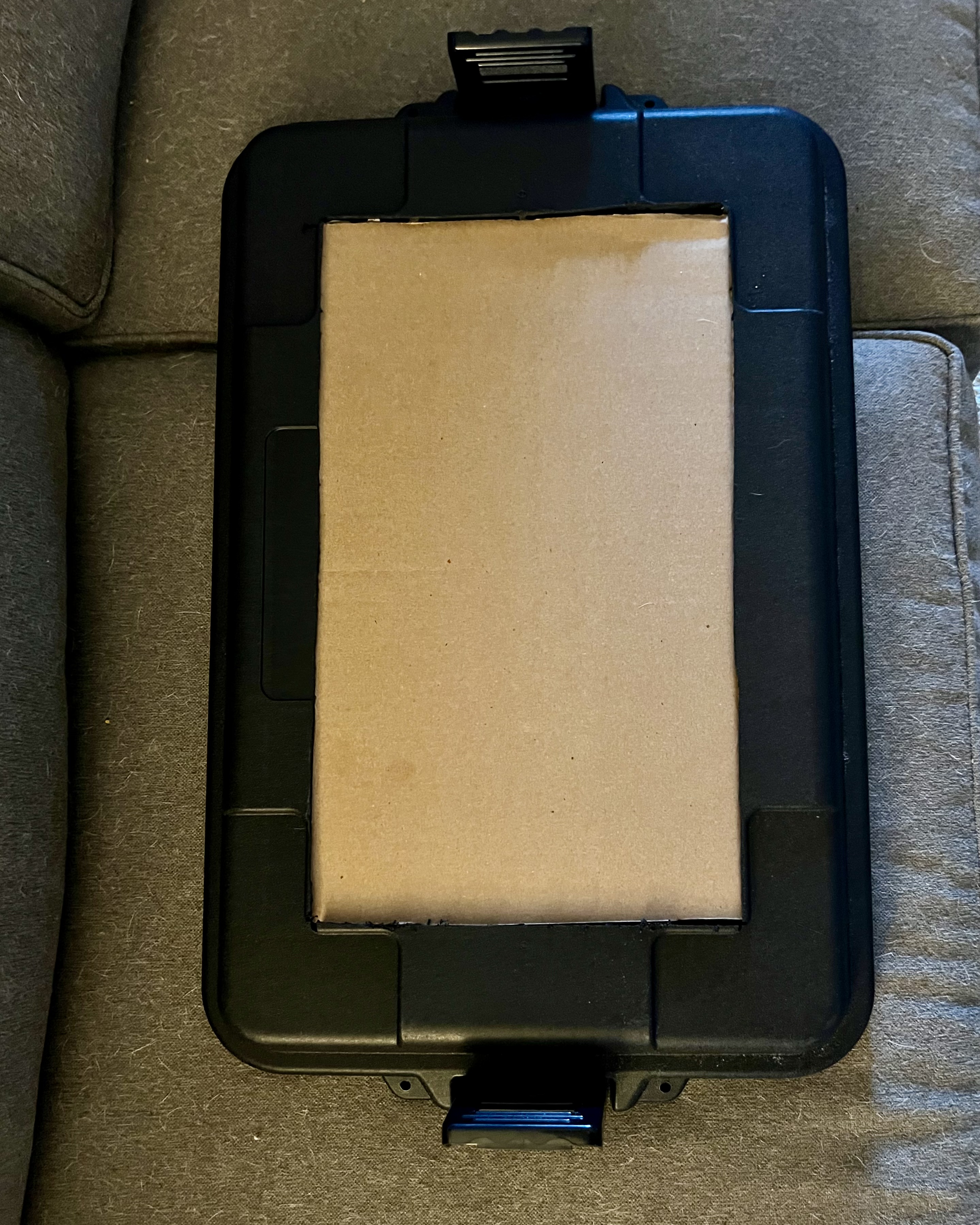

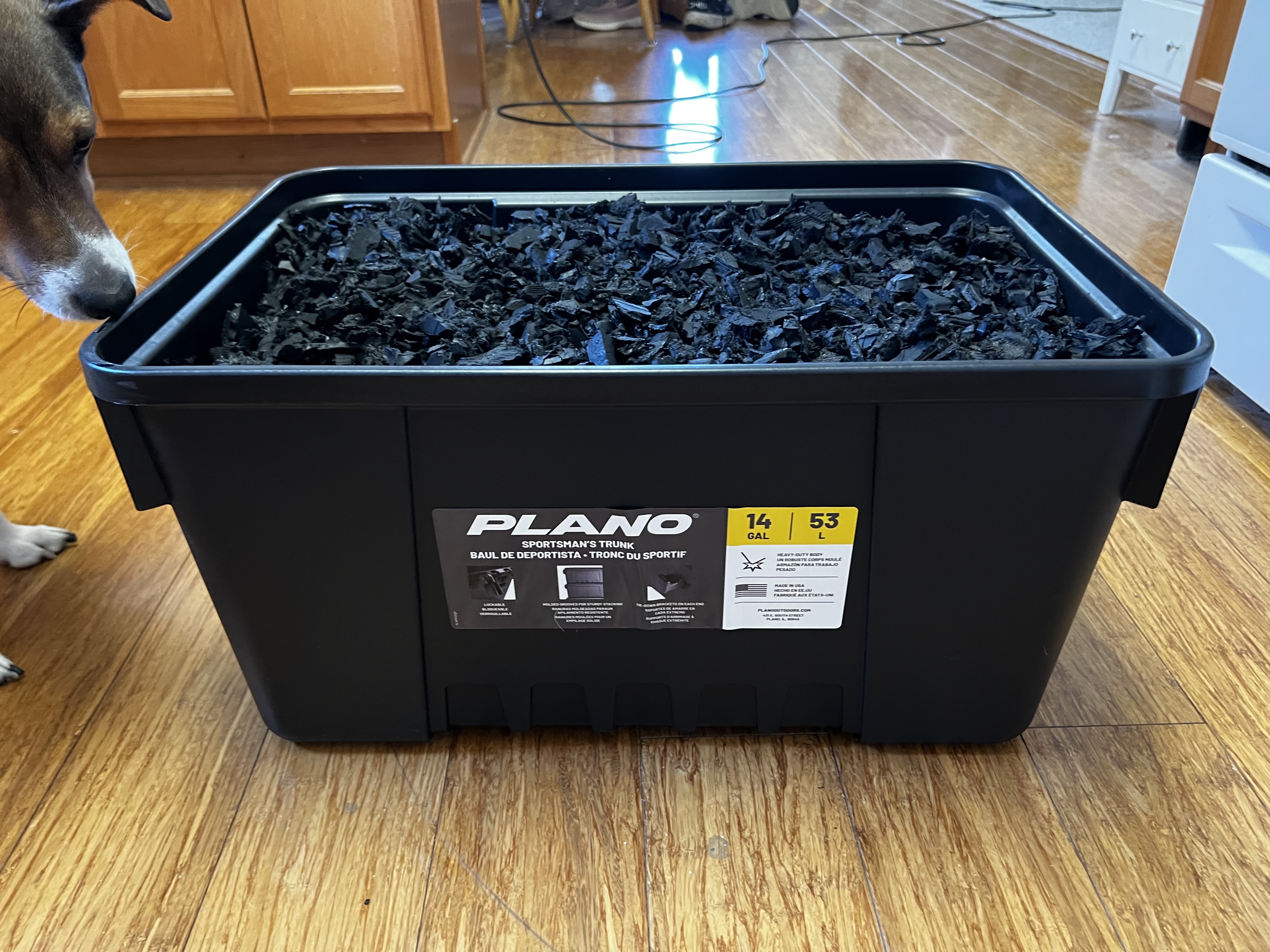

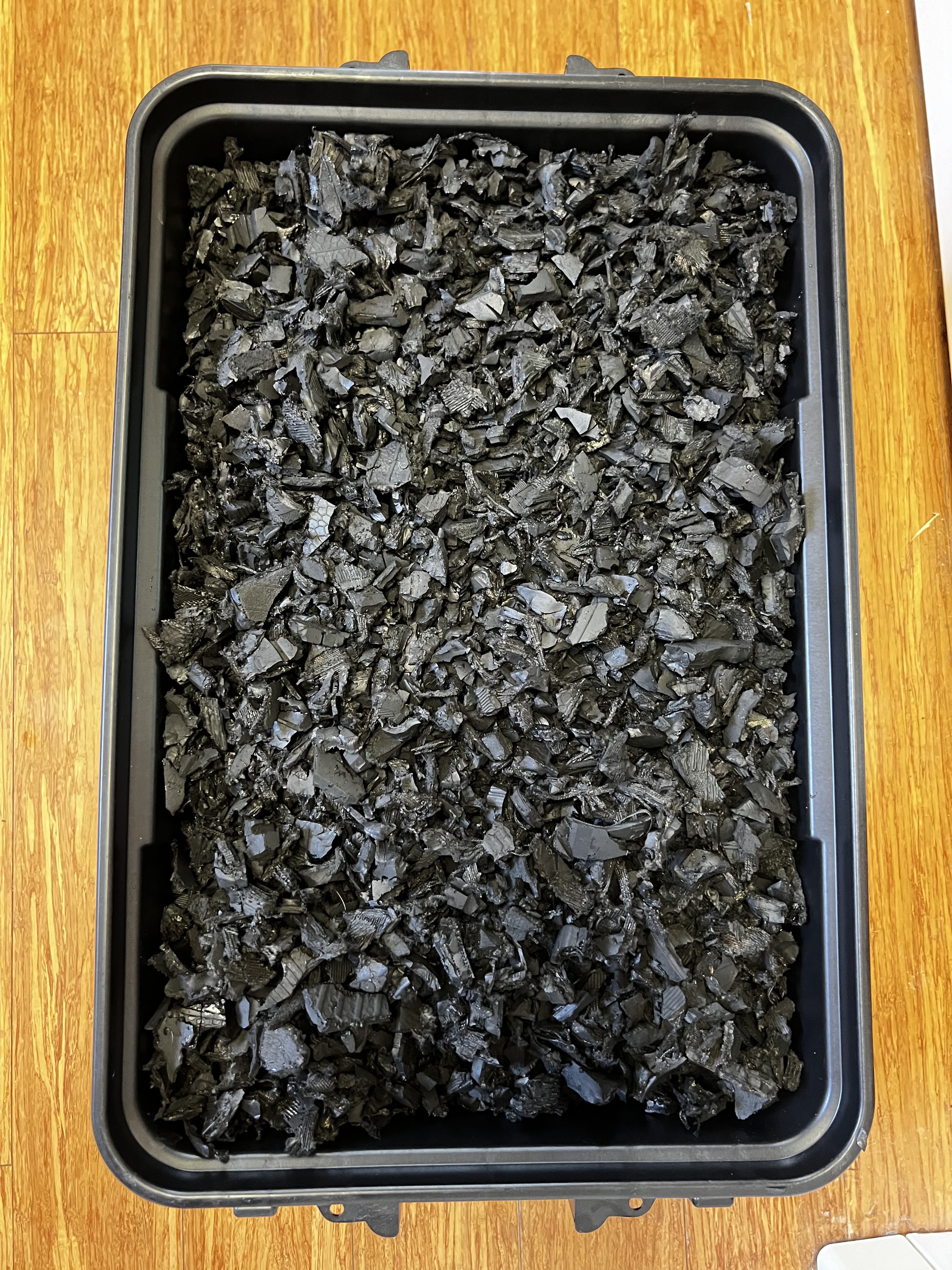

Just have a look right here on Airgun Nation. Large plastic tote filled with rubber garden mulch with a target sized window cut out in the lid. I used scrap carpet glued inside the lid for the target surface. Line the bottom with 1/2" plywood for just in case. I have no doubt mine would hold up to .22 LR. Metal pellet traps are loud on impact. Our home page has a resource center with plans. About 20 bucks to build a nice quiet effective pellet trap. Will take 2-3 bags of rubber mulch 7 bucks a bag plus the tote. Got rather angry a few days ago, I went to my club for pistol practice. The target plywood was really shot up so one of my fellow members put their targets on the 4 X 4 supports and shot the S out of the 4 X 4's. That jerk is a member, apparently. They made the repair cost 100 bucks rather than 25. What is wrong with people today to destroy equipment at "their" club??? Had another clown shoot our very costly bullet trap with .50 AP they aimed to do maximum damage to the bullet trap. Why??

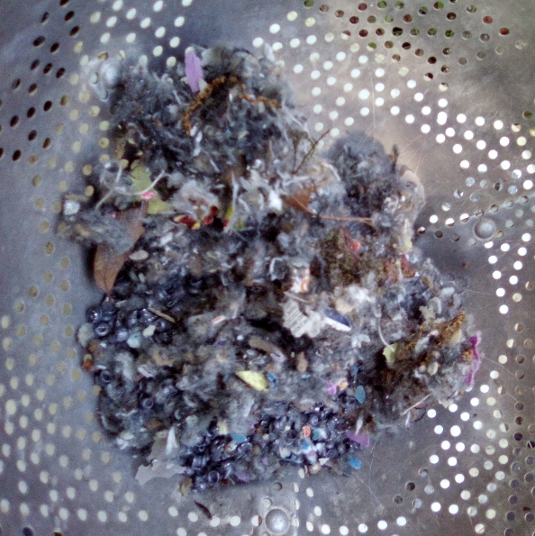

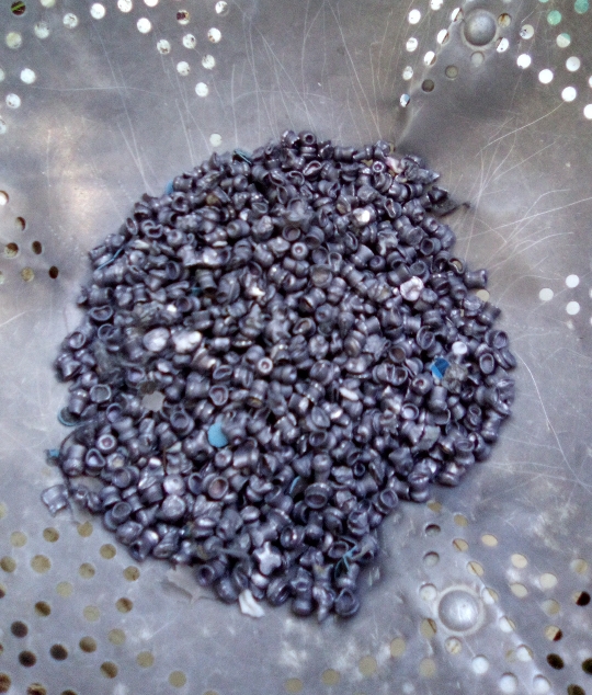

If you are really cheap, go to the post office and get some priority mail boxes and fill with rubber mulch.
as the boxes get shot up use duct tape to seal the holes.
hint: you can shoot both sides.
when the tape doesn’t work anymore (about 5000 shots), dump everything into a large tub of water.
the lead will sink to the bottom and can be re-cycled (give it to your Black Powder friends) and the rubber will float to the top where it can be used indefinitely!!!

The storage container linked above costs less than the shipping cost of this bullet trap. Very nice unit for those that can shoot PB in the backyard, I'd guess the majority here are like me and don't need to go this far. I'm certain my rubber mulch box would easily handle .22 PB. Very nice for those that could use it. We built a massive trap for our rifle range, some bozo snuck in and shot it up with .50 BMG AP rounds.
