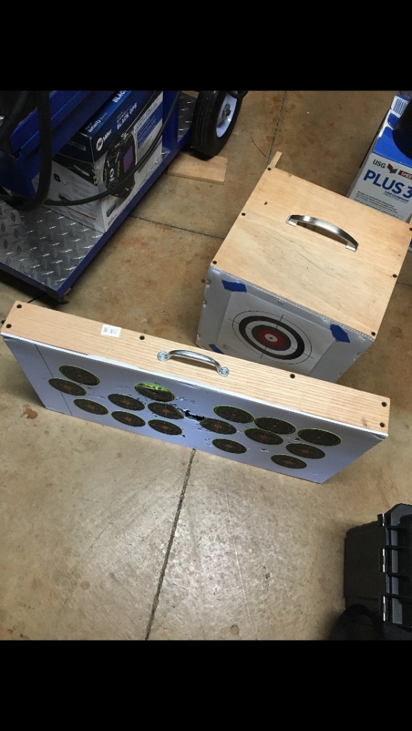

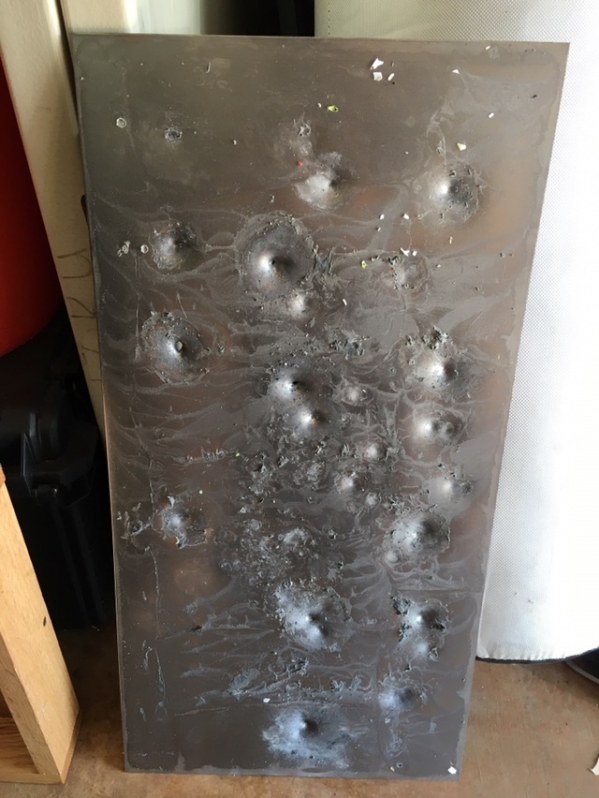

Make sure you make it heavy duty enough. My first attempt didn't last very long with these PCP's.
1/16" steel plate backed with 1/2" plywood and it was covered with 1/2" layer of duct seal.
Now these have 1/4" steel plates in them. The square one. The steel plate is at a 45 degree angle.
The thinner target has 1/2" plywood, 1/4" steel plate. 1/4" rubber sheet, and 1/2" of duct seal.
1534565061_2527836145b779ac56fb974.66353750_1526769691_19295530525b00a81b501983.10385087_IMG_...jpeg
Here the thread about the pellets penetrating the target
https://www.airgunnation.com/topic/what-are-people-using-as-a-target-my-impact-needs-a-better-option/
