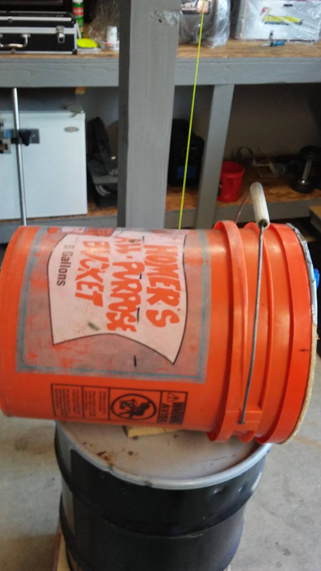

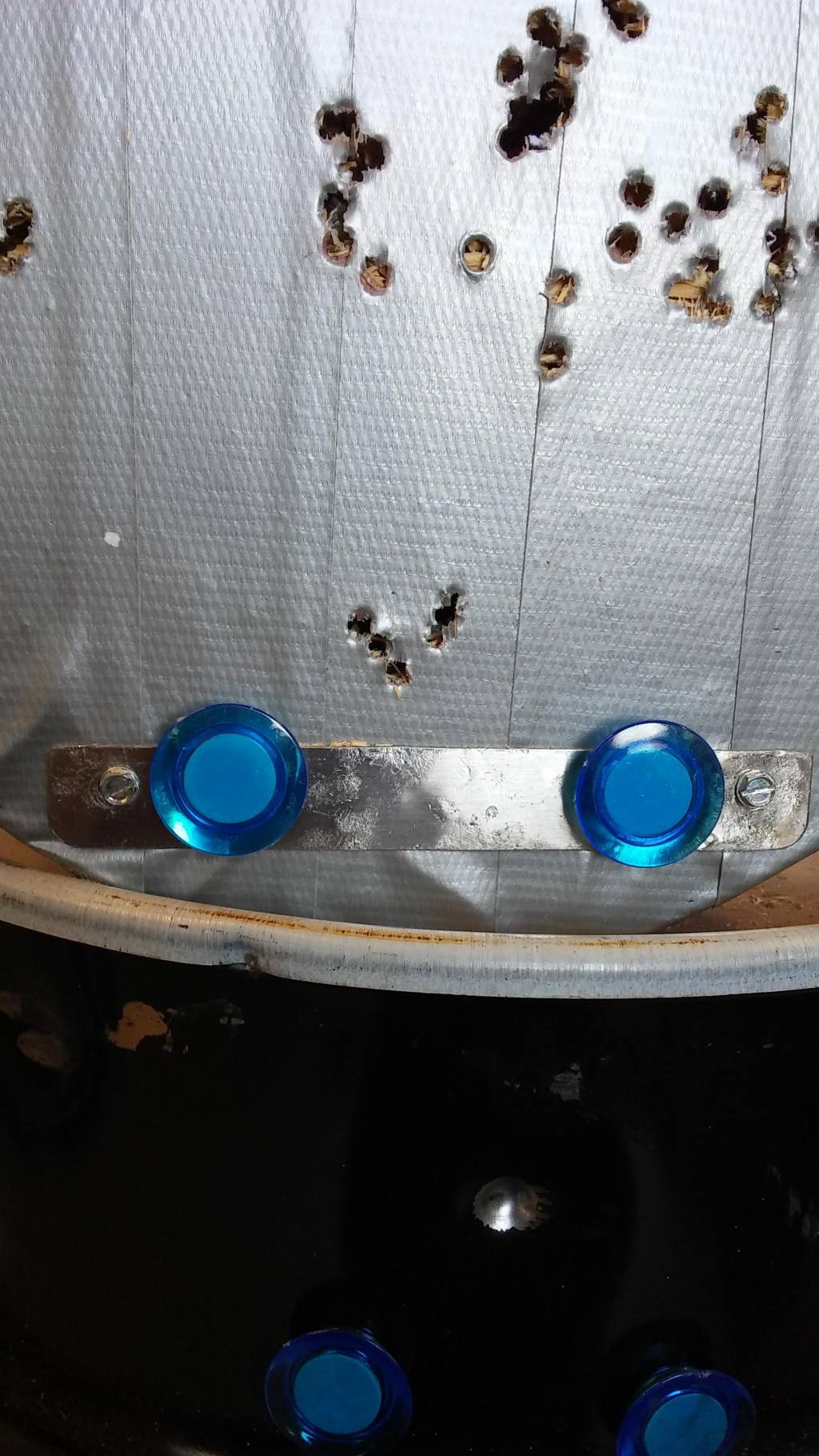

I use a 5 gal. bucket half full of rubber mulch similar to Biohazardman has suggested I put a piece of plywood in the bucket to only fill halfway . The metal strip with magnets holds paper targets , magnets are from the (dollar store). Forgot to add front of bucket is thin plywood or use that hard pressed carboard that is used on the bottom of dresser draws screwed to the face of the bucket . Good luck

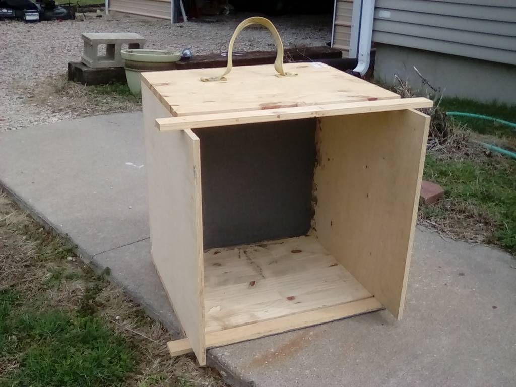

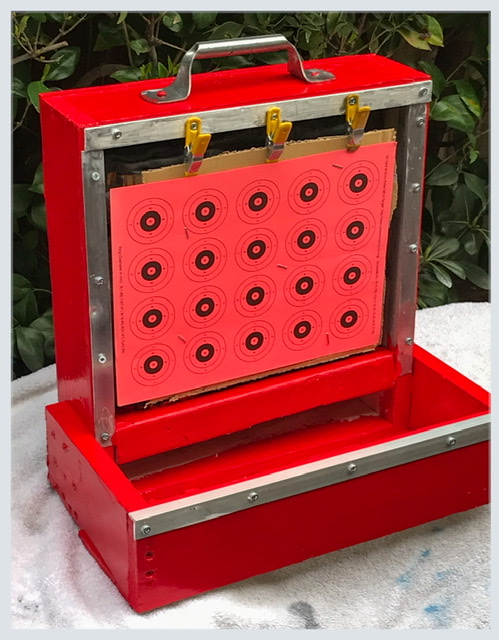

I made this myself. The back of the pellet trap has a couple of layers of Duct Seal. This will stop the pellets but I stuff a bunch of old bed sheets into the trap as well. The old sheets will stop the pellets before they hit the Duct Seal. This makes the pellets easier to recover by simply removing the sheets and shaking them out over a bucket. Much easier than plucking them out of the Duct Seal. Also this way prevents the Duct Seal from getting tore up.

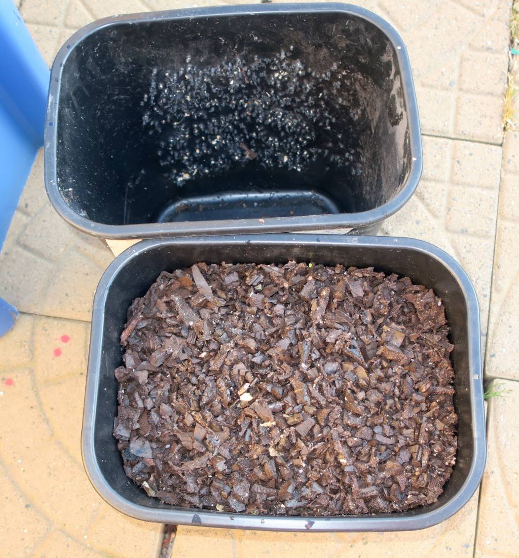

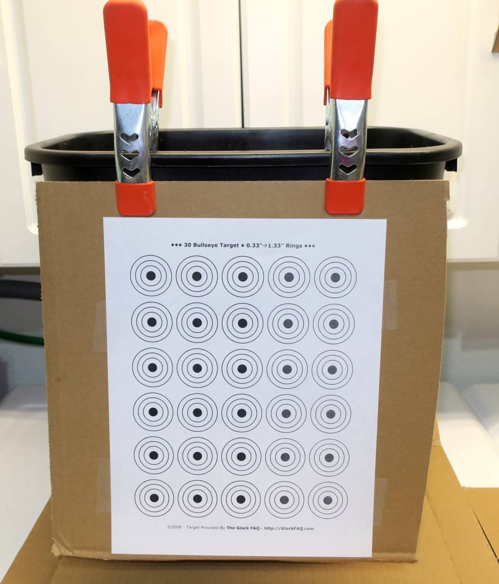

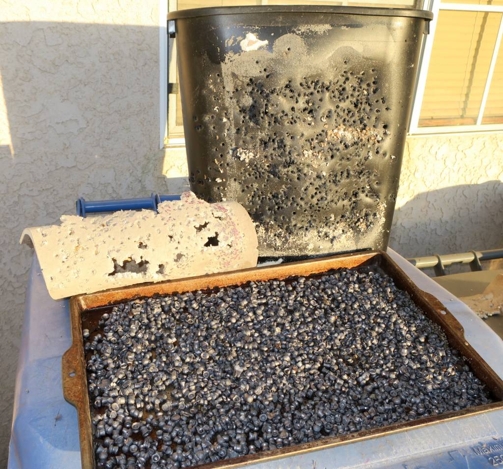

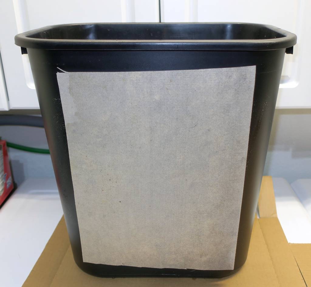

Plastic trash can filled with rubber mulch nuggets. About 5 bucks each when purchased in 10 or 12 pack. Somewhat self-healing, softer plastic. Just cleaned one out I shot for the last 5 months, and wasn't 'leaking' any mulch yet. Water drain holes drilled in bottom - can leave out in wet weather. Quietly stops everything I have shot it with up to .30 cal.

I tried the duct seal, didn't like it. I do like the rubber mulch. as you shoot it breaks down, so just add more to the top of the box. I like the plastic trash can idea too. Right now, I just use a cardboard box with a steel backer because I use it for close up chrony work and my .25 will punch clean through after 10 or 12 shots. I "Panned" my lead out of the mulch a few months ago. Separated easily, just took a handful, put it in a large pan and shook it. Lead went to the bottom, mulch stayed on top. Worked like a charm.

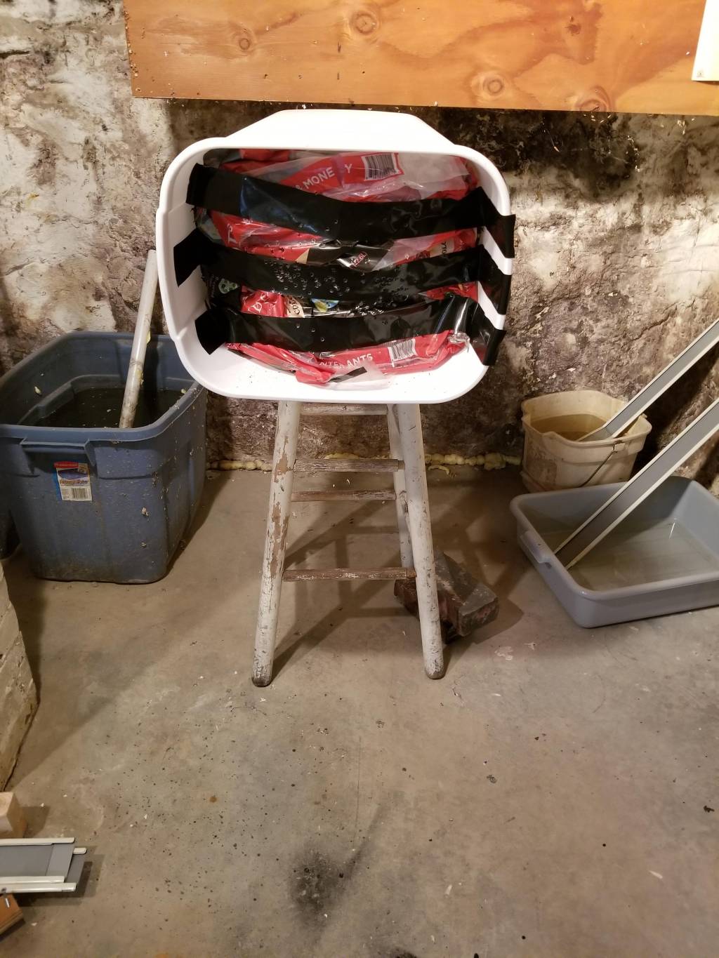

Couldn't find rubber mulch nuggets, so settled for the shredded. Tried shooting through the side as TMH does, but the plastic on mine is more brittle and I can see it shattering in time. No pass-through, though. So I put 2 bag 0.8 cu. ft. in the trash can, pressed down with my fists a bit, folded up the bags from the mulch, taped in place with a few strips of Gorilla tape, and laid the can on its side so I shoot into the open end. Very quiet, stops my 45 ft-lb 22 slugs easily, no lead splatter, no confetti. Best solution I've seen in in 35+ years of airgunning. Got another one set up for 70 yd backyard backstop and keep one in basement for testing/tuning/chrono work. Great idea.

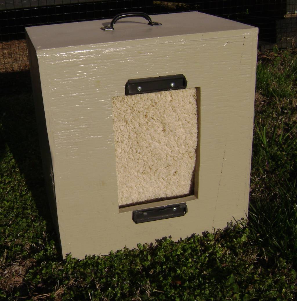

Mine is 1/2" plywood everywhere but the back which is 3/4" or double 1/2". I forgot which. I put solid duct seal bars accross the back. I then stuffed it with folded up carpet pieces. I put clipboard clips at the top and bottom of a cutout about 1/2" smaller than printer paper. I can count on one hand how many pellets have reached the duct seal in 6 years running FAC .25 & 177. Twice a year I toss the carpet in a trashbag and put in some fresh pieces. This trap will outlast me. I am a chronic over-builder and just had to paint it.
