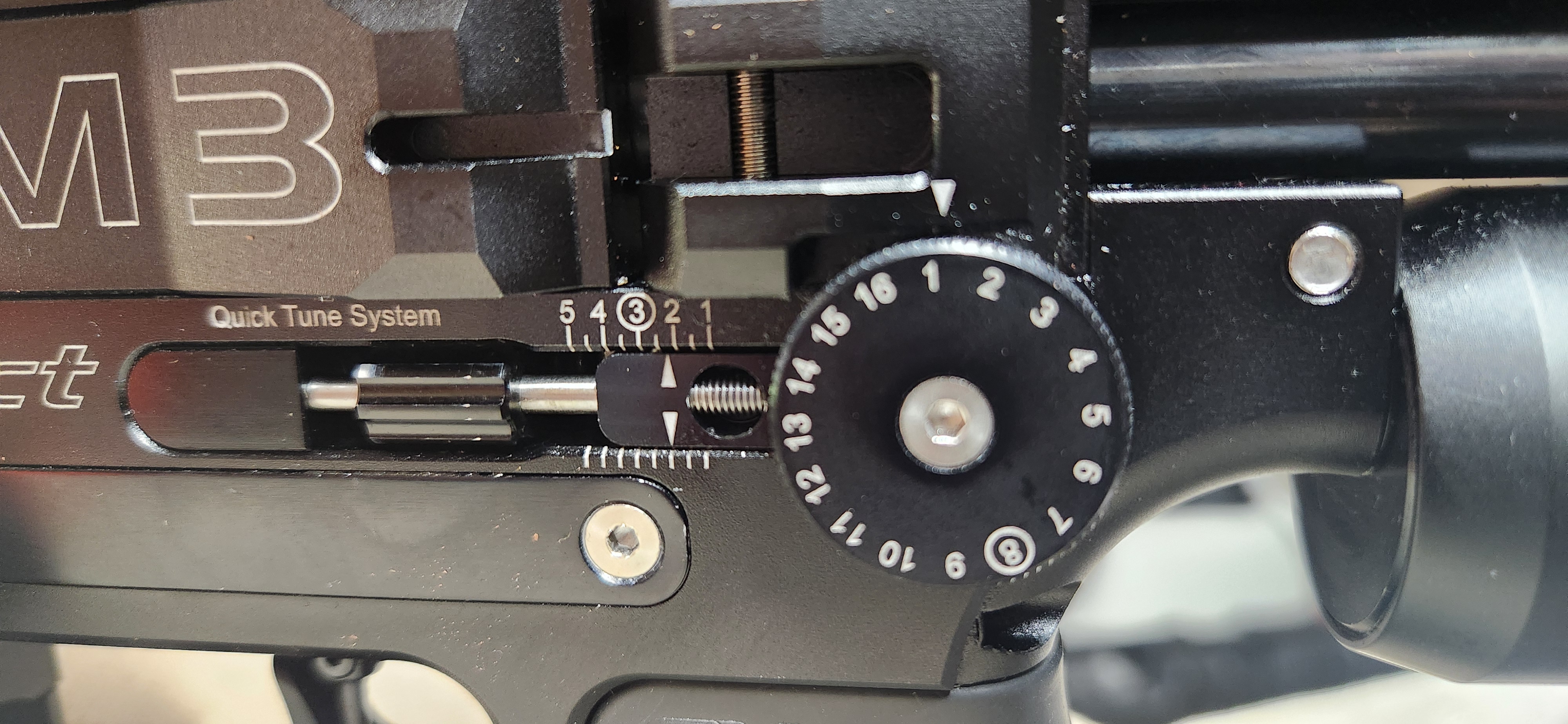

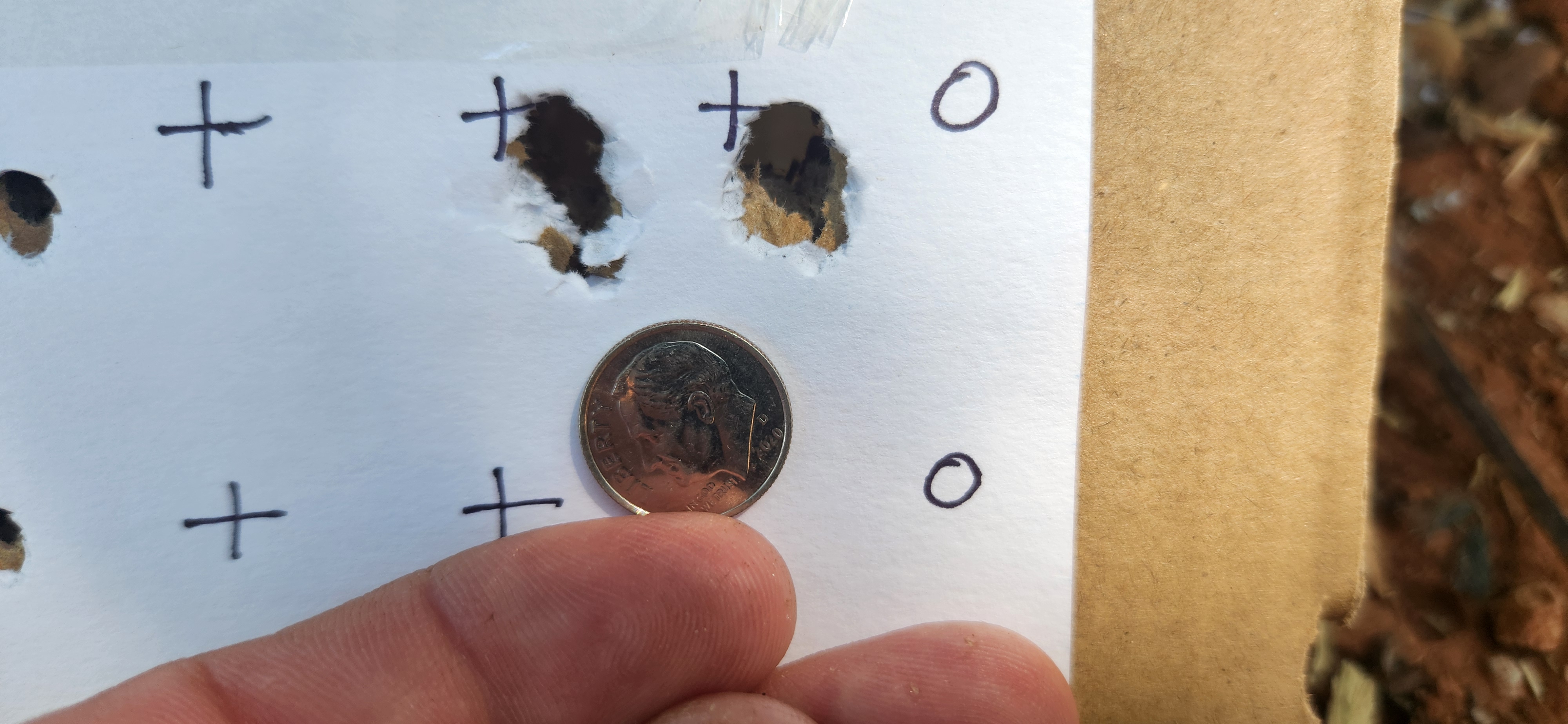

I know people have different experiences but I just pulled my .25 Impact M3 out to shoot yesterday along with most of my airguns. I had to dust the Impact off its been so long since shooting it. I couldnt tell you the last time I shot it. The M3 stuck them all in one hole with the H&N slugs I listed in my earlier post. I even knocked it over on my hard laminate floor 2 or 3 times in the last week as I was moving things around my gun room. I have 3 slug guns 2 are impact M3 and one is a panthera and none of them have been a headache.
