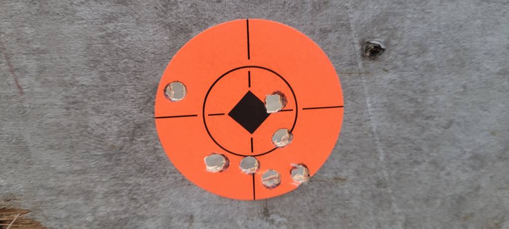

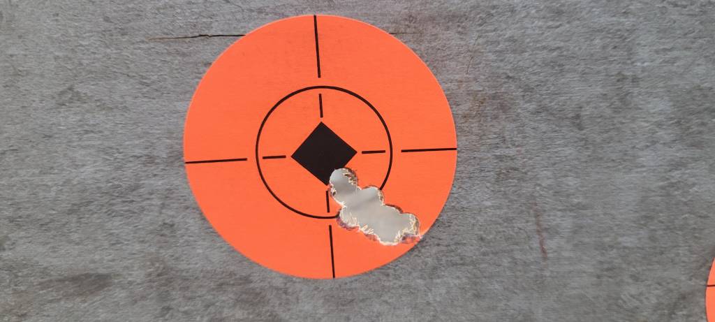

I use ballistol on slugs with good success. I never used to lube pellets until recently I have some baracuda hunter pellets that really wanted to shoot well for pesting but they would not group well enough. I decided to lube them using silicone oil and it worked. First pic is not lubed
Second pic is a group shot with lubed pellets. Both groups shot @ 50 yards.
