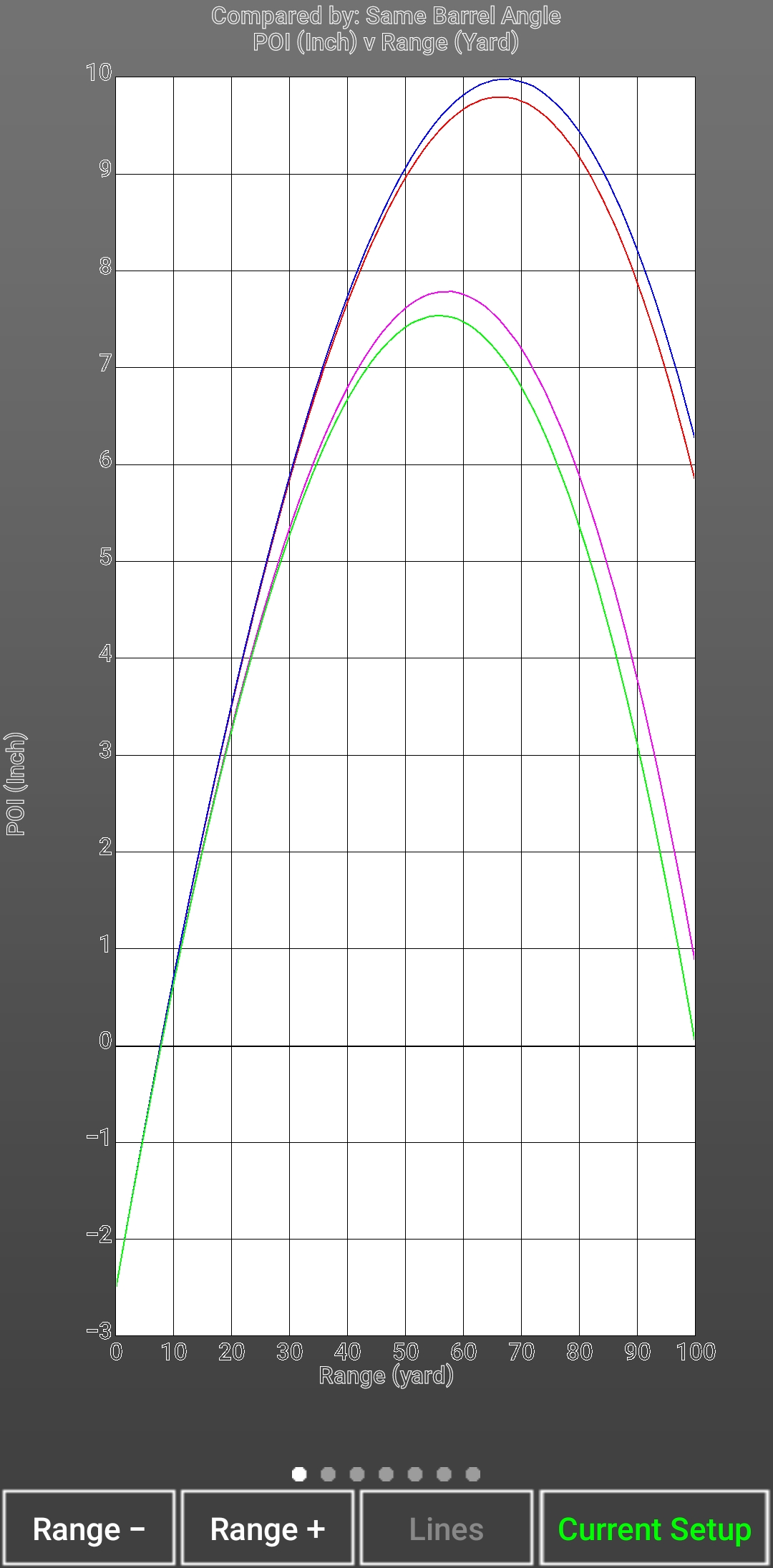

Using Chairgun (mobile), the graphs and tables can be adjusted to use the same barrel angle as one of the 4 selected pellets.
🔶 POI Error at 50y:
The 25.39gr will hit 0.1" higher when it is 1.0gr too light (24.39gr).
The 33.95gr will hit 0.2" higher when it is 1.0gr too light (32.95gr).
🔶 POI Error at 100y:
The 25.39gr will hit 0.42" higher when it is 1.0gr too light (24.39gr).
The 33.95gr will hit 0.84" higher when it is 1.0gr too light (32.95gr).
➠ Now, you need to see if you can live with that.
Below a graph that shows the POI error at 100y for the 33.95gr pellet (the 25.39gr is not correctly displayed in this graph).
● green line = 33.95gr
● purple line = 32.95gr = 1.0gr too light ➔ hits 0.84" high
Cheers, 😃
Matthias
🔶 POI Error at 50y:
The 39.95gr will hit 0.2" higher when it is 1.0gr too light (38.95gr).
The 39.95gr will hit 0.84" higher when it is 1.0gr too light (38.95gr).
Cheers, 😃
Matthias
🔶 POI Error at 50y:
Cheers, 😃
Matthias
