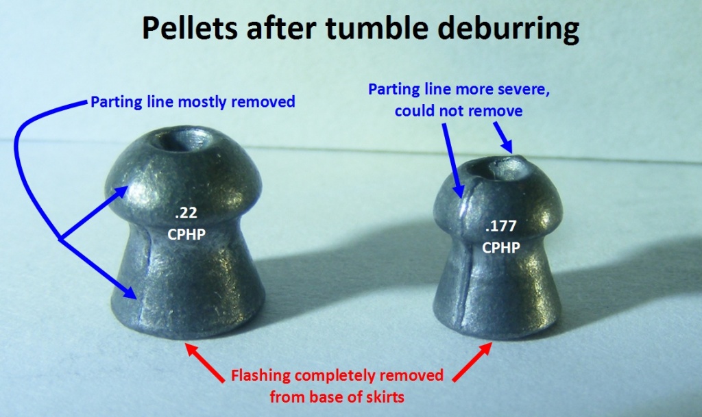

Just curious if anyone uses a tumbler to polish thier pellets and if it makes a diffrence in consistancy and accuracy?
For pellets with visible parting lines and mold flashing, it does help diminish the parting lines and break away the flashing.
It won’t make mediocre pellets into great ones but it does make a demonstrable improvement in some cases. More details on my experiences at
Note I have not used a vibratory tumbler with media, just tumbled them in a wire basket against themselves.

Makes total sense. I've heard of walnut or corn husk as a soft media that might work. I bet this is a trick the pro's use but don't tell anyone about it. But then again I'm sure they choose the very best of pellets sort by weight and flaws etc.. I don't b see why polishing them up in a tumbler would hurt anything. It's like de-buring a plastic wheel on a cub scout pinewood derby car. Makes a huge difference while rolling down the track if it's flush.
