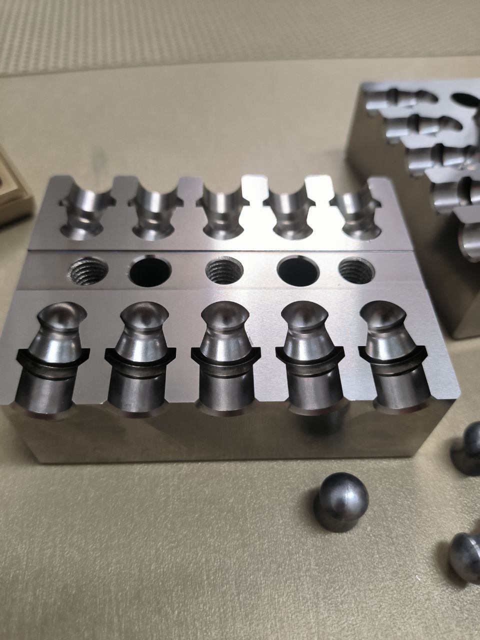

Dear AGN forum users, I am a pellets/slug mold manufacturer from China. This is not an advertising topic. I have read a lot of AGB forum topics about pellets/slug. I found that many users are interested in pellets/ Slug has its own ideas, which is worth learning. I want to look for a pellets/slug design master, similar to Ballistic Boy, who has a deep understanding and is proficient in using various design software. If you are interested and willing to challenge an interesting job, you can PM me, I am very happy to work with you, I will pay or free mold.

My mold is a high-hardness cold stamping mold, not a pouring mold, and my mold is very hard. 58-60HRC, and never rust, using 440C SUS material. I really hope to cooperate with him, I PM him, but he didn't reply

Your best bet is to find a distributor or dealer here to sell your molds. I have regular molds that I cast with, they work fairly well. Yours are the swage type that has more consistency, but typically at a higher price point. Looking forward to what you have to offer in the future. Do you also produce mold that are +/- in sizes, or offer sizing dies?

Your best bet would be NOE Moulds. The mold above is a swage type, while the NOE is a casting type. There is a big price difference in between them both. NOE is way easier to come by, the other is hens teeth.
