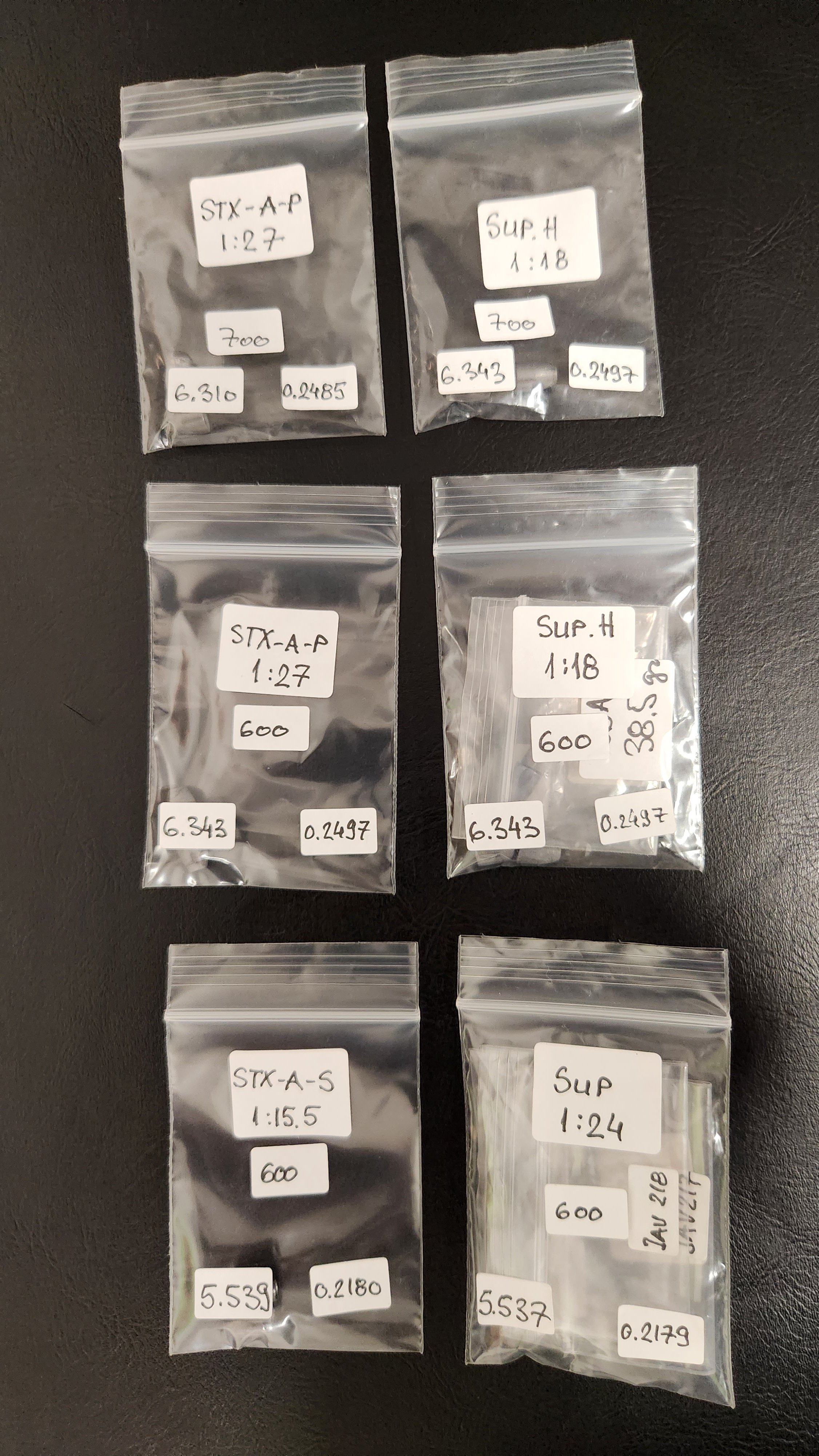

These are the barrels / liners that I have slugged:
Alpha Precision (Rus for Leshiy2) Twist Rate 1:17.7 - 6.35/0.25 x350 = 6.340/0.2496"
Alpha Precision (Rus for Leshiy2) Twist Rate 1:17.7 - 6.35/0.25 x500 = 6.348/0.2499"
FX STX-A pellet Twist Rate 1:27 - 6.35/0.25 x700 = 6.310/0.2485"
FX Superior Heavy Twist Rate 1:18 - 6.35/0.25x700 = 6.343/0.2497"
FX Superior Twist Rate 1:24 - 6.35/0.25x600 = 6.342/0.2497"
FX STX-A slug Twist Rate 1:15.5 - 5.5/0.22x600 = I did not slug it yet, will do next time when removed for cleaning

Here are my numbers from slugged liners, you need to do your offset 3 microns or maximum 5 no need more ...
STX-A-P is a pellet liner
STX-A-S is a slug liner
