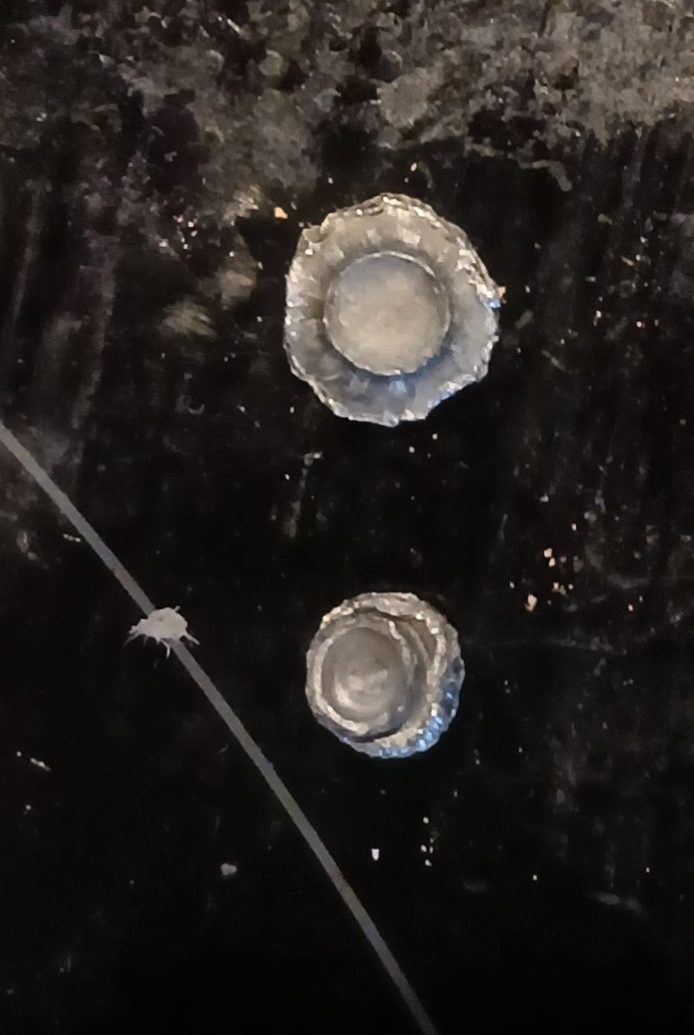

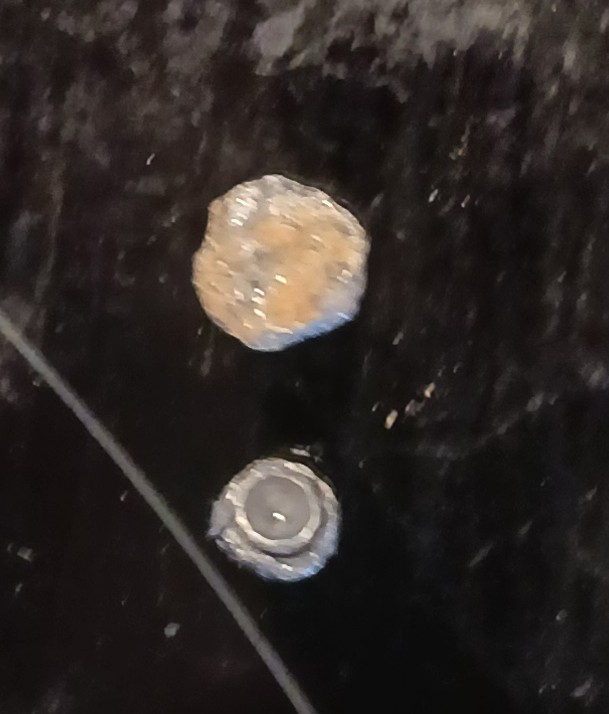

It was raining when I started so I tested penetration in mdf in the garage at point blank range. That was a bit of a mistake because I normally test at 25 yards. The 21 grain went through 3 .25 inch pieces of mdf and the 12.5 grain 2. But I then tried the 21 grain at 25 yards and a 10.6 grain pellet at point blank range. Both tests indicate I get through 1 more layer of mdf with either gun when testing at point blank range. So penetration of the slugs in this hard material is the same as pellets. I will include a picture of a 10.6 grain pellet and a 21 grain slug after going through the mdf. Both are pretty distorted.

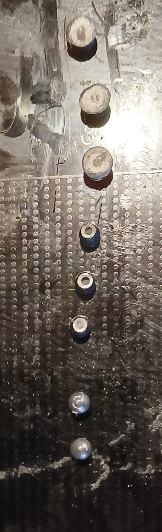

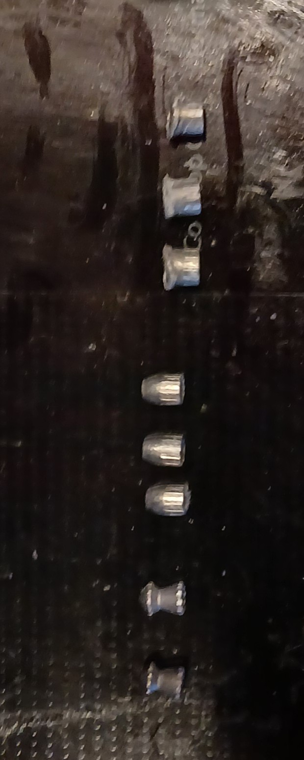

I will also include pictures from the side and nose of the projectiles that went into the paper. The 21 grain H&N slugs expanded to about .265 and the 12.5 grain Nielsen did not expand. But the Nielsens left the muzzle at 800 fps and the H&N left at about 920 fps.
I found the 10.6 grain pellets in the 10th and 11th magazine. That's consistent with previous tests or a little less, probably because this test was at 35 yards and prior tests were at 25. The 12.5 grain slugs went through 9, 11, and 12 magazines. The 3 21 grain slugs went through 12 magazines. In prior tests the Caiman shot through 17 to 19 magazines with 18 grain pellets.
