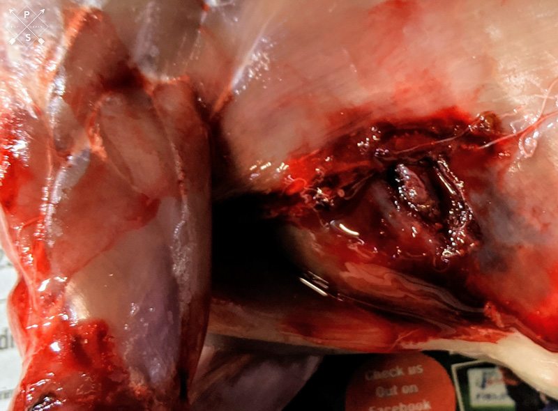

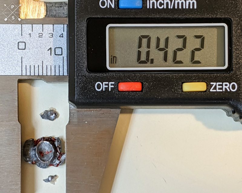

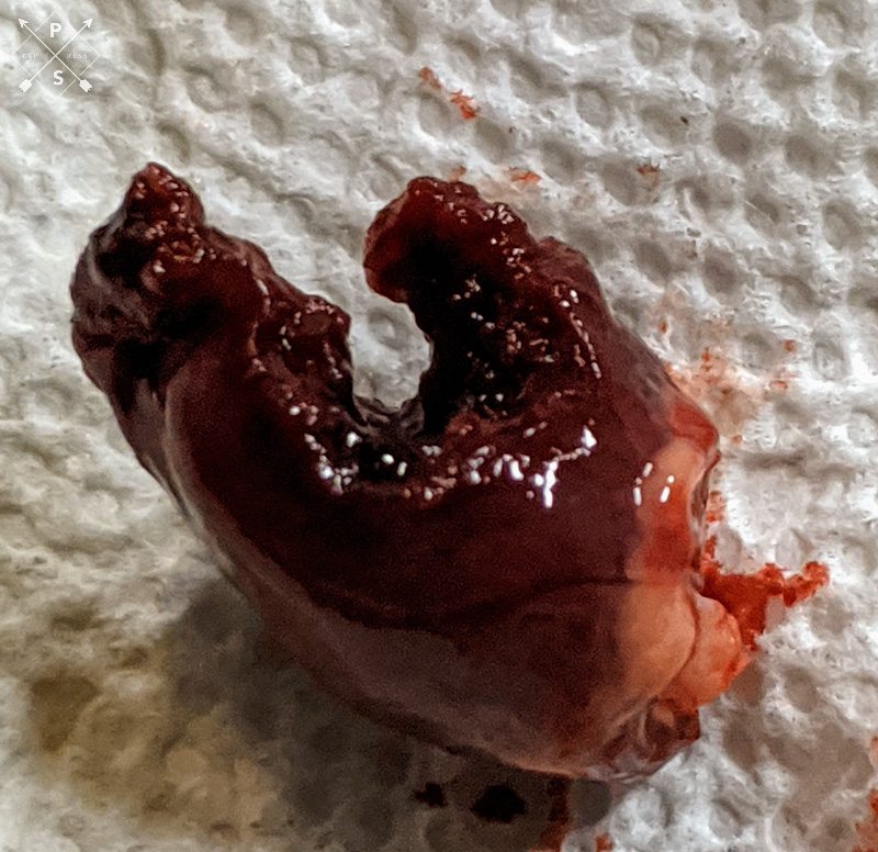

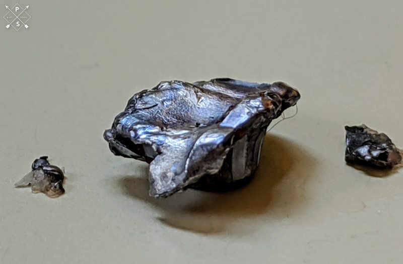

Performance of NSA 17.5 gr. .22 slugs at 900 fps.
Great expansion and wound channel.
