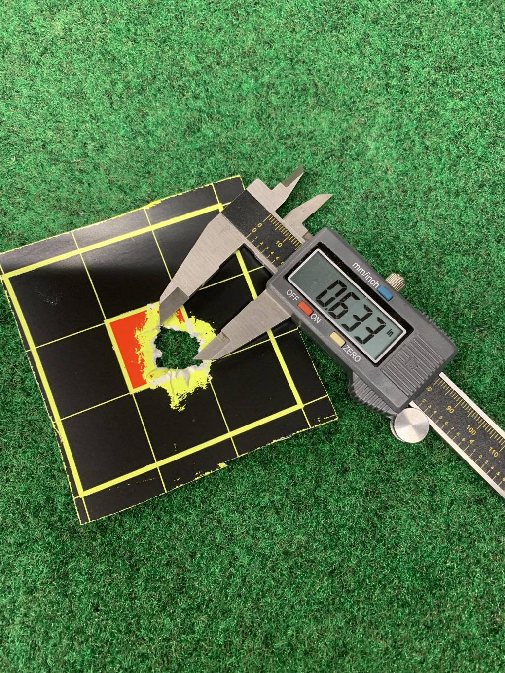

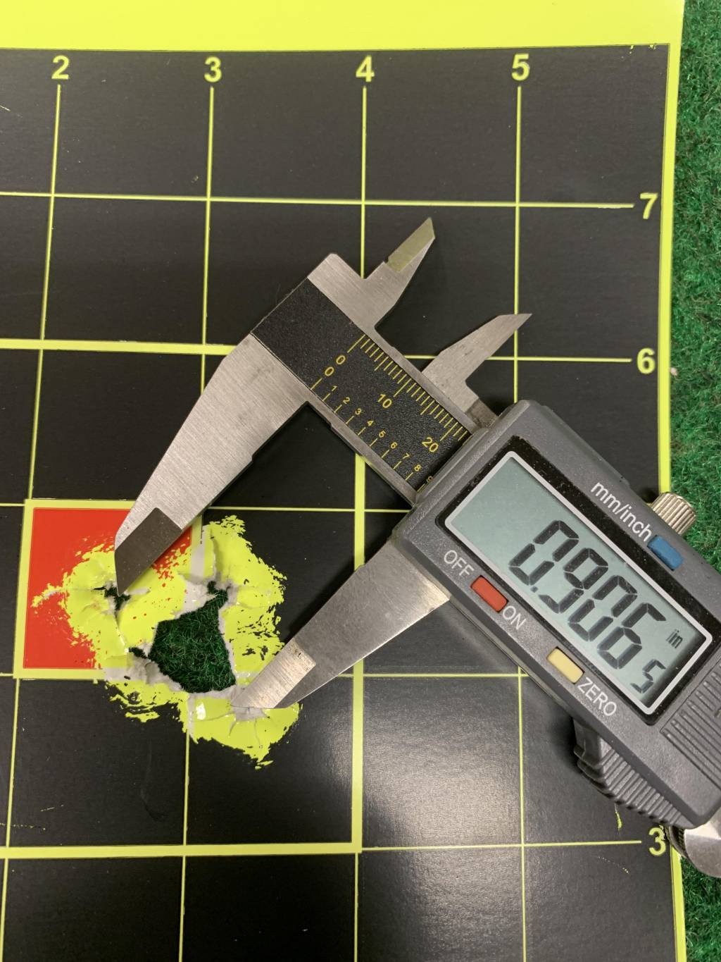

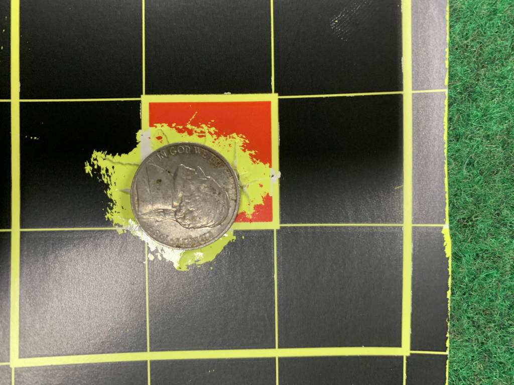

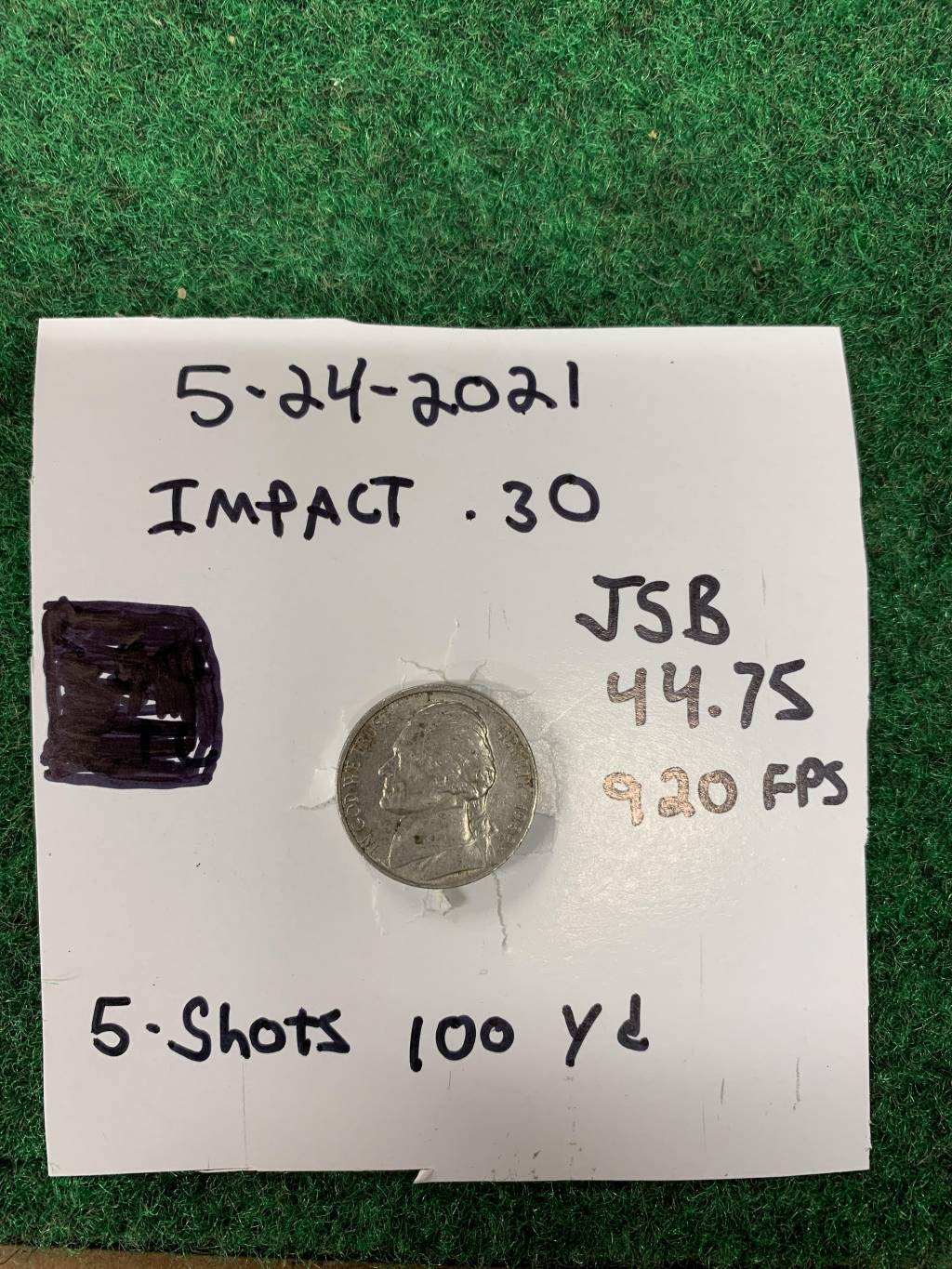

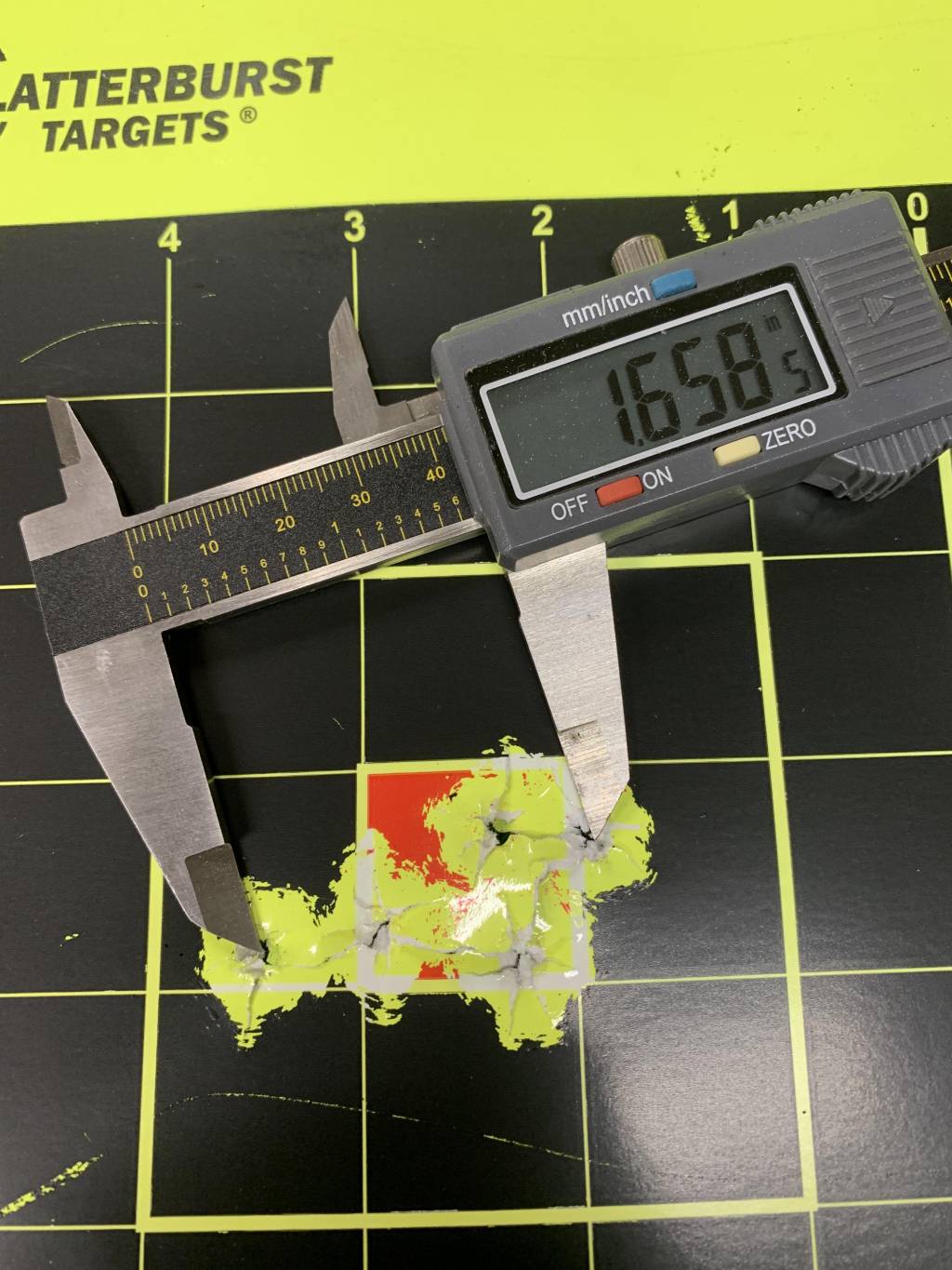

I know these groups are common here but this is a personal best for me. 3 groups in a row. 100 yards 5 shots each, Impact MKII .30 STX pellet liner shooting JSB 44.75s at 920 FPS. The side-to-side increase was right in line with the increasing wind. It was a short session but a great day at the range!
