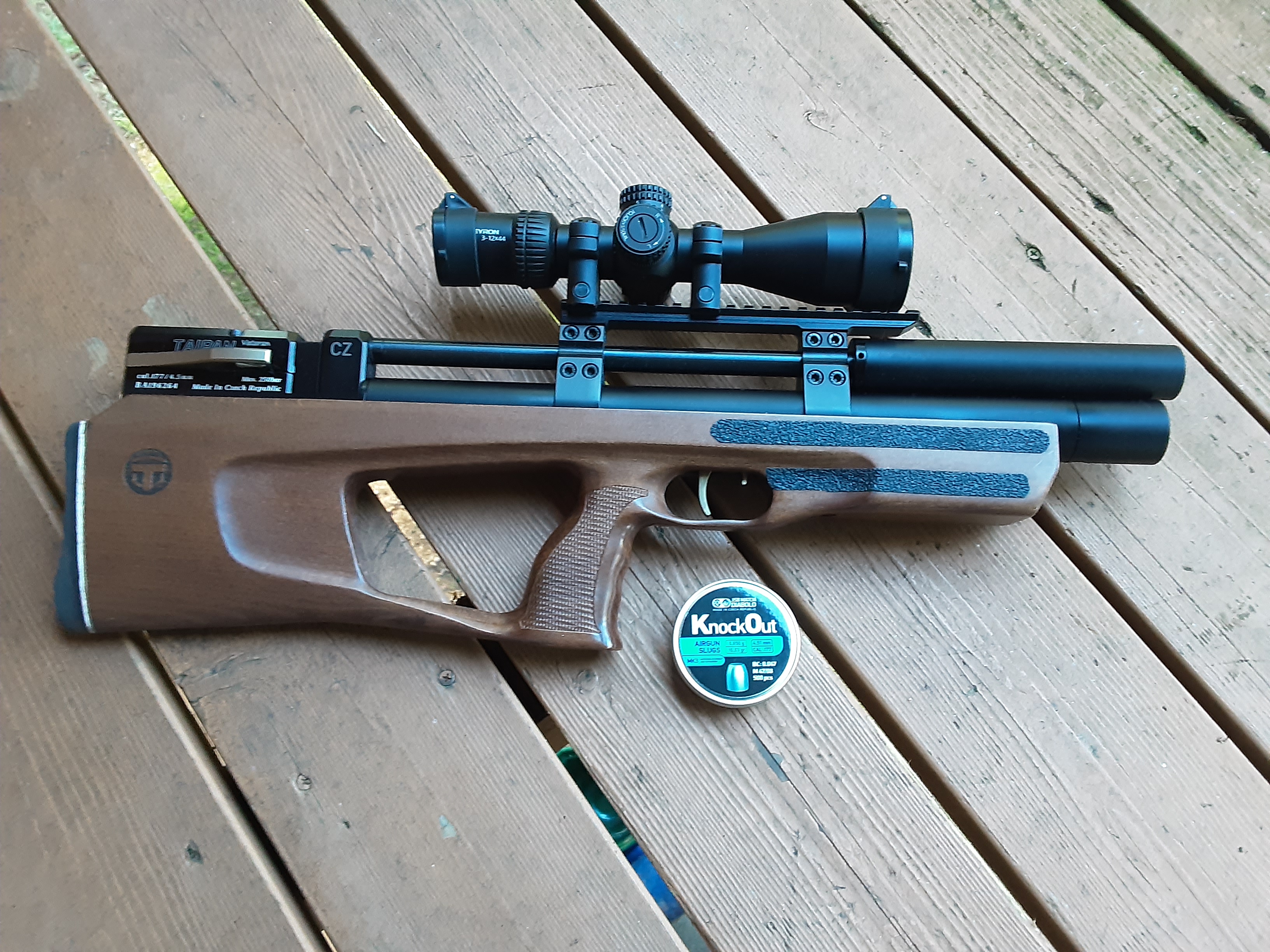

Hi I'm looking to get a Vixen long for some pest control but I'm not sure what to get.
I'm not looking for very high power as it is for backyard pest control.
So the focus is a lightweight setup and no crazy power to keep it safe.
I am reading that the vixen in 177 likes a variety off slugs so i'm not sure if i would go for that 177 or the 22.
A 22 15.89gr pellet at 900fps has 28.60 fpe but only a BC of about 0.025-0.030.
A 177 10gr slug at 900fps has 18 fpe but with a BC of about 0.047-0.048
If I would want low power from the 22 i would have to go very slow so I looks like the 177 slug would be the better option,
with better wind resistence due to the high BC and being a slug i'm assuming good expansion.
But nothing beats practical experience so i would love to hear if any body can share their experiences on this.
Regards JP
