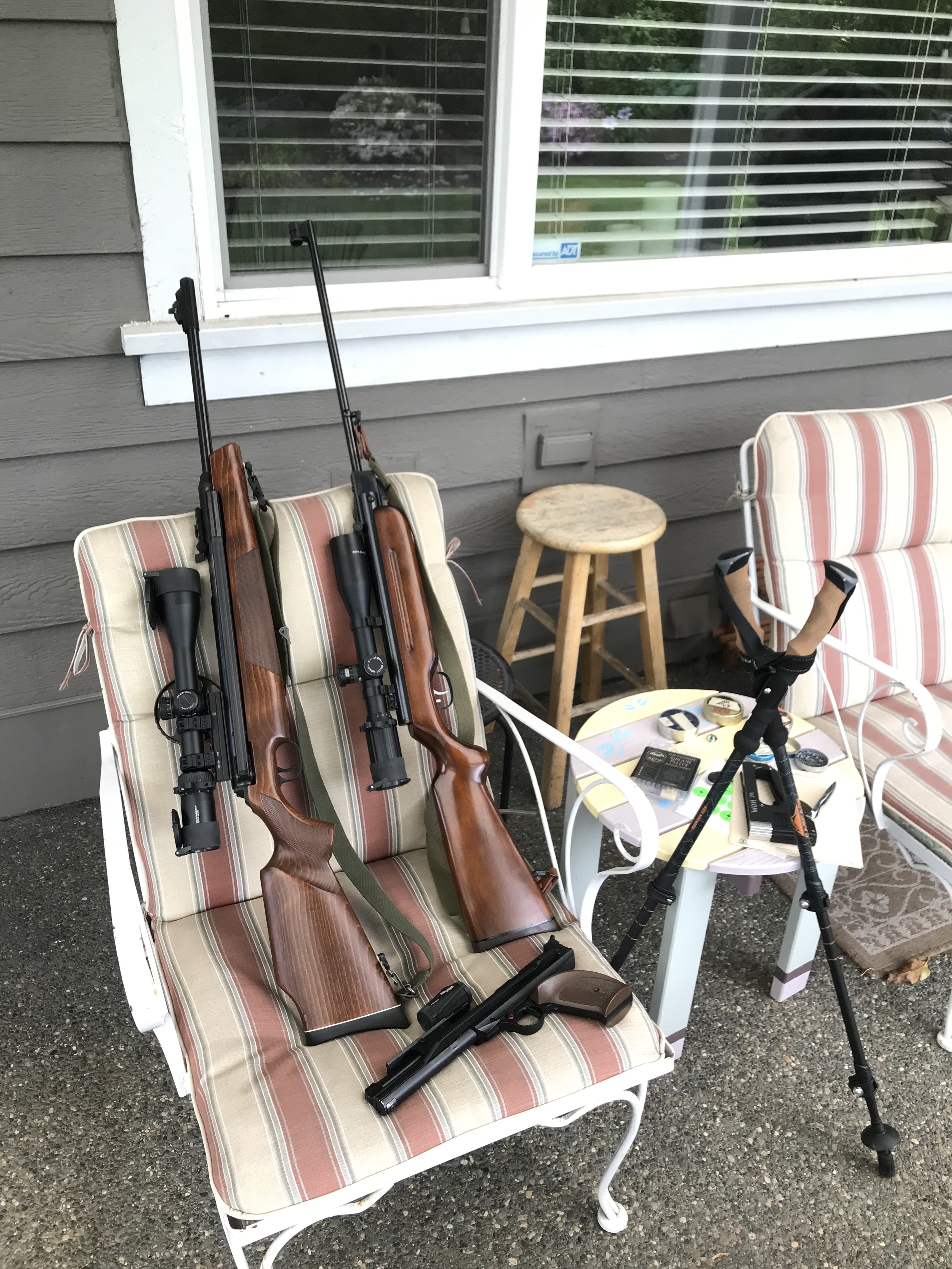

I shot my German spec Weihrauch HW35 this afternoon… I think it is a similar gun to your HW30… what a joy to shoot in comparison to the RWS-54 which I also had out today. Love the ease of cocking and loading… getting into position was easy and ergonomically efficient … I was experimenting with a set of modified hiking sticks as shooting rests… just wish it can kill critters like tree rats… as it is, it is just a paper puncher and pea gravel eliminator with its 7.5 joule power limit
