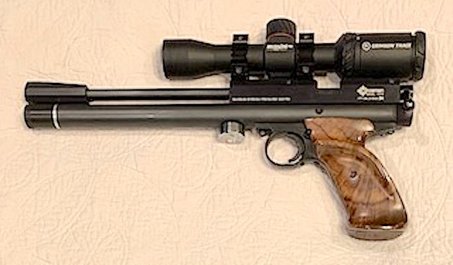

The scope alluded to in my post above is a 2.5-8X Crimson Trace pistol scope. I didn't have a photo of it on the gun until a few minutes ago, so just solved that-
I'm often a "form over function" type guy, and to my eyes the CT scope looks a bit ass-end heavy on the 1701. I'll probably switch back to the T/C 3X soon anyway.
Because guns are beautiful, pistols especially, I often play musical chairs with different scope/gun combinations before finding the right silver-slipper fit. However, any given gun's wardrobe often varies to fit the given purpose/application du jour. And as LGD observes, I keep a wide optics wardrobe on hand to keep my extensive pistol collection well-dressed for any occasion. ;-)
