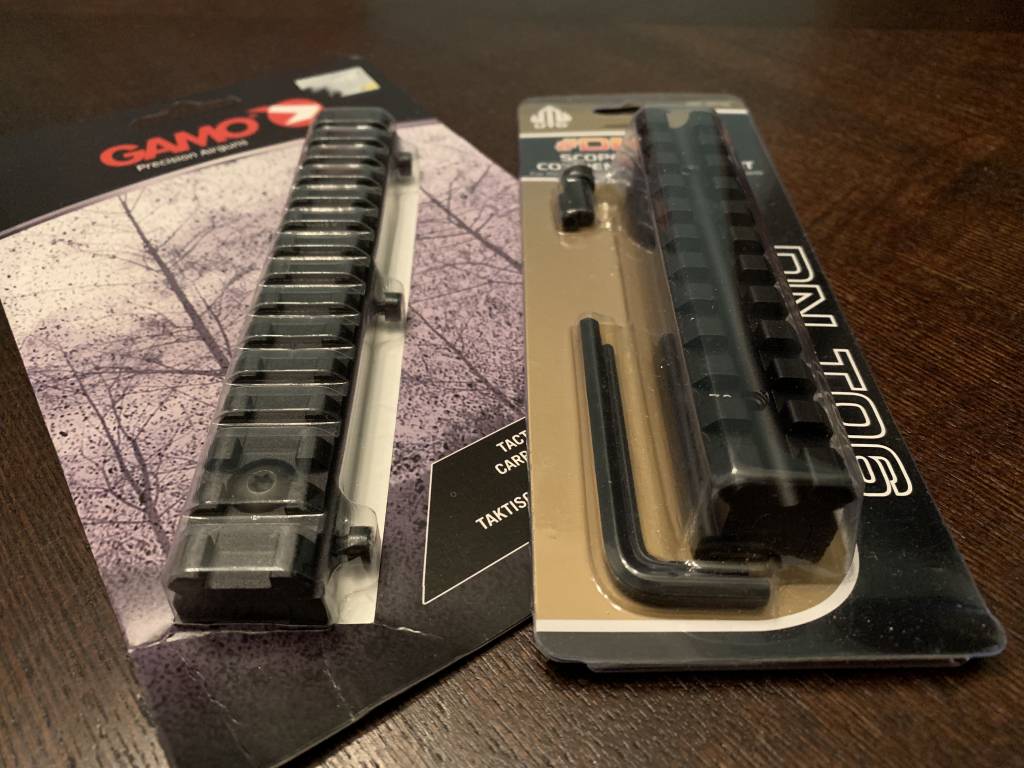

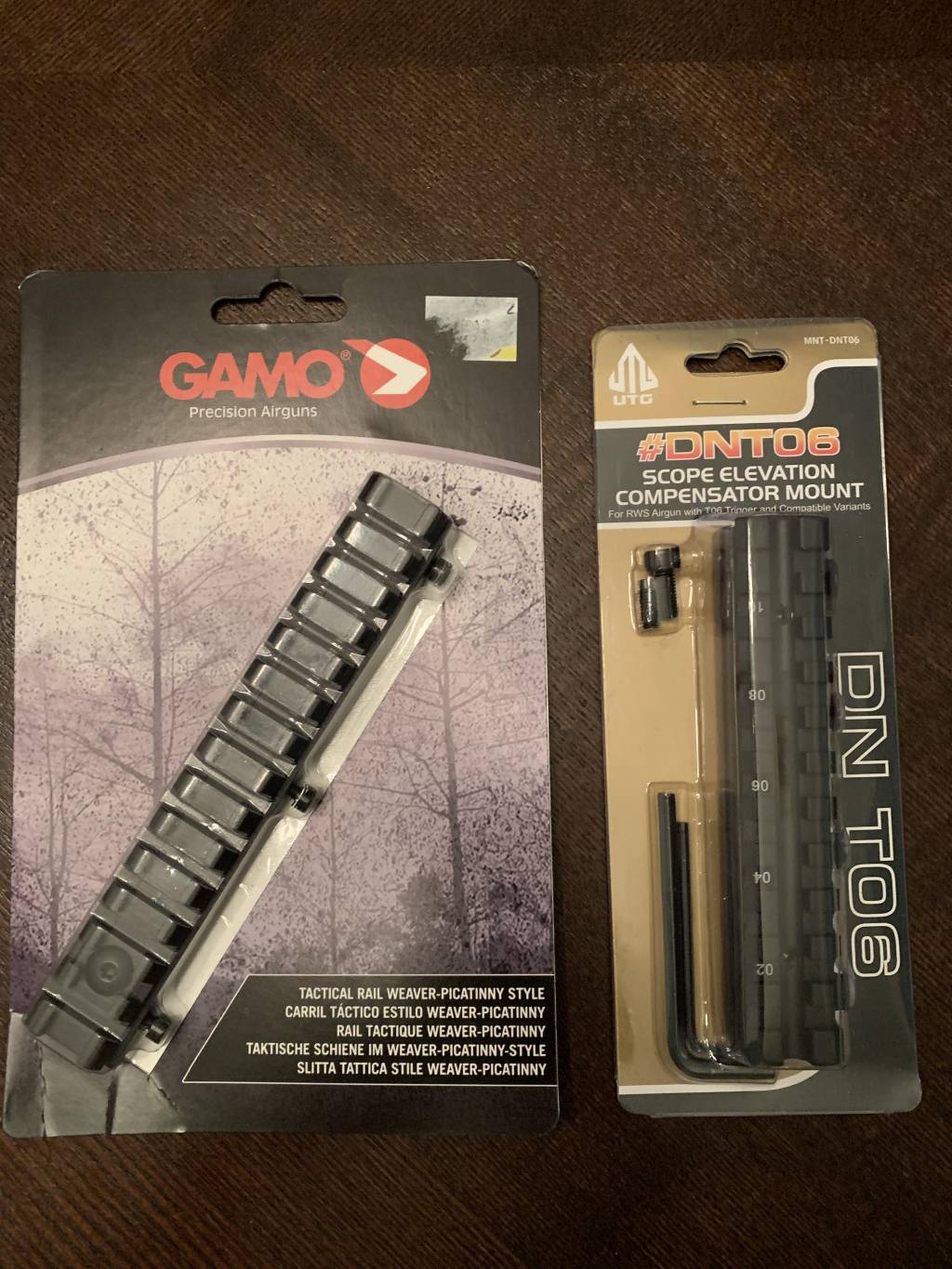

The UTG is great since it has the angle, but my favorite is the Gamo picatinny adapter. The reason is that it’s longer flatter and has a much better stop pin. It’s hard to come by I bought 3 of them from this place in Ireland they shipped with no problems.
https://hfs-online.com/gamo-tactical-rail-weaver-picatinny-style-6212214.html
here they are side by side.
