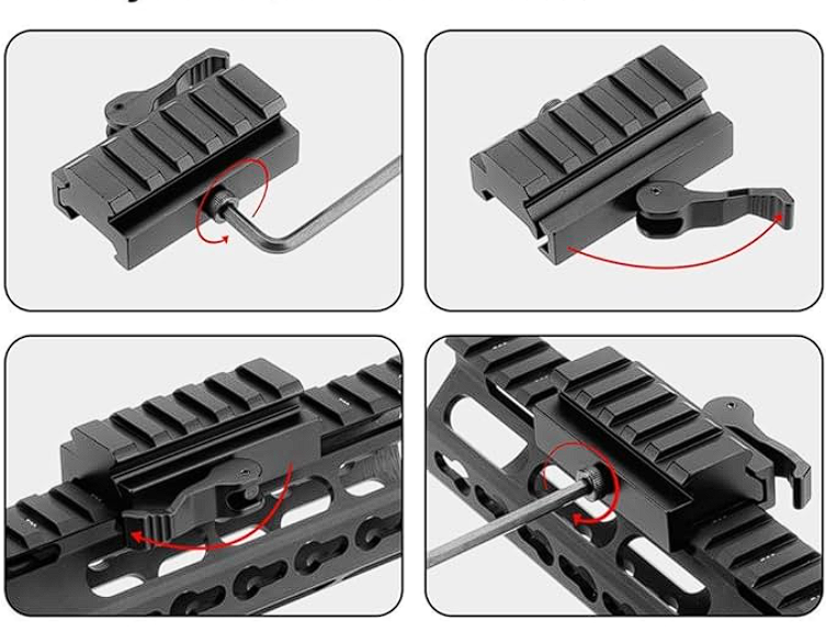

Has anyone replaced the allen or torx screws on there picatinny accessories ( rings, bipods, etc ) with something more convenient? Seems like it would be possible to upgrade to a thumb screw or a quick release or something!?!?
I wouldn't advise using QD for rings and removing optics in general.
you can securely mount a low profile laser and zero it to match your optic at whatever magnification you want. you can use a qd on your optic mount after that and always find your zero in less than 10 seconds without sending a pellet down range. you can use that same laser to check your scopes ability to keep track of its click values tooYou always can get a QD (quick detach) lever style Picatinny accessory, I don't think there is an easy way to "upgrade" from a screw to QD, but you might be able to find a replacement thumb screw though. I normally prefer QD over fixed or thumb screw, especially for bipods. Makes it very easy to take off for transportation and put back on a range. I do not like thumbscrews because you can't really torque them properly with your bare hand. I wouldn't advise using QD for rings and removing optics in general. Usually, it throws away your scope zeroing and you'd have to re-zero it again. Especially important for long range shooting, which is what I'm into. But for other accessories, QD works perfectly.
That's the thing... this bipod doesn't have the QD mount. It's just 2 allen screws. The wobble isn't in the mount, it's actually in the legs where they pivot. Way too much play in the mechanism. For close to $100, they're really bad!!Hmm, Magpul makes great gun accessories, never had any issues with their products. Did you adjust the screw tension for the QD lever?
