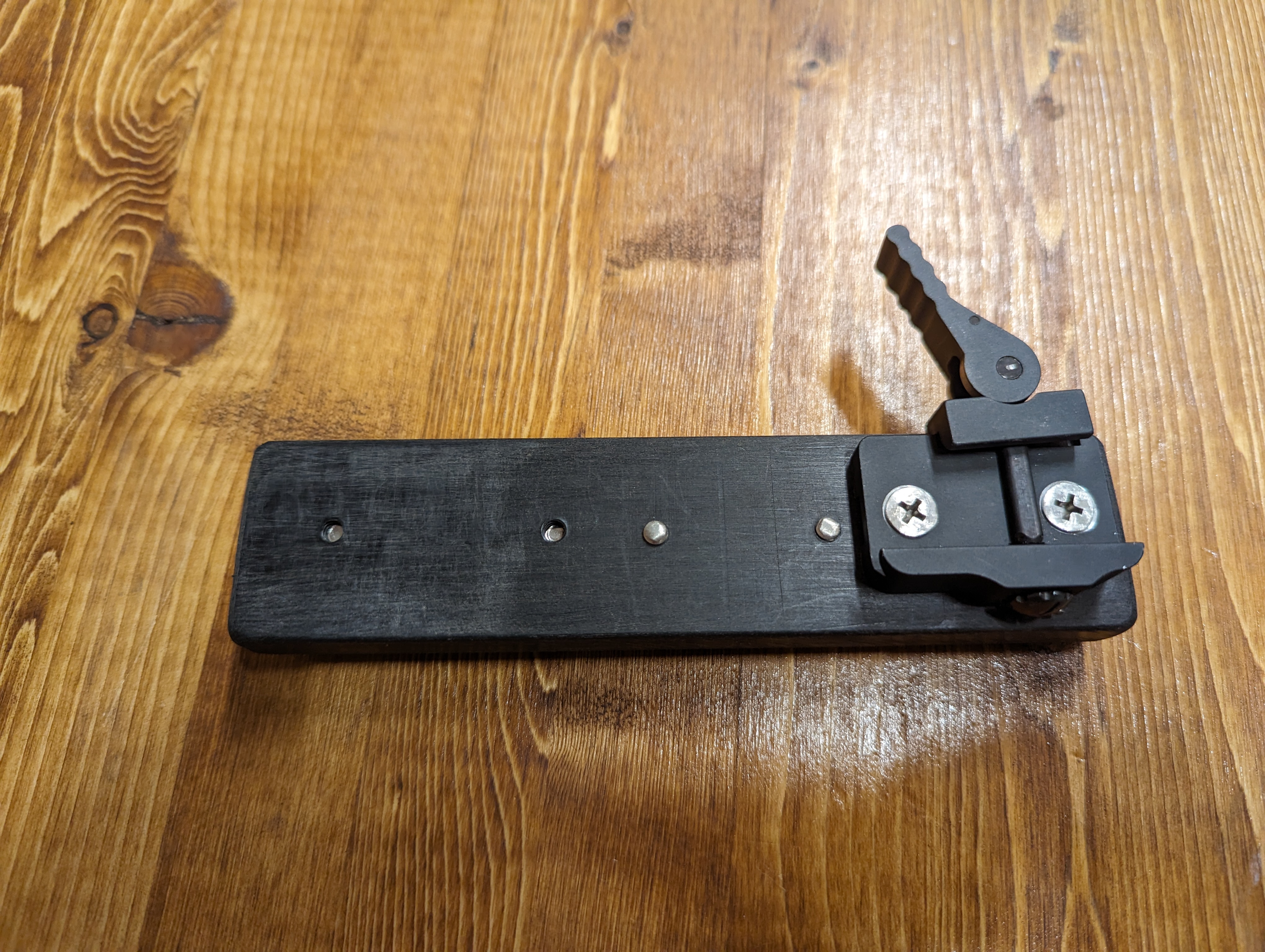

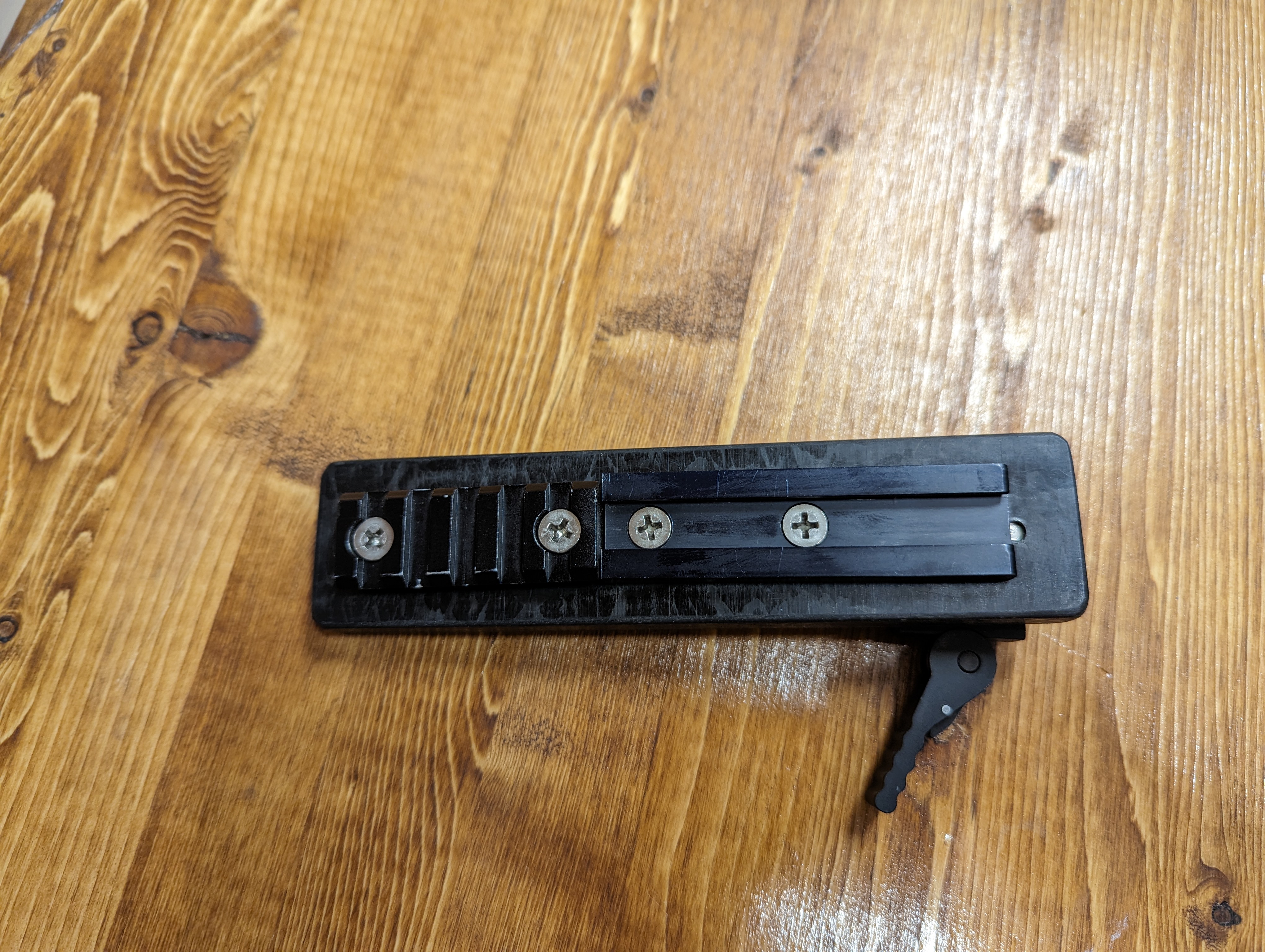

This is the end result....

It's not perfect, the screws for the UIT could stand to be shortened.
But it does very effectively allow the use of a knee riser or a bipod, as well as making no permanent changes to the gun...don't want it on there anymore, just remove it with the pic clamp (link above).

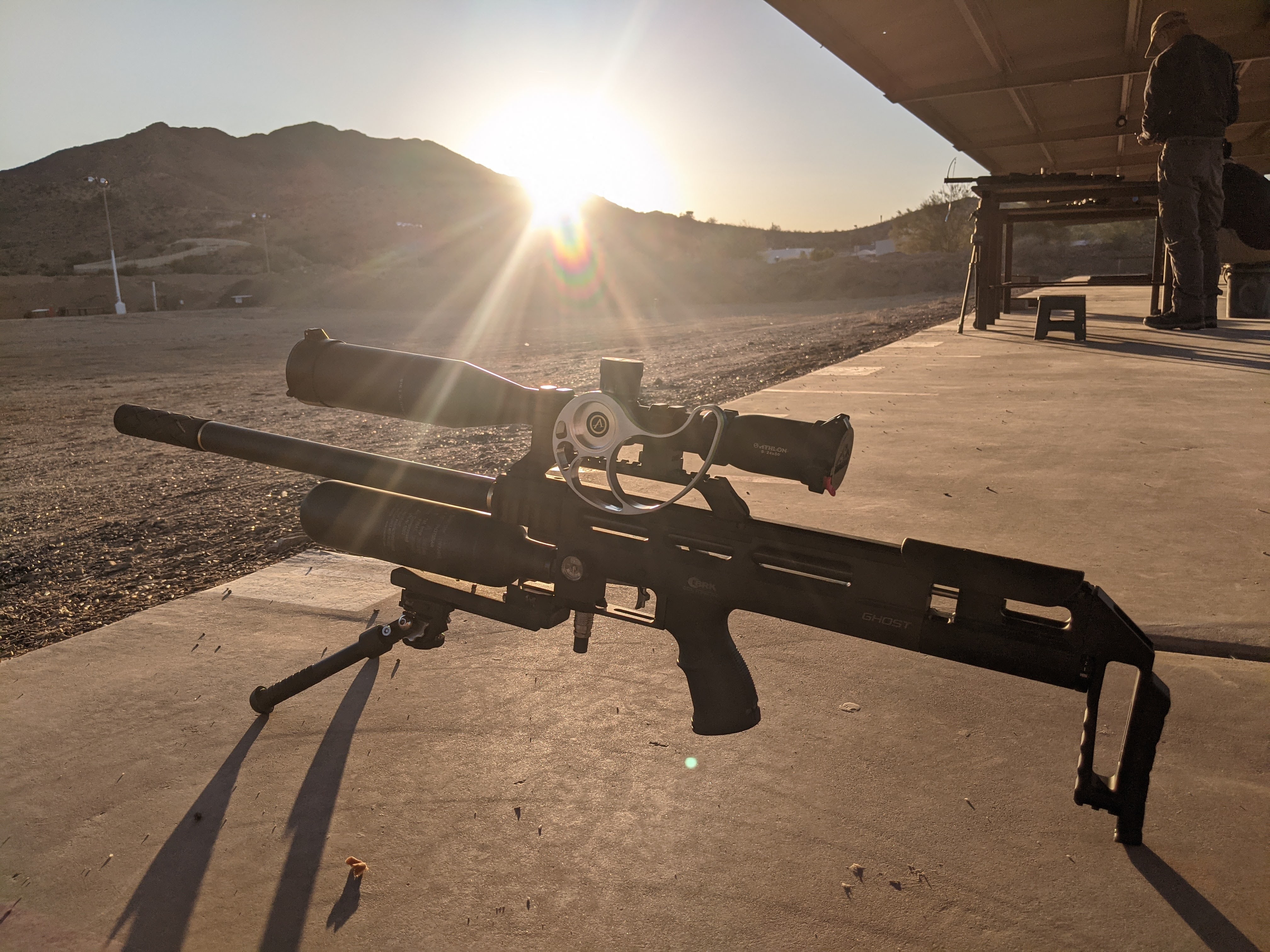

And in action...
