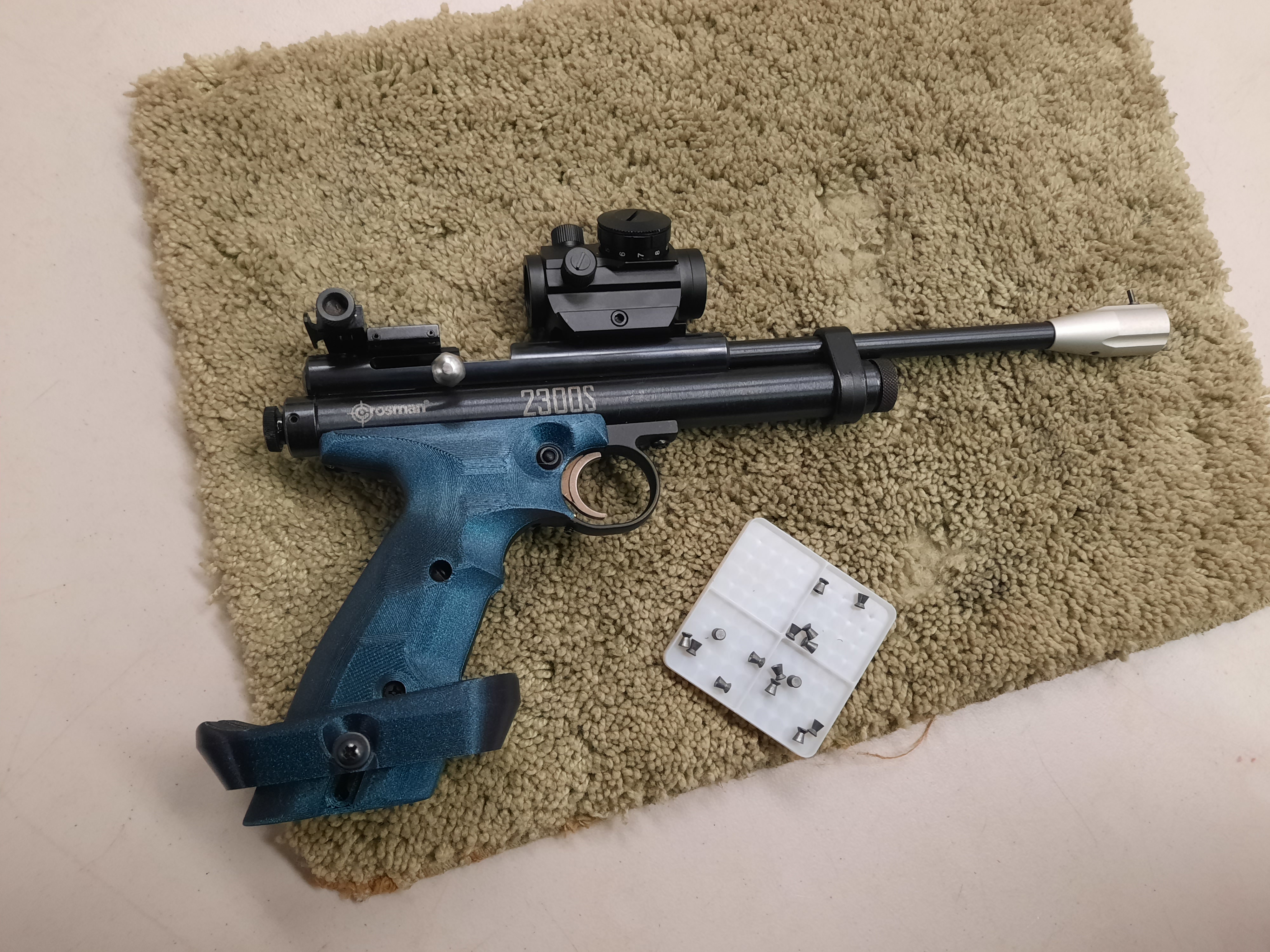

A pic of my 2300S just because no thread should go without eye candy. :)
