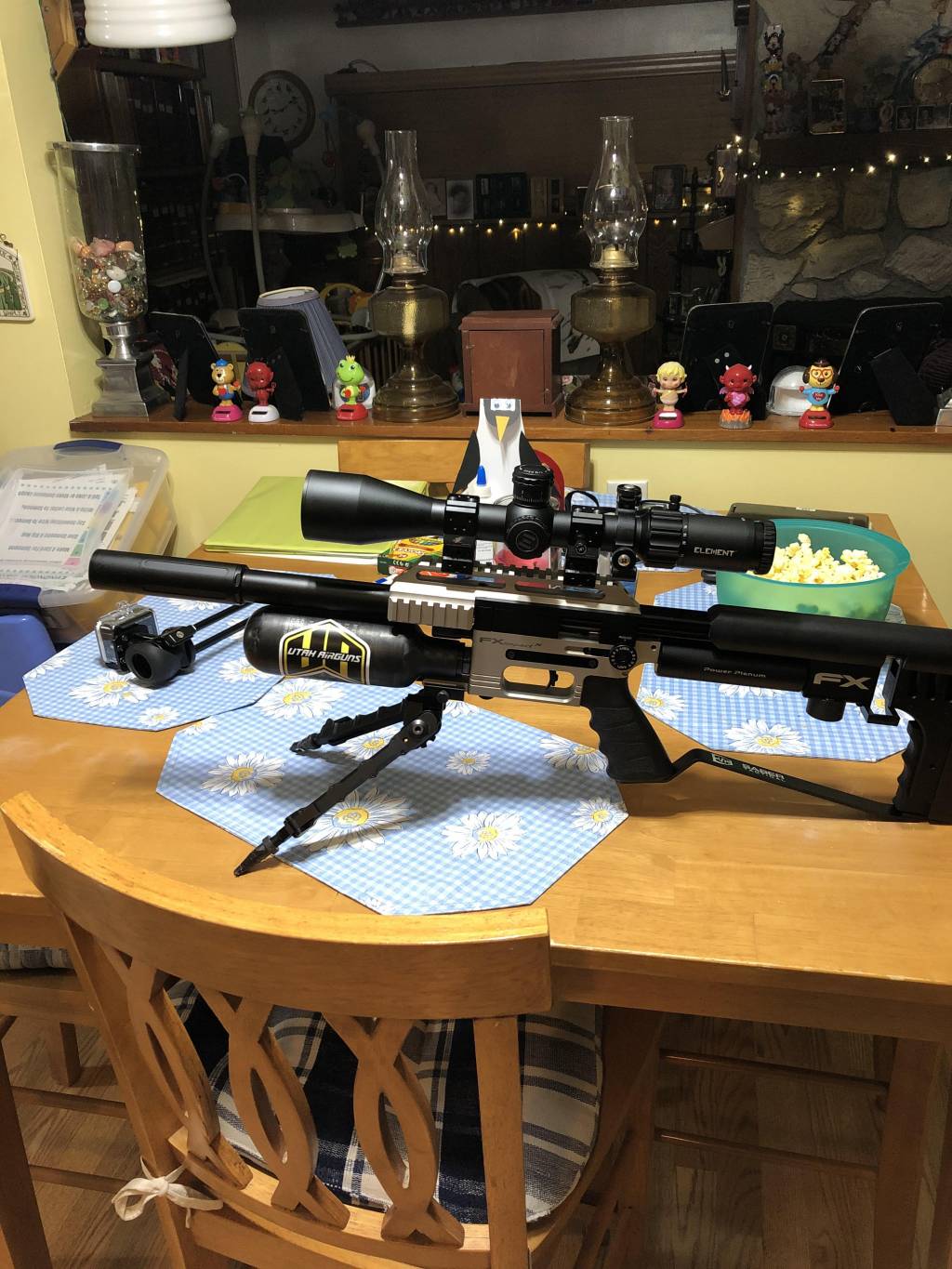

I'm looking for a light scope for my Impact compact. I had a Vortex Strike Eagle 5-25x56 on it but it was way too heavy for it and move it over to my Uragan King. I'm looking for something that has a range of 3-18 ffp or greater zoom.
what’s your intended application? Target shooting? Hunting? What distance range? How light? Minimum max zoom is 18? Do you dial or hold over?
Intended use is for hunting. Mostly spot and stalk hunting and a little bit of ambush hunting. Shooting range would be 25 - 100 yards. 3x minimum with a max zoom of 18x or 5x-20x something in that zoom range with locking turret or/and zero stop. I tend to dial the range if given the opportunity. I Prefer the Christmas tree reticle that not to dirty/Clutter for hold over when I can’t dial. Light enough where I can spend a day hunting without me Complaining about carrying it.
