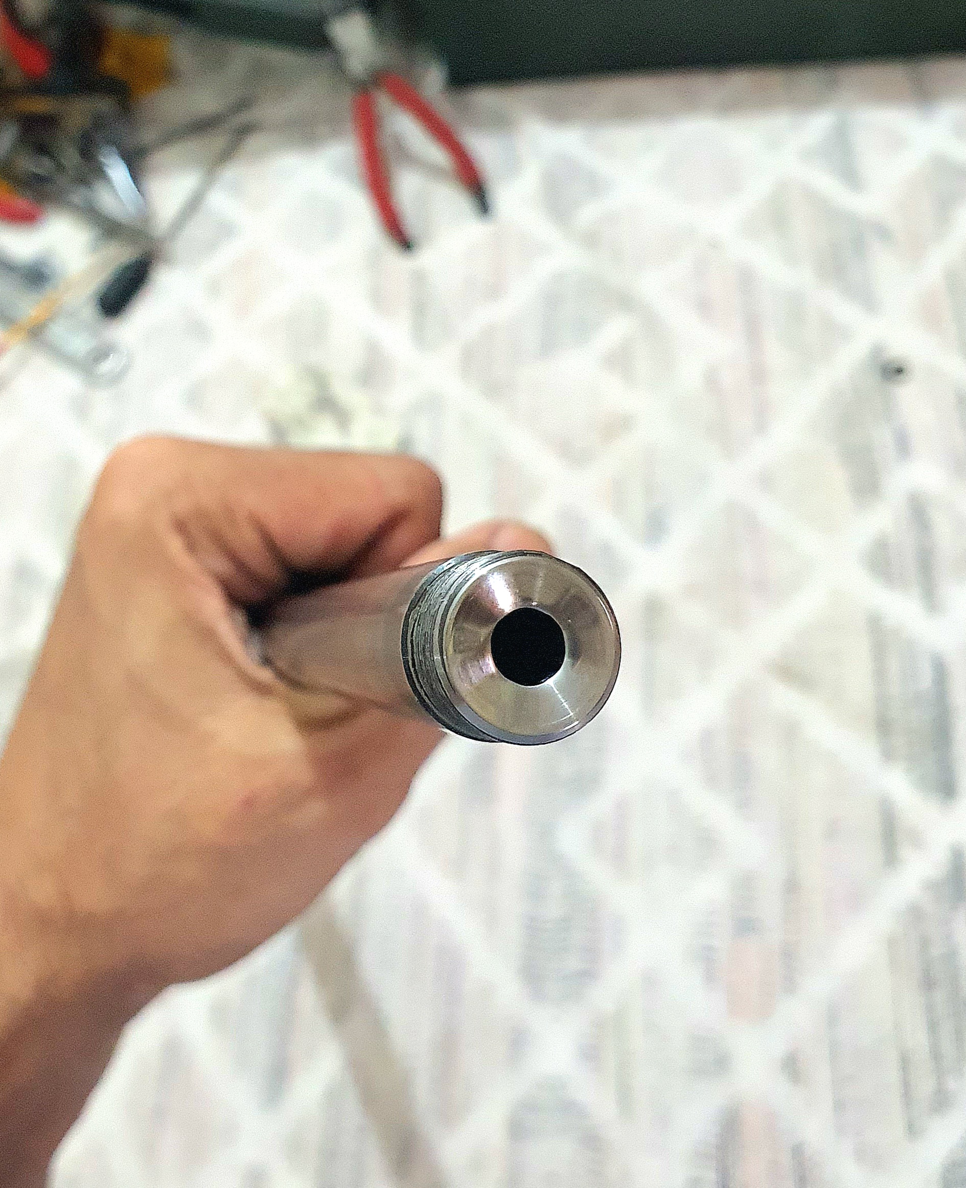

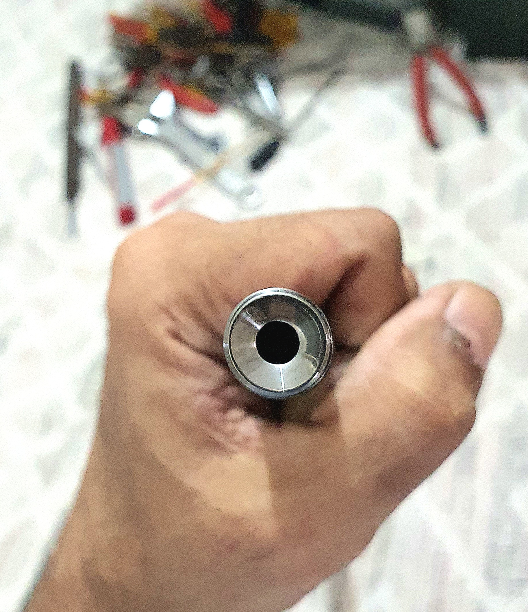

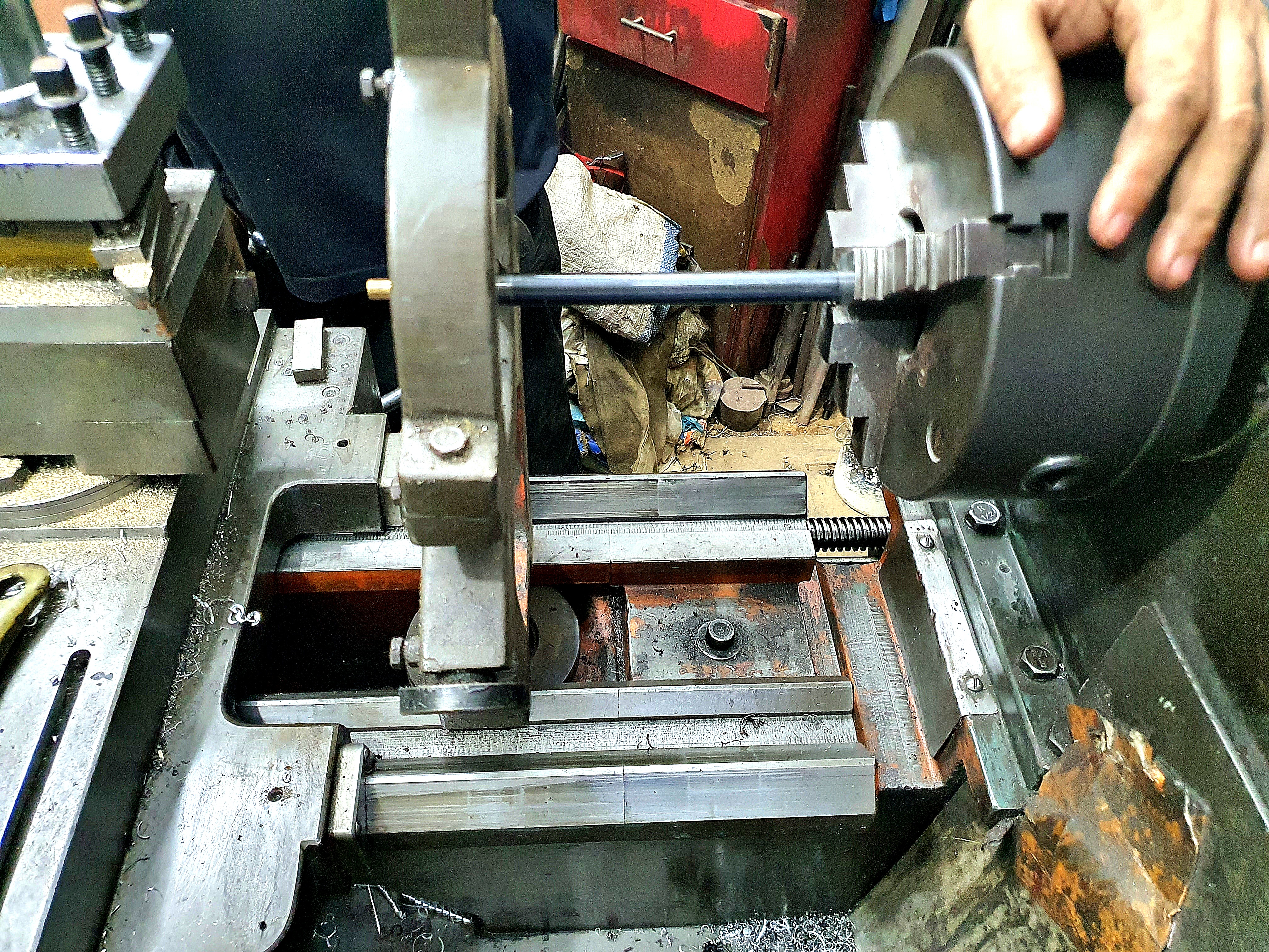

After a lot of efforts including modifications of shroud, barrel polishing, installing a barrel holder and now after re crowning the barrel and preparing the breech end, things seems to have been improved greatly.

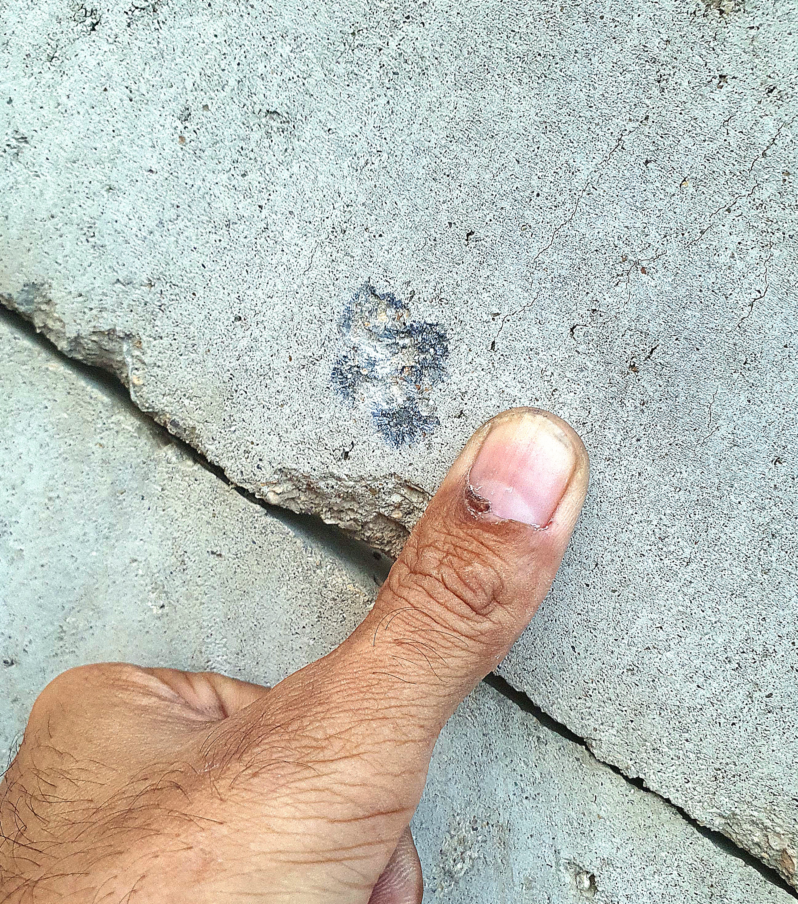

Here are pics of 10 shot 80 yards group .22 25 grain redesigned monster pellets at around d 920fps.
Also the pics of re crowning procedure.
I couldn't think that Daystate QC would skip the most important parts of the barrel i.e. Crown and breech.
