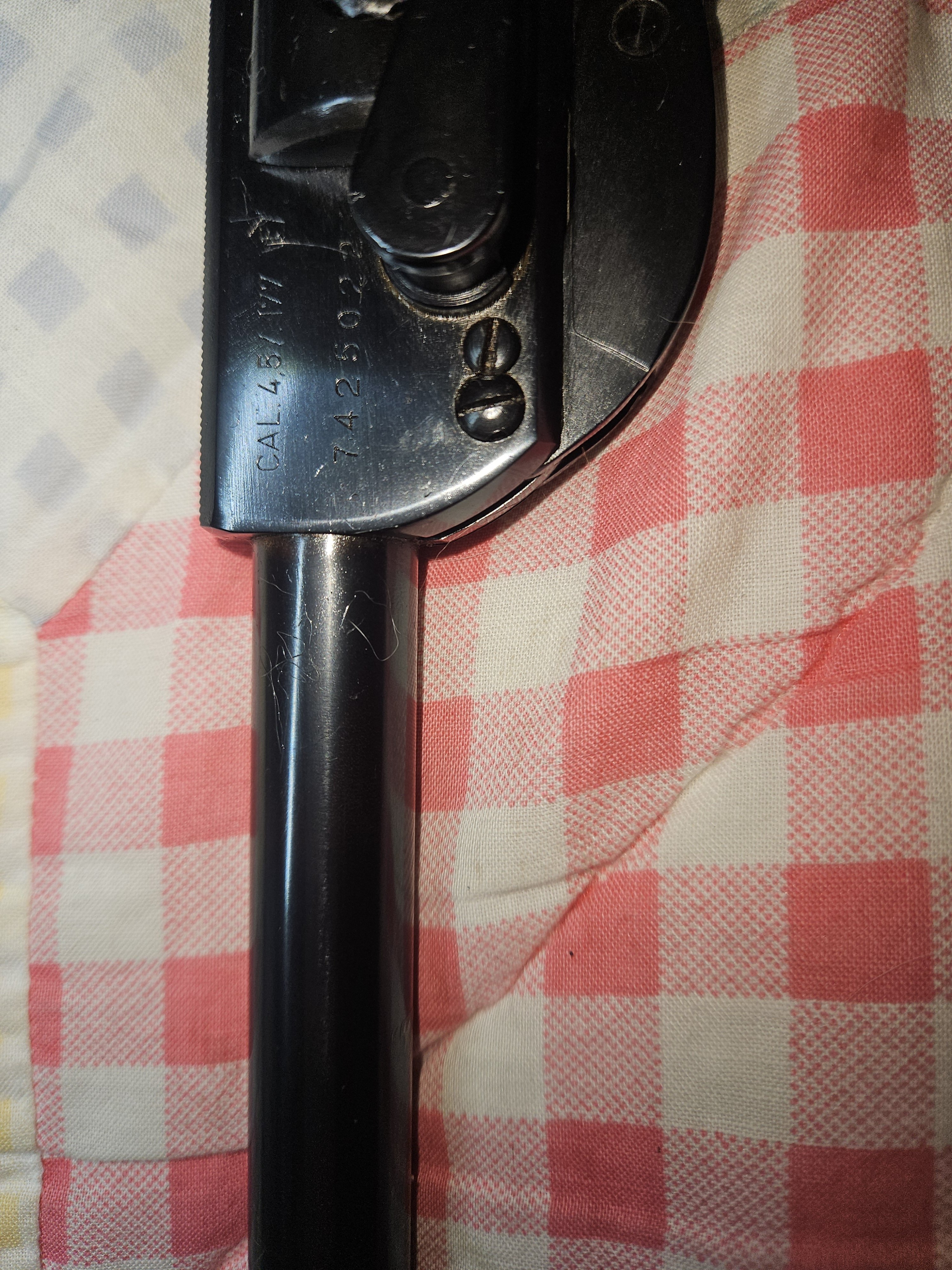

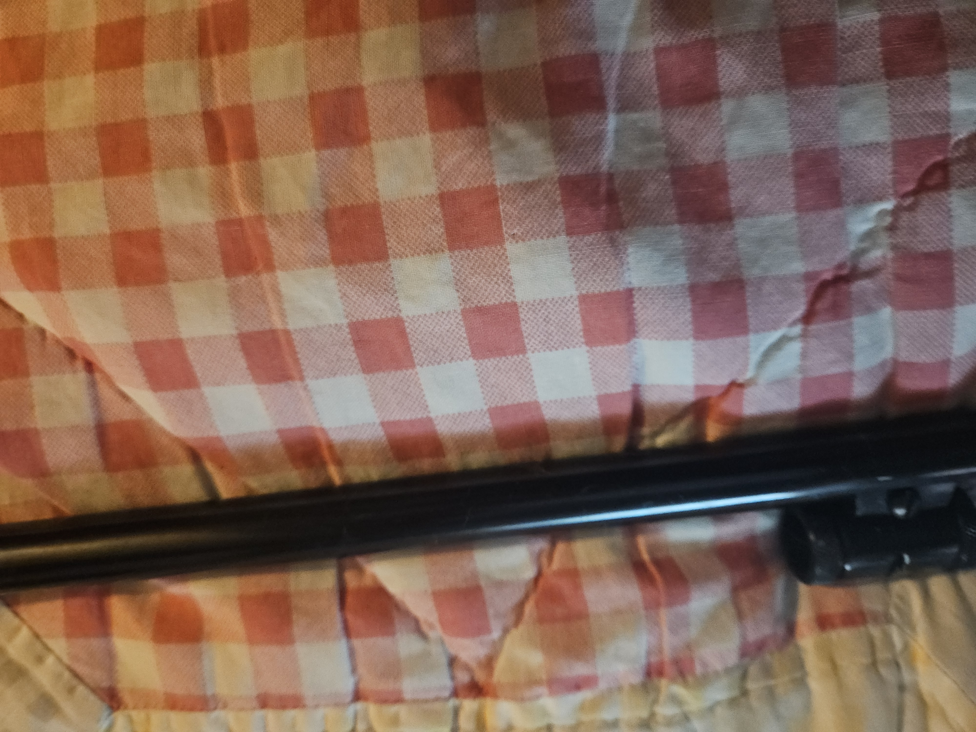

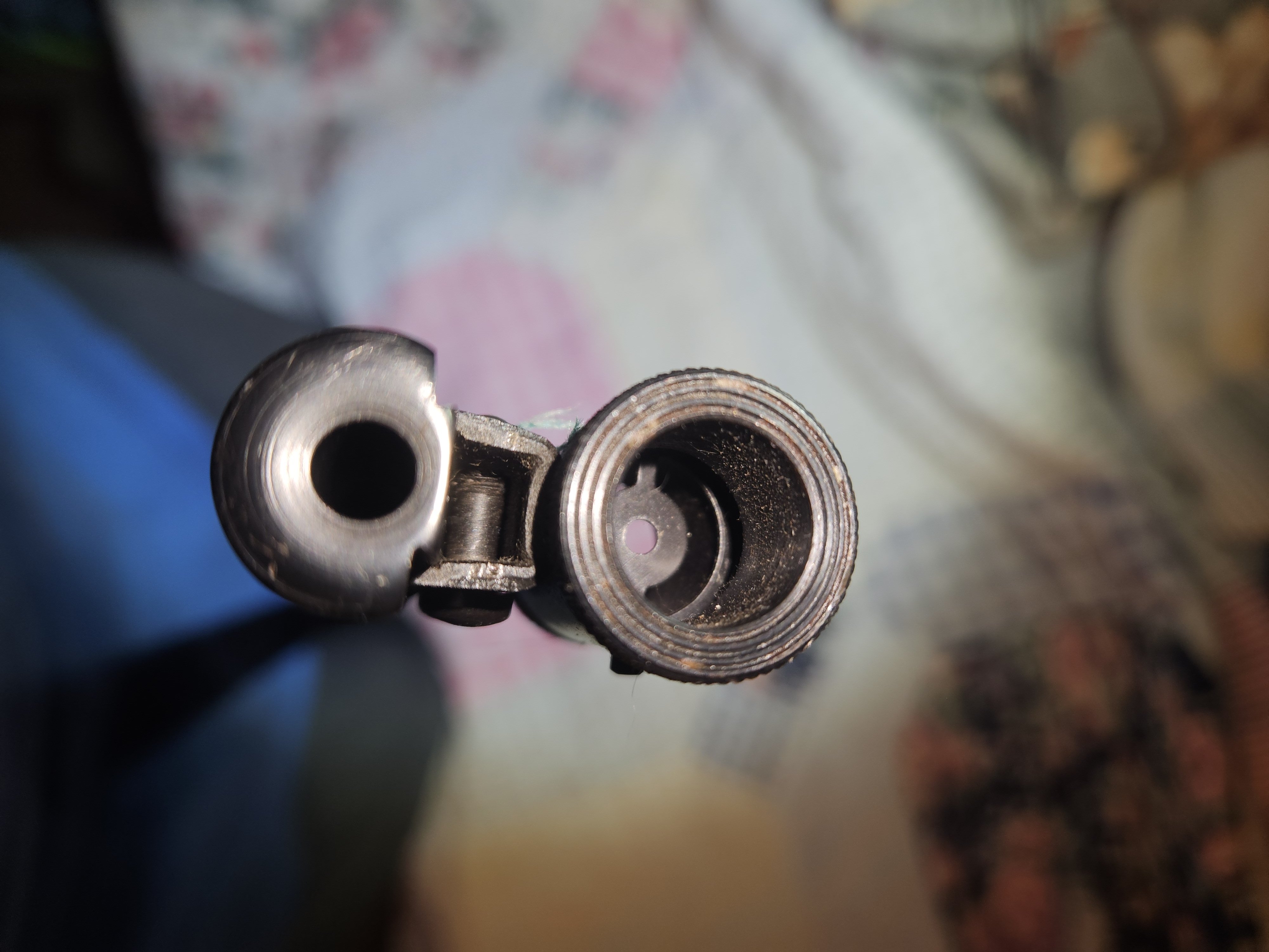

So recently bought a pretty nice condition diana 66 to go in my giss rifle collection, but.....when the rifle showed up, the barrel is stamped 4.5/.177 as one would expect, but a .177 pellet just fell right through the barrel when I went to load it. What does fit in there perfectly is a .22 pellet, and there is no rifling inside the bore......you read that right, it's now a .22 smoothbore! Please help me understand what reasoning someone would have had to do this? Dart gun for a club maybe? That's the only thing I can think of that makes sense. Or is there a possibility this was done by the factory for some reason? I'm pretty upset, as this was not disclosed when I bought the rifle. Am thinking of returning it, which sucks because I love the rifle otherwise....but if I kept it the odds of me finding a good barrel are about as good as getting struck by lightning I'm thinking🤣 any info or opinions on this strange rifle would be greatly appreciated, thanks!

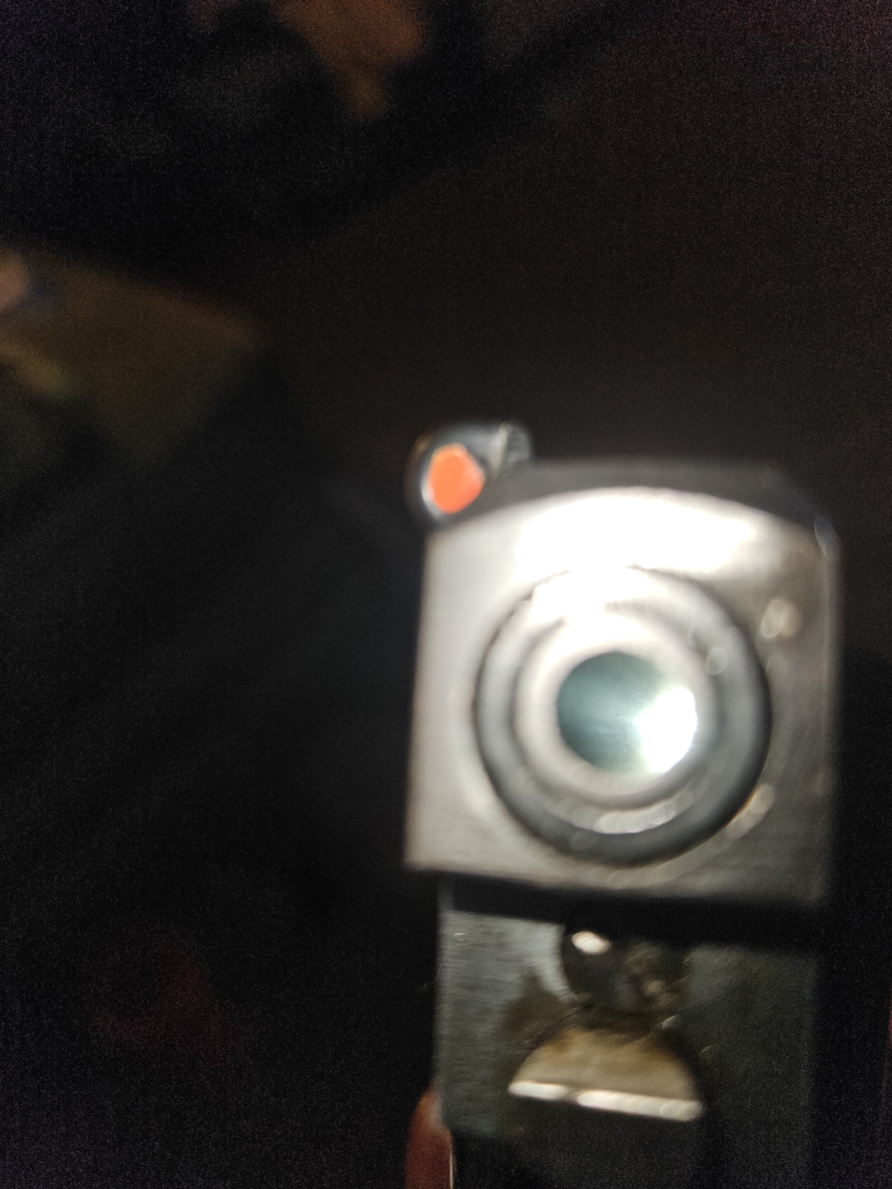

If bore views as VERY smooth viewed via / under a strong bore light ? It likely was a factory set up as DRILLING can in no way replicate a factory smooth bores finish or consistency.

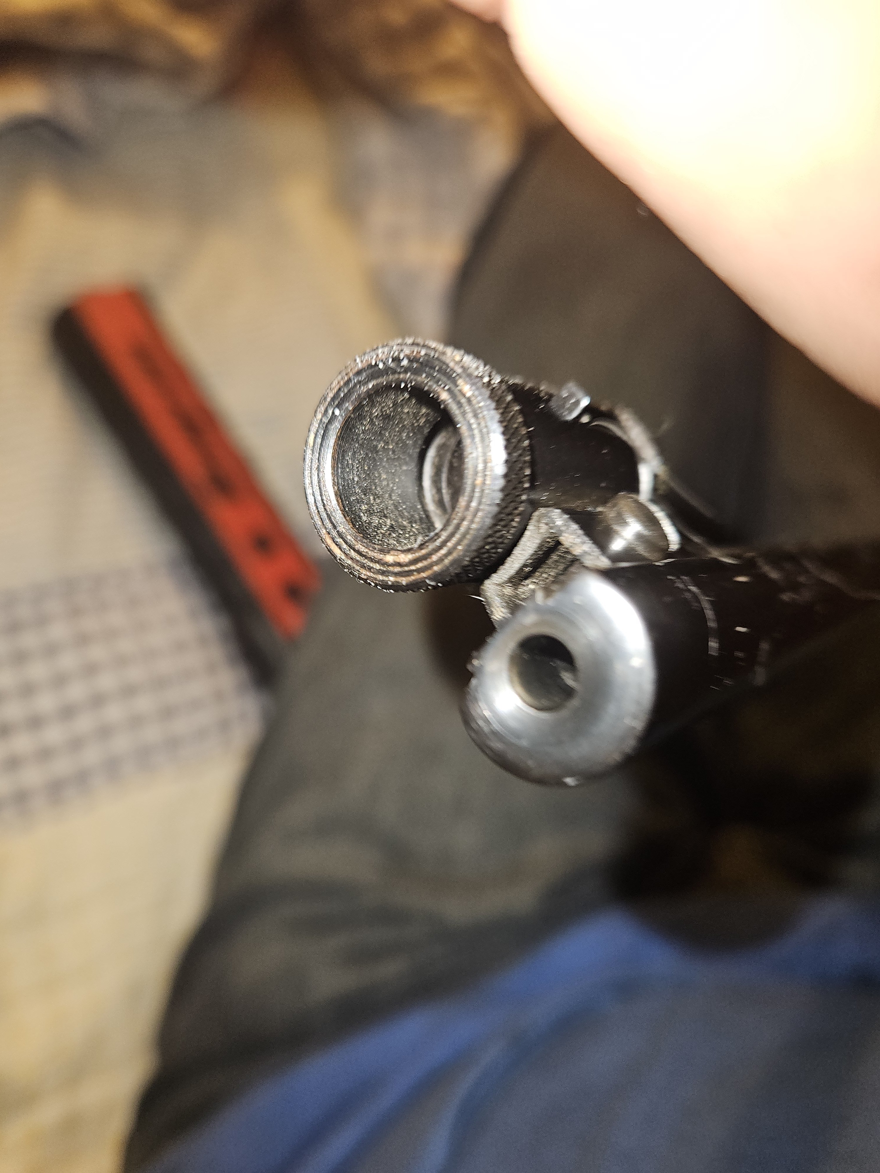

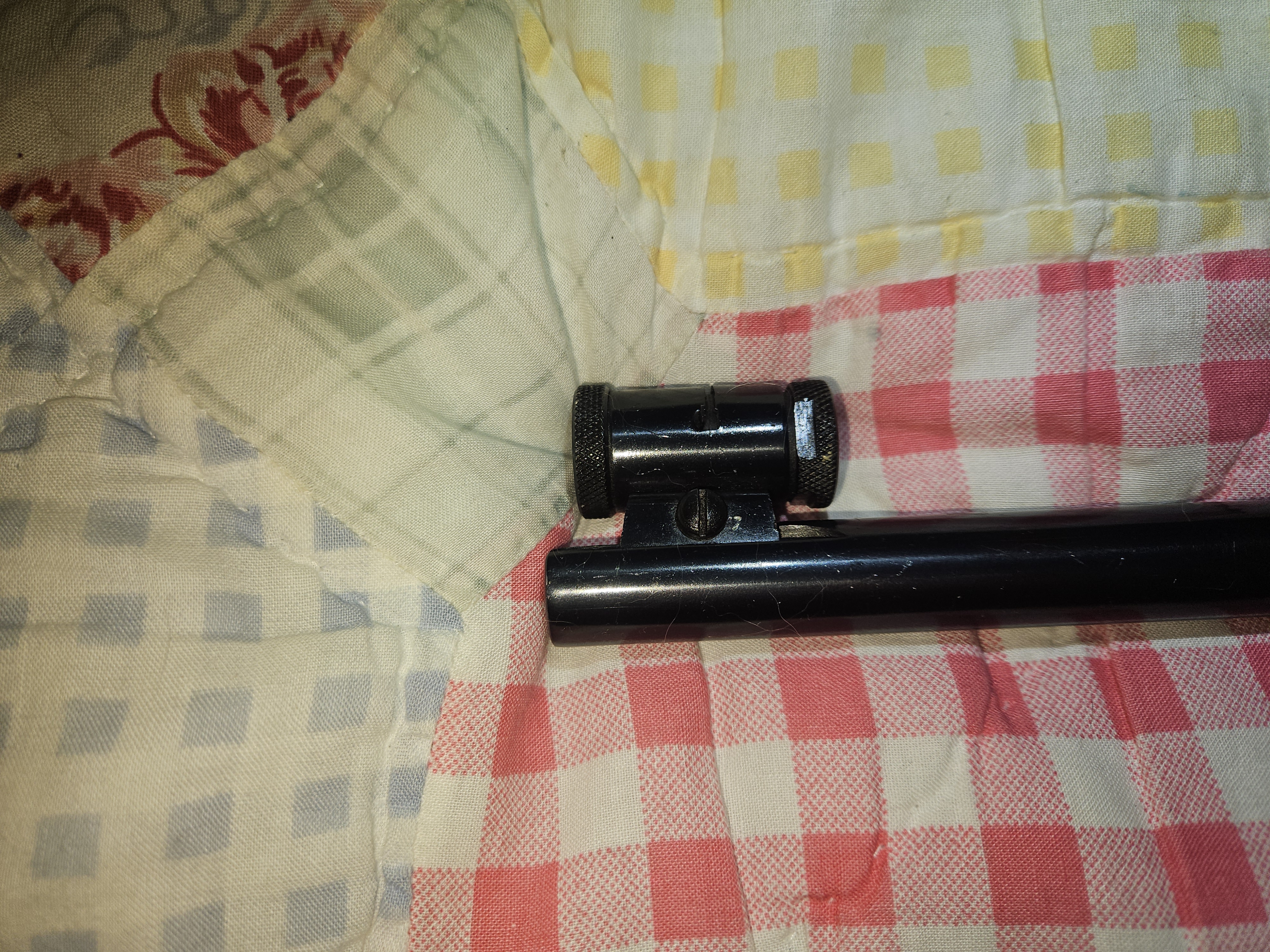

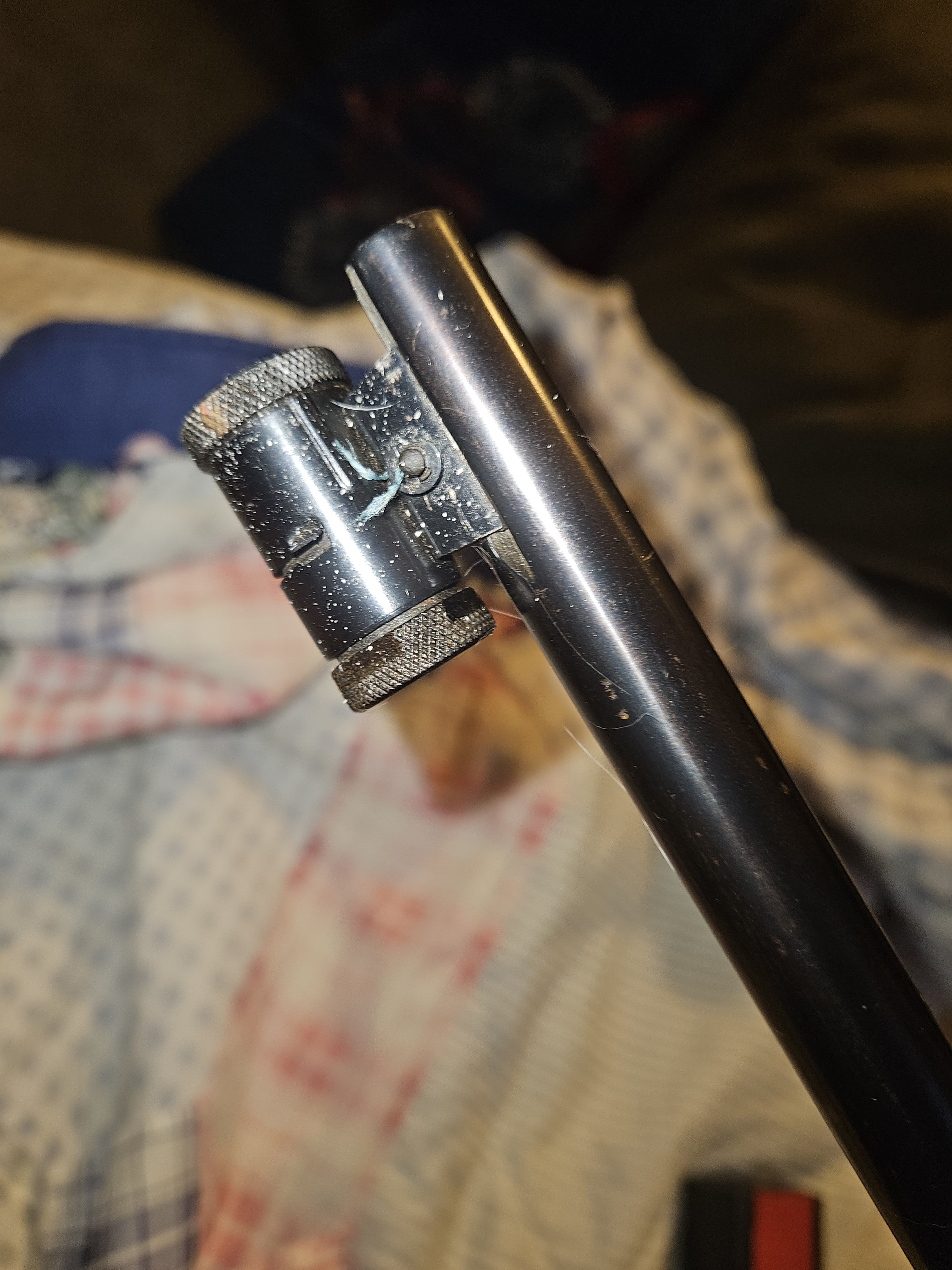

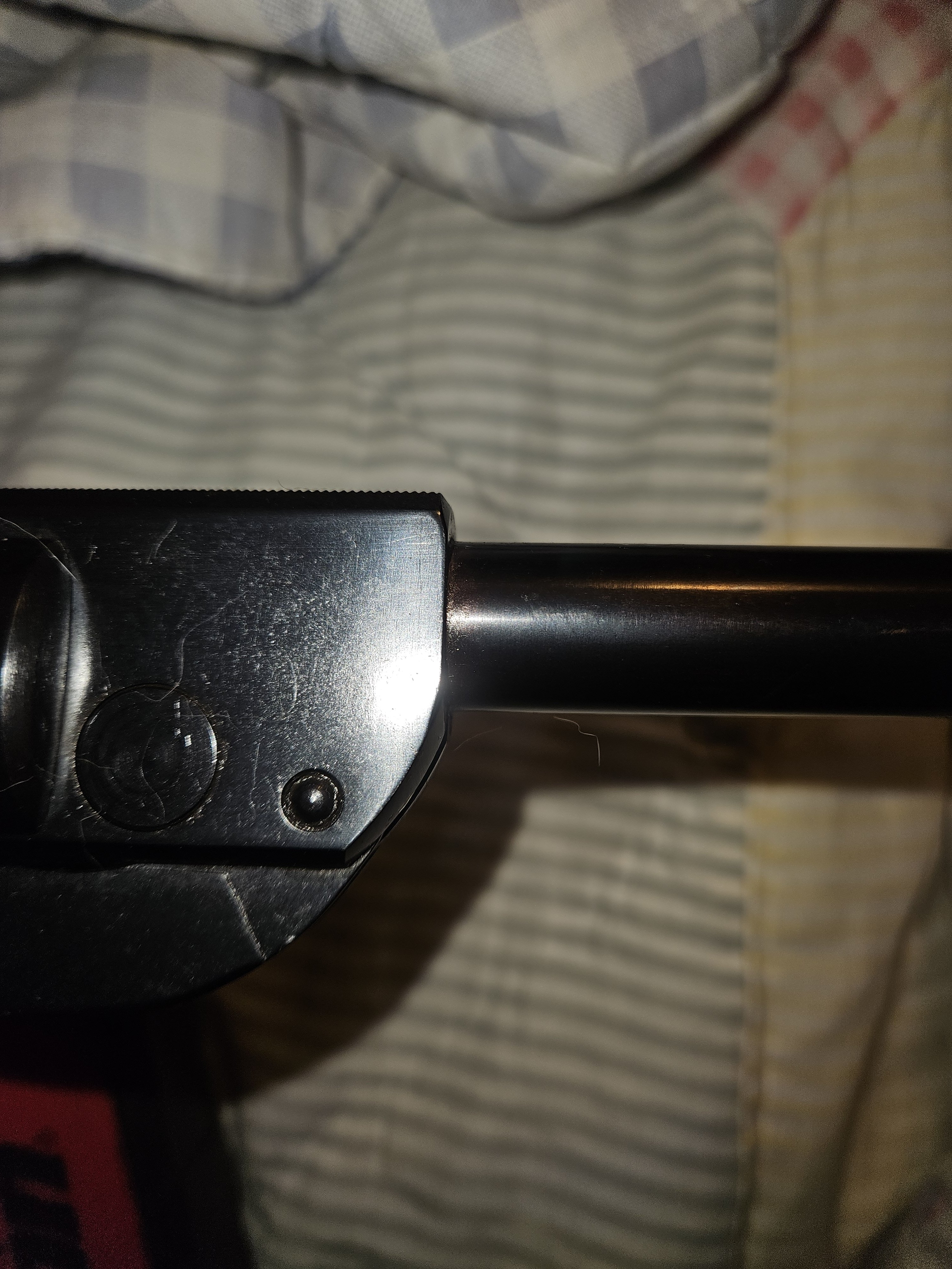

It's like a mirror in there. The other strange thing is this rifle has no barrel sleeve, there is no evidence of it ever having one, no milled step for it to sit on, no threads at the end of the barrel, and it does not look to be cut and crowned. It's a VERY strange rifle!
Good tip though! I didn't even think about the fact that it would never be as smooth as a factory smooth bore....I do have a old jung roland german smoothbore I just compared it to, and the bores look IDENTICAL! Any guesses what the reasoning behind this rifle could be? The rifle dates fron 1974 if that helps in any way.
The only guess I could make is that it was rebarreled for use as an indoor dart rifle.

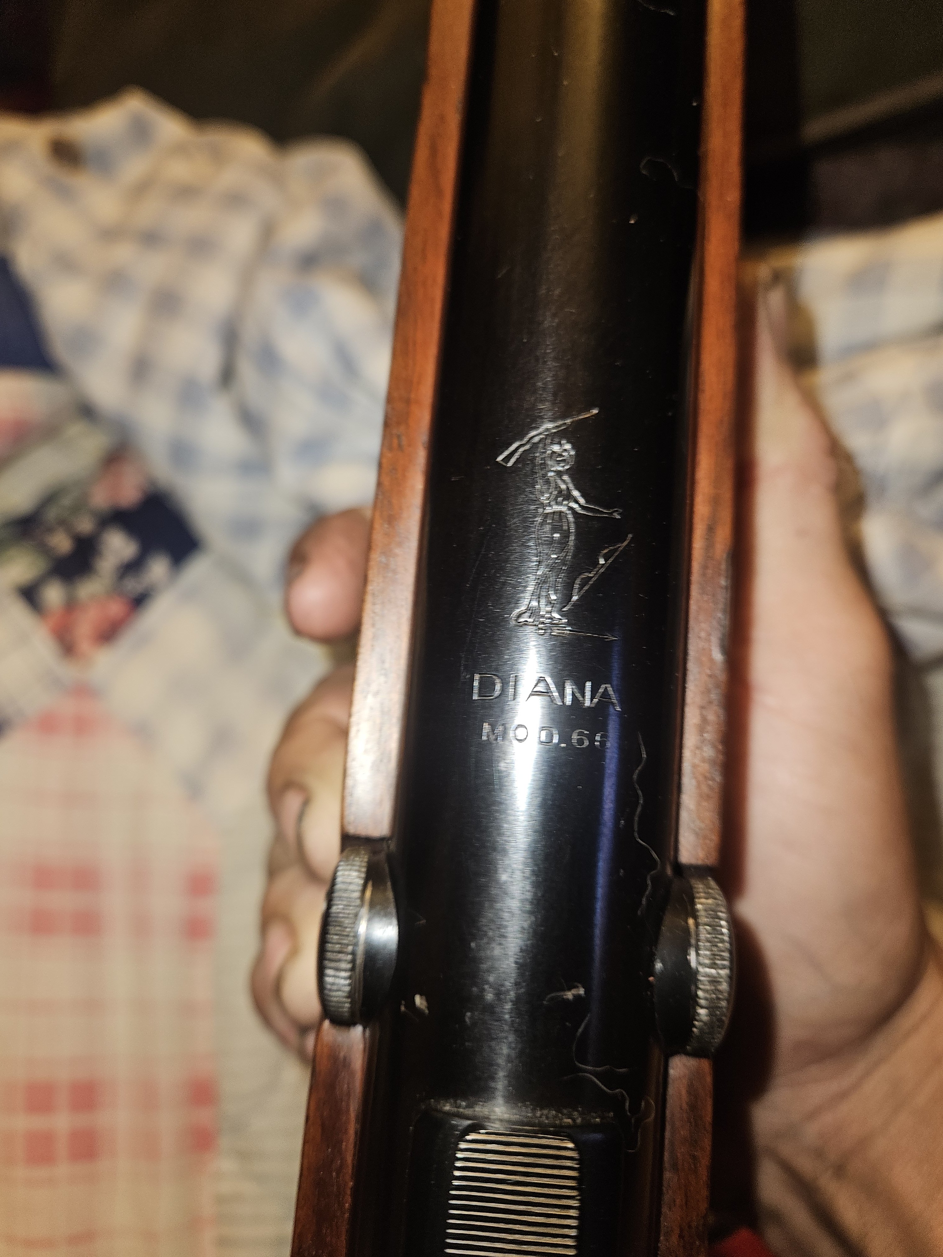

Well...I shoulda read Hector Medina's note that Chuck linked above before my previous post! Hector has a model 65 Tyro with a .22 smoothbore Weihrauch barrel, that was indeed made for dart shooting. So your gun is NOT a one-off.
Factory or not, if it's pro-quality work ya gotta admit it's VERY interesting! You could even argue that it gave a legit second life to a rifle that was considered obsolete for top-level 10-meter matches. My guess it was a post-factory conversion (otherwise, as BABz58 noted, there would be a corresponding breech marking).
Figure out what darts it likes and you have a winner.
No doubt it is a rare rifle that was done for a specific purpose. It may not be what you expected but it may be really rare and special too.
I've spoken with Hector and he seems like a guy who is willing and able to share knowledge. He is VERY articulate and an expert in his field. I'd contact him about it. If it says "DIANA" on the side he knows the story. You just might have a very unique rifle.

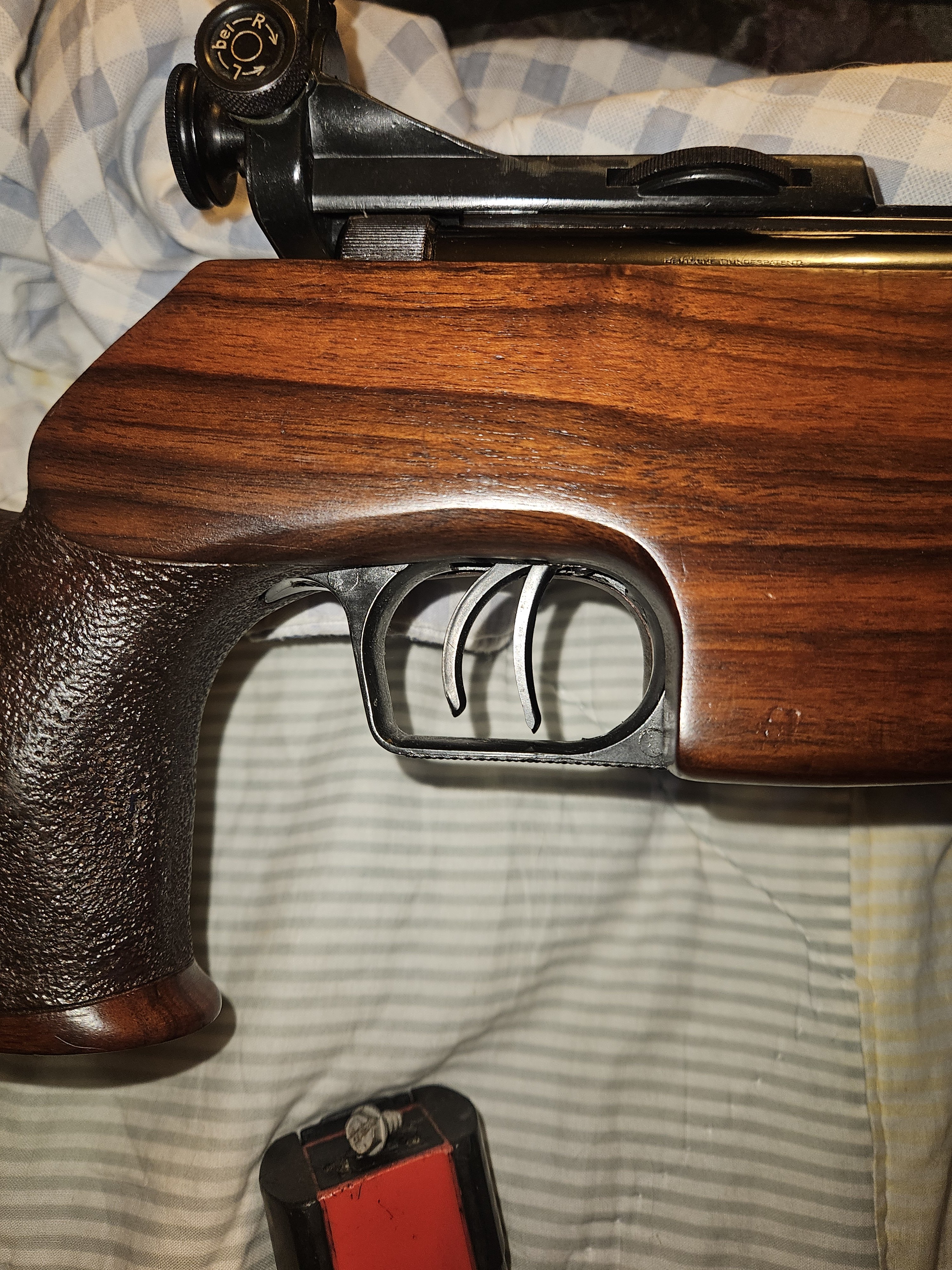

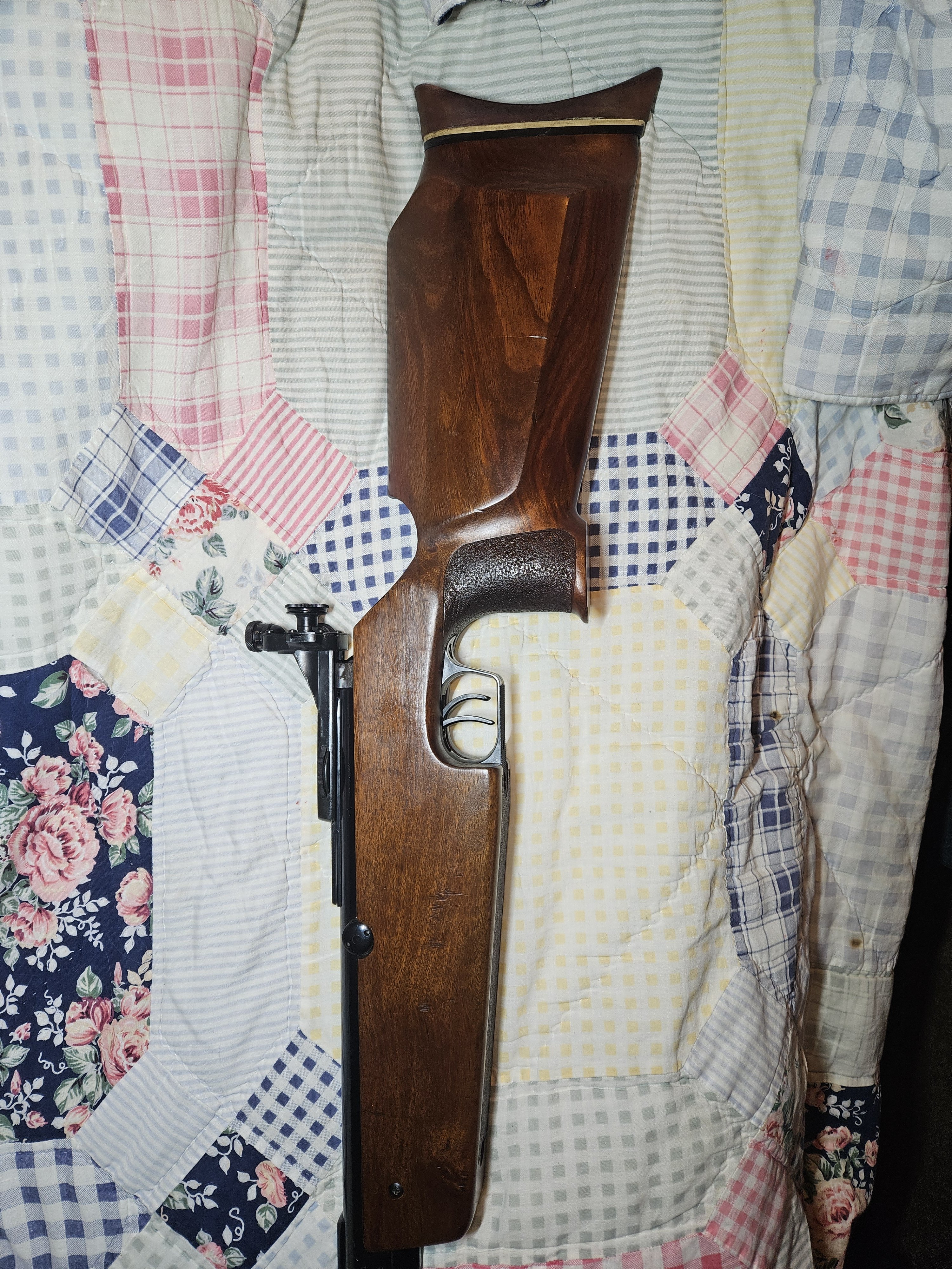

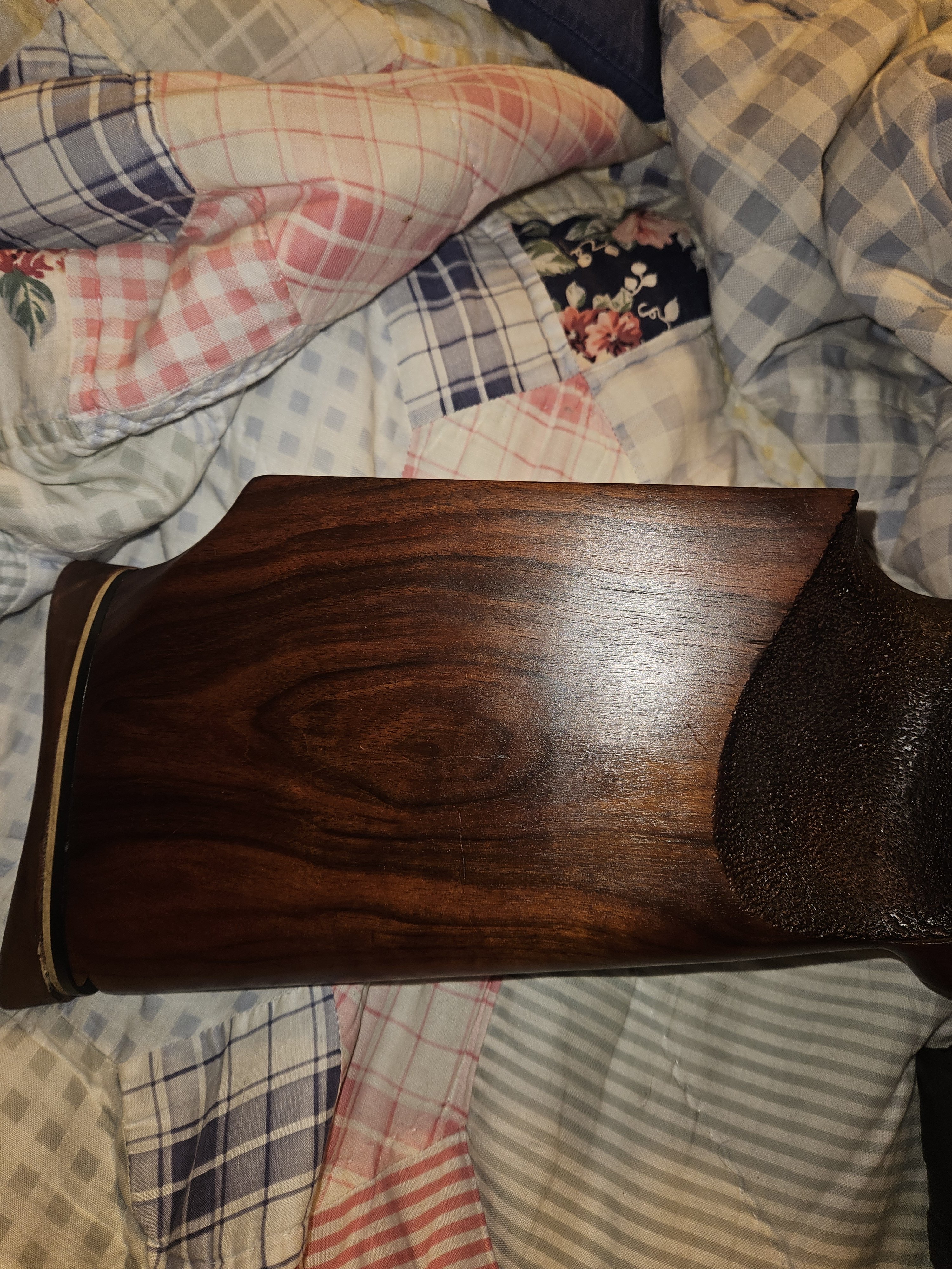

Sorry for horrible pics.....I'm terrible with a camera!🤣 it's a very odd rifle indeed! I'll probably keep it because I really like the grain pattern, and it's just a very unique....well thing, that's what it is!🤣 I am going to contact the seller and see if I can get a partial refund on it, but if I cant.....I still got it cheap enough to keep it, and the rifle mist have been resealed because she shoots pretty hard for a giss rifle. Appreciate the info fellas!
