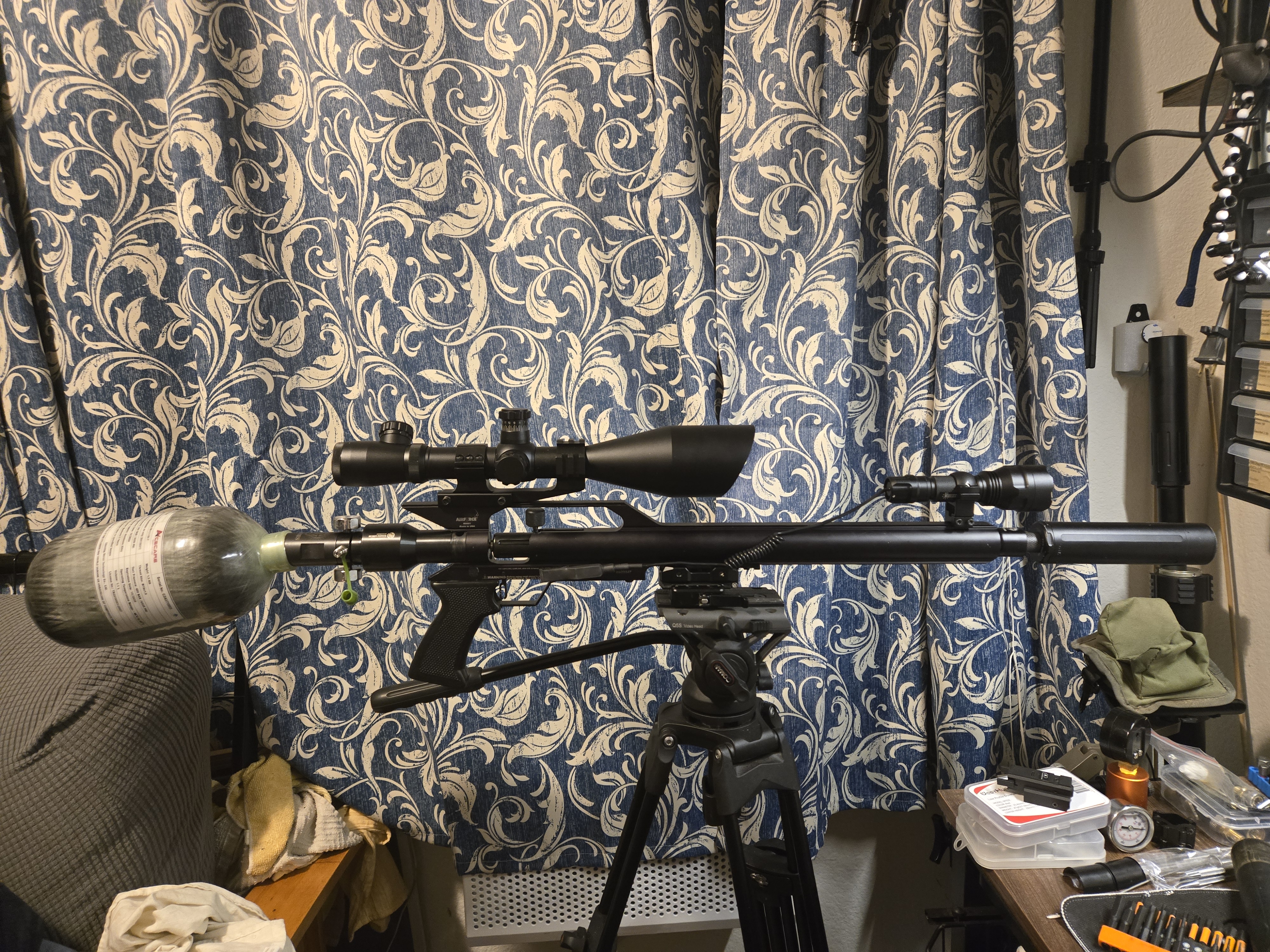

None stock as far as I know. But very easy to do. Take the valve off the bottle, insert regulator. M18-1.5 threads so Huben Power Dream Universal drop block or the Cricket Max-ATH just plug right in. Bigger bottle, just screws on on. Want to go from .177 to .25, sure, barrel change is 5 minutes. Want to jack up the power? High flow valve, heavy spring, heavy hammer, 15 minutes. How big a tank and how much power are yours to decide.
My .22 Talon with 1.1L bottle, Max-ATH regulator.
Internal: 90g hammer, heavy spring, 19 inch barrel.
When i cranked the regulator up to 3000psi, the power wheel to 10 with the heavy hammer and spring I got 1100FPS and around 70FPE with 25.4gr .22 Apolo Monster pellets. Which is double what I got with the stock 12 inch barrel, hammer and spring.
Now I run at 1800psi and get 40FPE and hundreds of shots per fill. 50CC plenum on the Max-ATH is a great addition.
