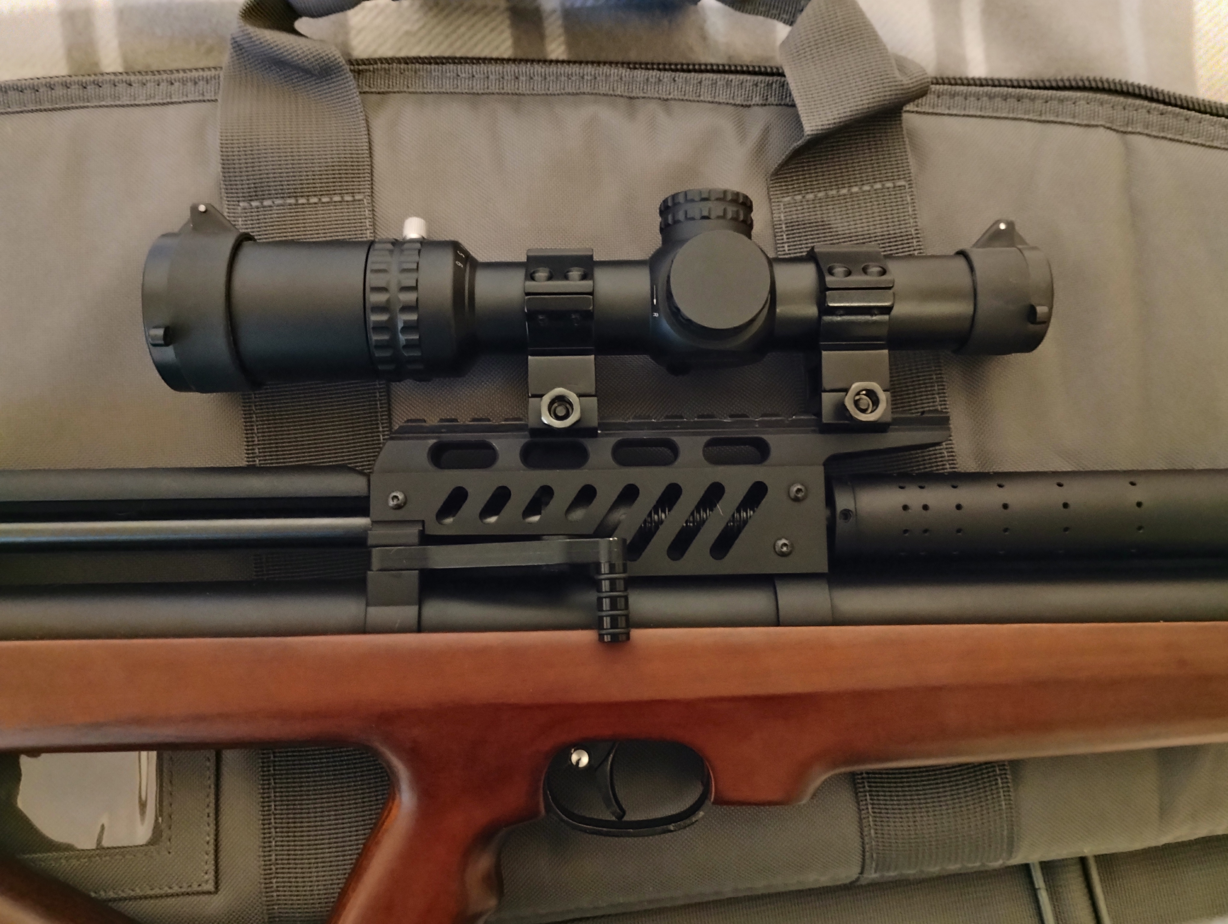

Nobody likes a headache. I have been in contact with Troy @ BigAirPrecision.com to make 14 Rd mags for this gun. A little patience. My gun has 4 screws holding the scope rail, someone was asleep at the wheel that day. So you should either get an exchange or a refund. The big question is how does it shoot?
My Picatinny rail is held by 2 screws in the front and 1 in the rear, all 3 screws are stripped.

My rail had WAY too much “compensation” built in. With my scope elevation cranked all the way down I was still 4 MOA high at 50 yards. I flipped the rail end and to my surprise there were holes lining up for the rail in this configuration as well but now two in the back and one in the front. I gained enough rise to zero at 50 by coming up about 8 MOA in the scope. You might try flipping that rail and see if you can use the other sets of tapped holes.

I stripped them threads too. Lol.
I remember sinking the bolt stems deeper as the first fix. It was funny that there was a lot of room on the top part. I just drilled a suitable hole some millimeters deeper, enough for the bolts to hold. So not a proper flat surface 😅
After that I have been careful.
I guess the bolts could be enlarged quite easily.

The rear screw has a very shallow hole.
How would you fix that?
I suppose the thread depth should be measured and find something that fits, and only if there is some useful thread left.
If not, I would go for the next thread up in size. Some machining but all in all simple and satisfying. Aluminium is very easy to work on.
If You go that route, it's about one dollar worth of bolts, two dollars a tap and a dollar for a drill bit of Your choosing to sink the bolt stem.

Mine so far has behaved well in relation to leakage, there has been no change, in relation to the rail I realized that the scope was loose and I tightened the mounts more and apparently it solved, I bought some slugs of the Zan and Hn brand of various weights and pellets of the Jts brand of 16 and 18, I have Jsb of 18 and some Hn models, barracuda, field etc... tomorrow I'm wanting to test it, but I'm in doubt because I bought a plenum for P15 from a seller in England on Ebay and I hope it fits in it but it will arrive next week, so I'll do a test before and after the plenum.
