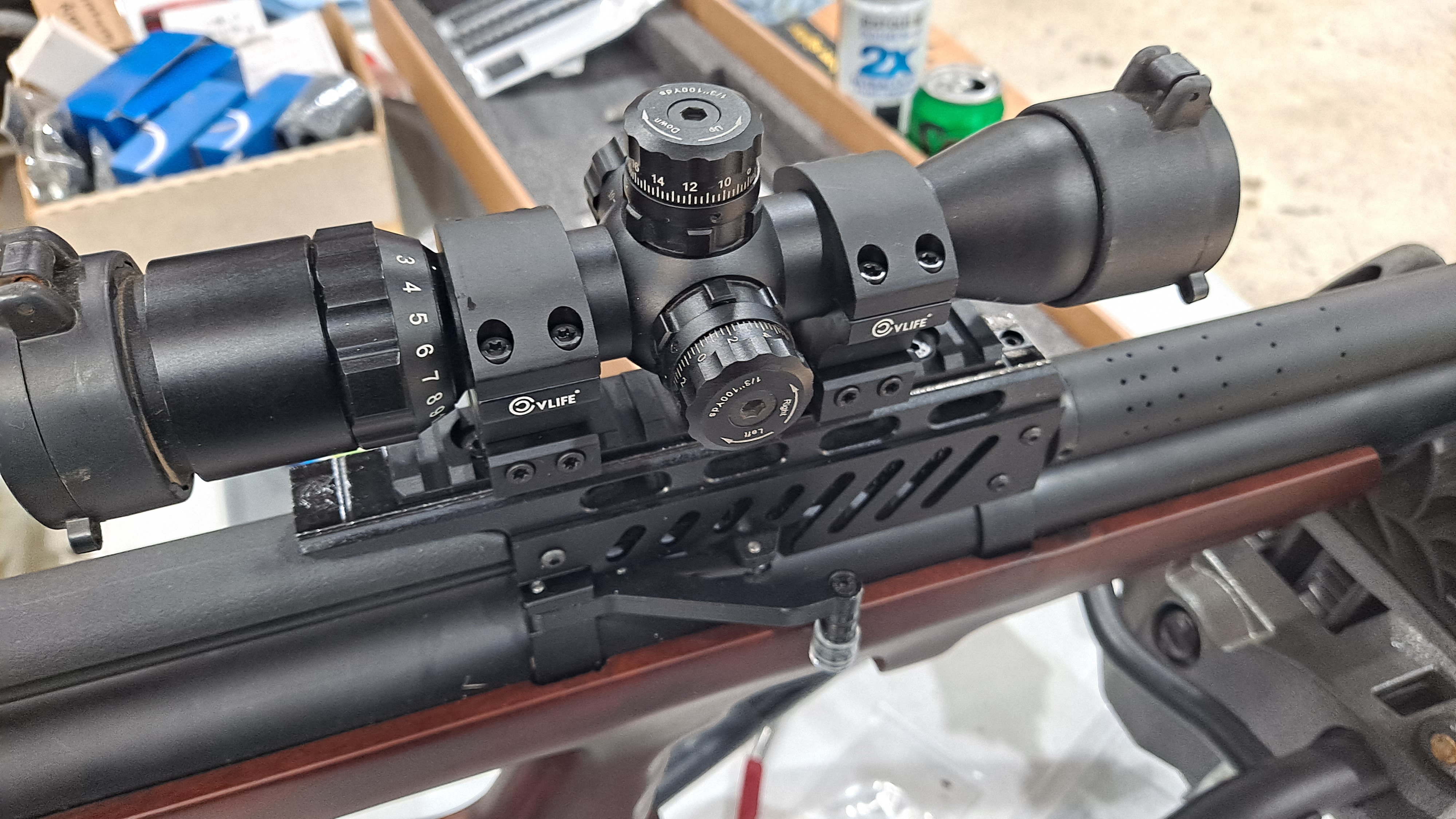

Well, I took the money. I centered up the original scope rail in the Bridgeport and machined the original 19mm picatinney rail off. Drilled and tapped it and mounted an aluminum picatinney rail. Virtually perfect. I'm going to like this gun.
One magazine and it was sighted in, 22 yards, all pellets touching.
I'll extend out to 50 plus tomorrow.
Well, I took the money. I centered up the original scope rail in the Bridgeport and machined the original 19mm picatinney rail off. Drilled and clapped it and mounted an aluminum picatinney rail. Virtually perfect. I'm going to like this gun.

I have also left the cap on the cocking lever. I like the feel of it. Also just measured my rails and seem to be 20mm at the widest point. I ordered this scope from amazon that comes with quick detach rails and they seem to fit just fine. https://a.co/d/63RVr7l
