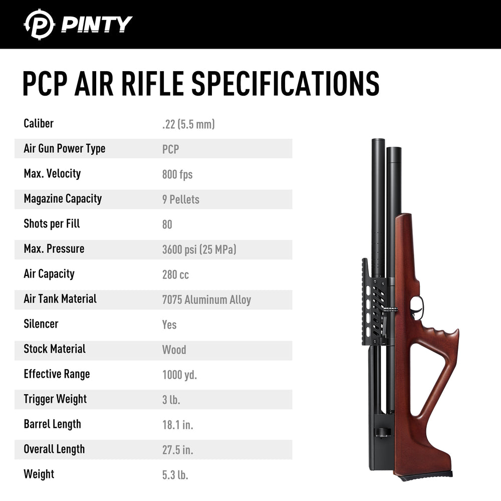

is that bulpup regulated?
It is regulated.
It seems to be a Snowpeak P35 with some small changes.
This is the importer page for the airgun:
Reactions: SpindleB
It is regulated.
