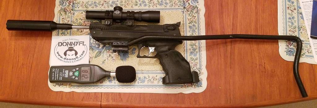

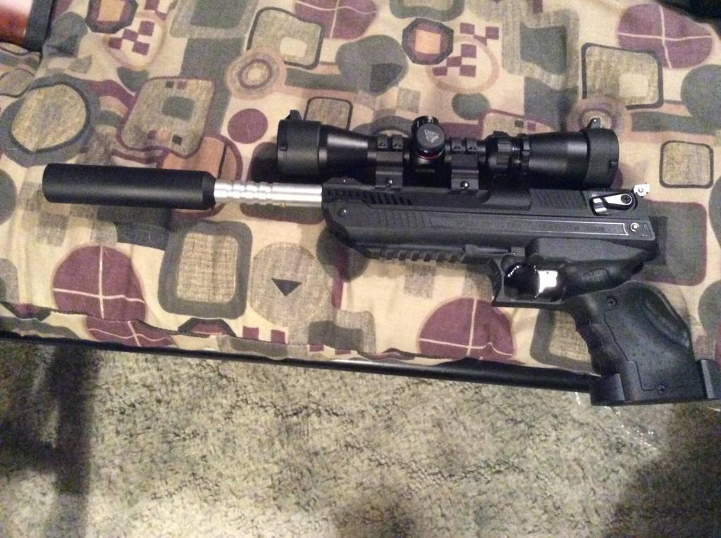

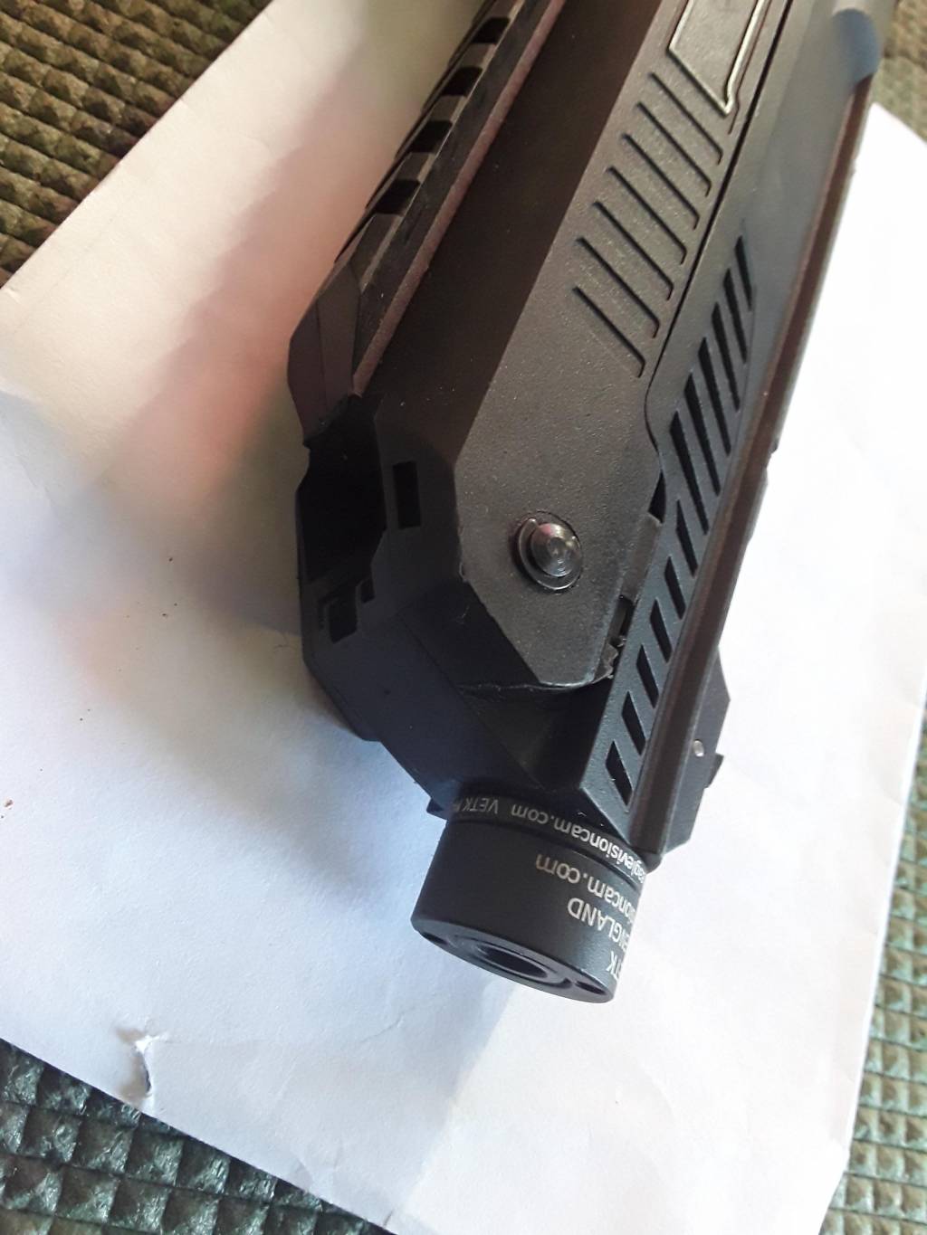

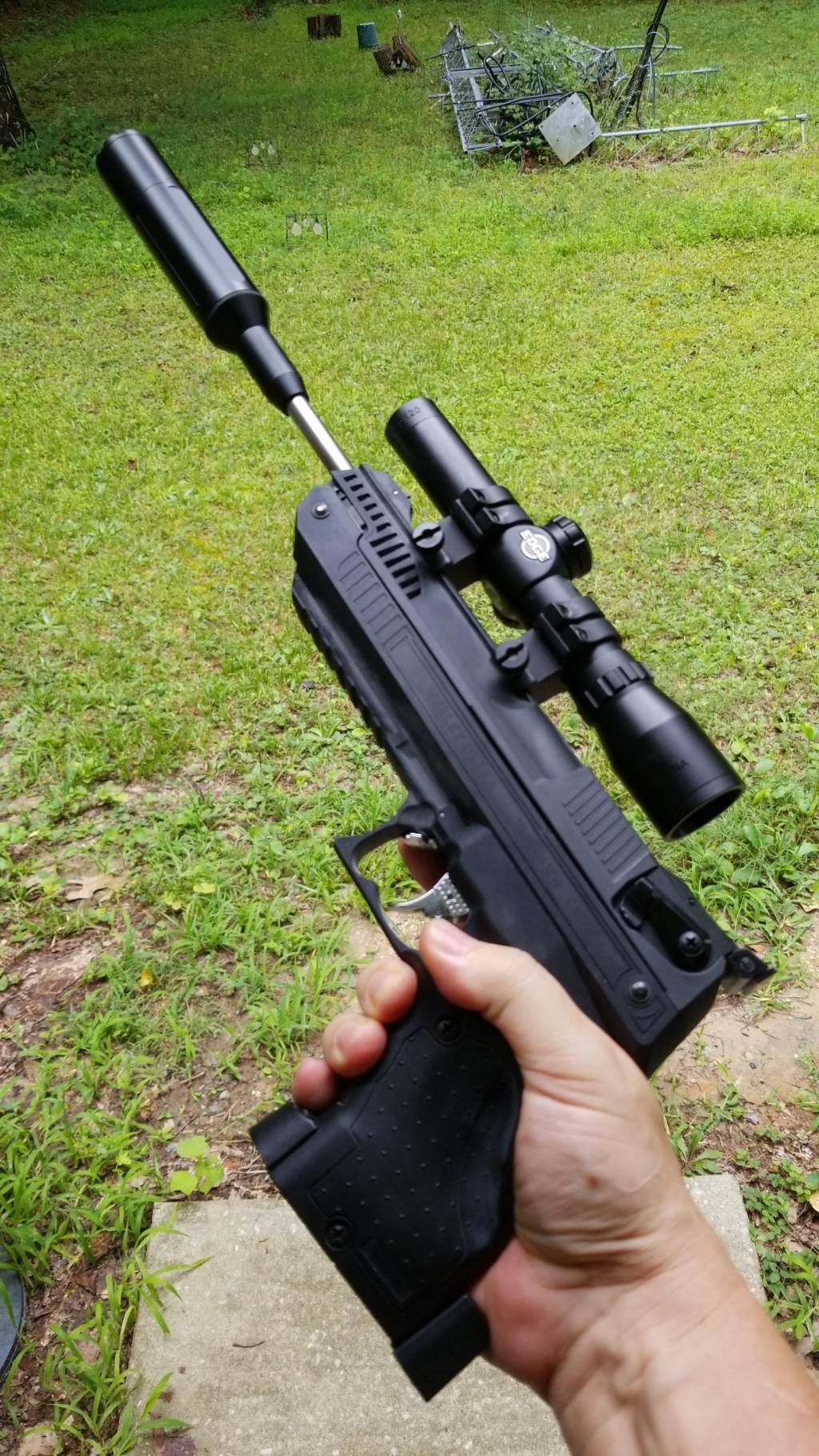

I have a Webley Alecto Ultra (Zoracki) in 177. I have lamented the disappearance from the US market. With just a little refinement, I think this would be an awesome pistol. Self contained and accurate, it can be used with one to four pumps, and has plenty of power for small game. Rabbits don't need much power for head shots. They are loud though.

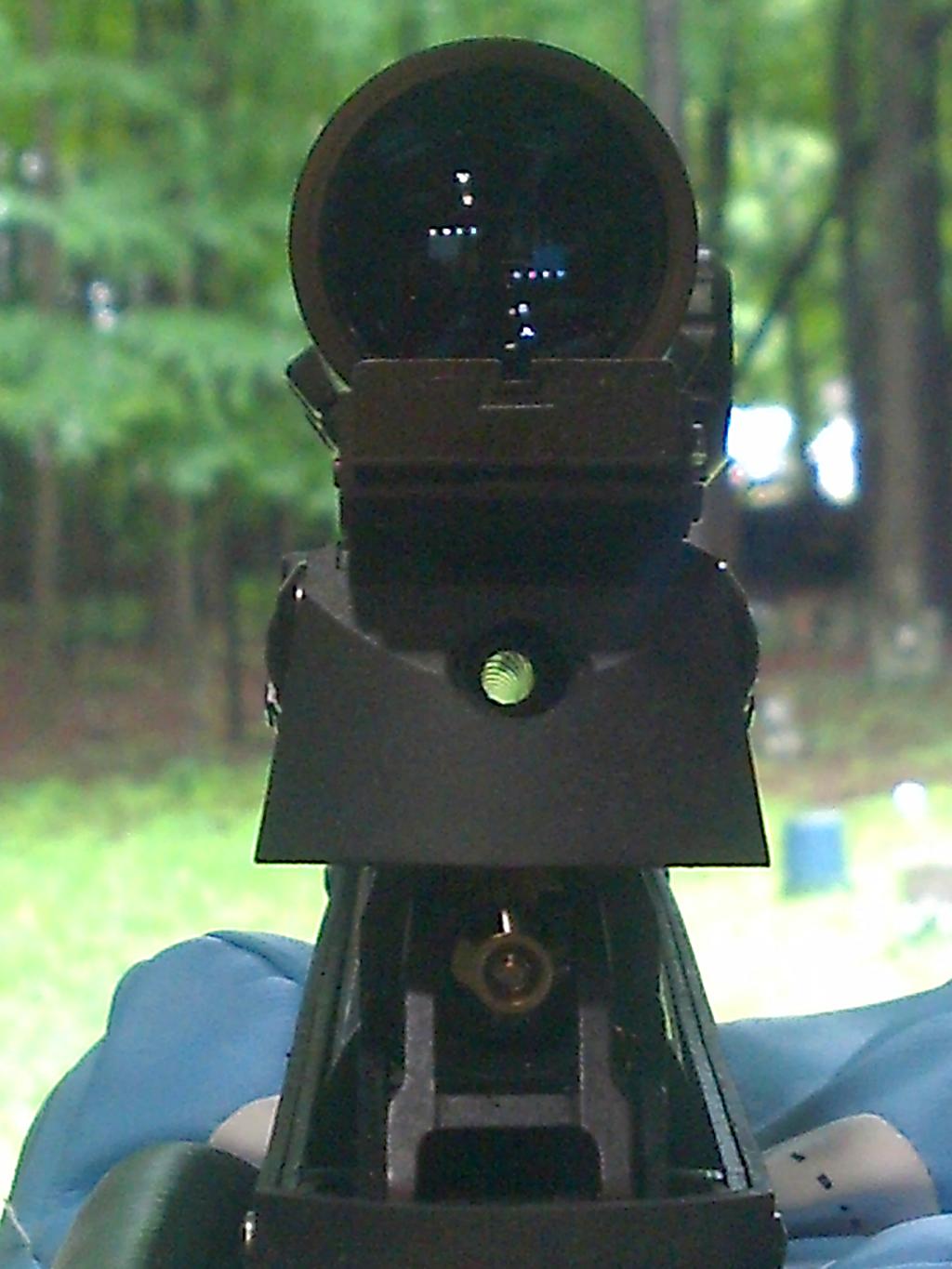

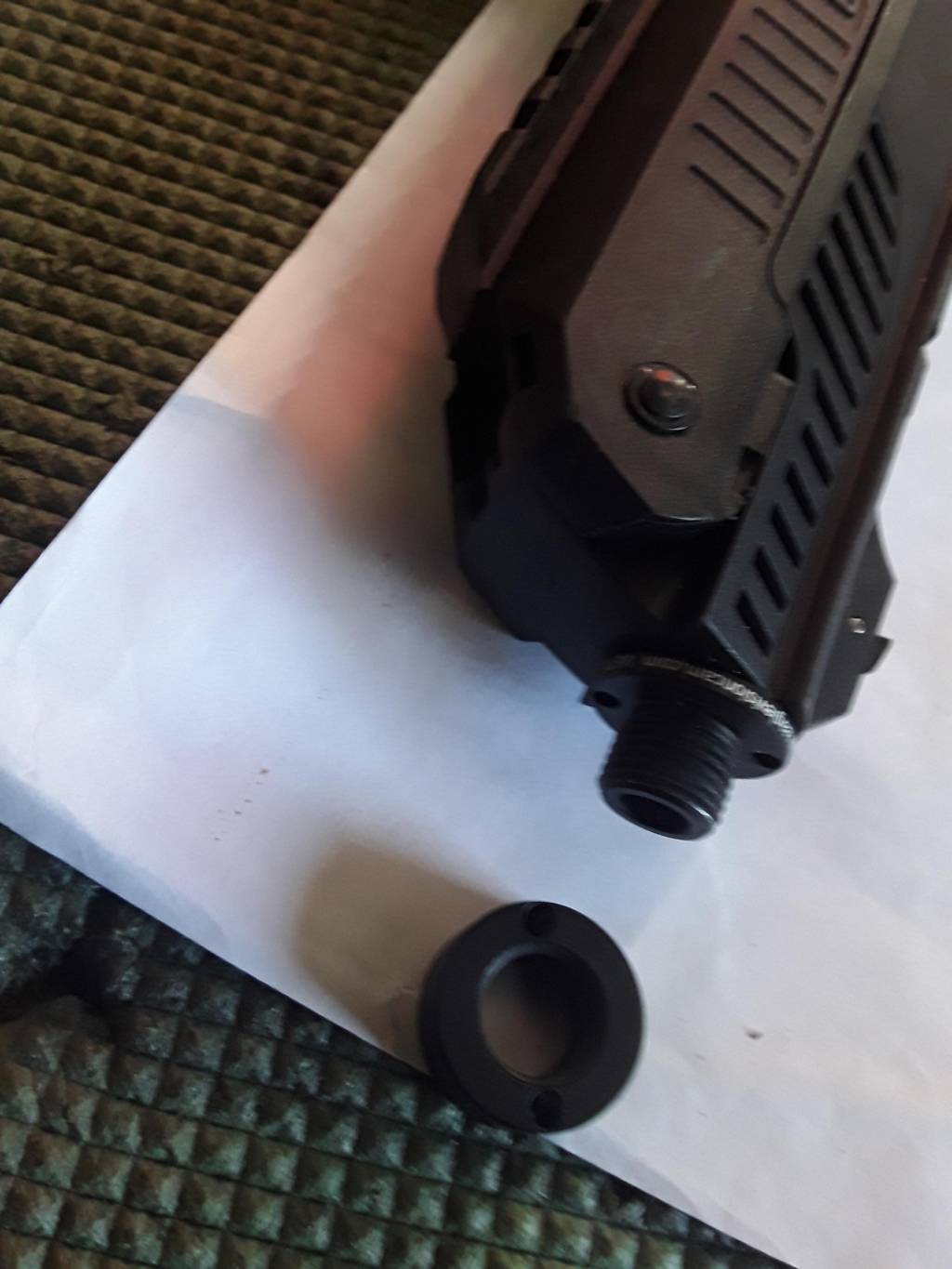

I made an elementary wire stock and got a DonnyFL adapter and Tanto moderator. I had to remove a few thousanths of metal from the end of the barrel to let the adapter slip on. I drilled the rear housing for easy inspection and cleaning of the bore.
I have no data on charge holding over time. Here's my chrono data using H&N Barracuda match with 4.53mm heads, the best heavy pellet for mine:
1 pump - 330 FPS/2.6 FPE
2 pumps - 460/5.0
3 pumps - 550/7.2
4 pumps - 605/8.7
I also have a Beeman P1 Springer. It makes about 525 FPS with lightweight JSB express 7.33 grain pellets. I put a red dot on it. Just barely enough power to penetrate a tough squirrel hide inside 15 yd, and should do OK on rabbits at that range. However, the pistol jumps a lot during the shot cycle and can be extremely frustrating to group well. It is very hold sensitive.
