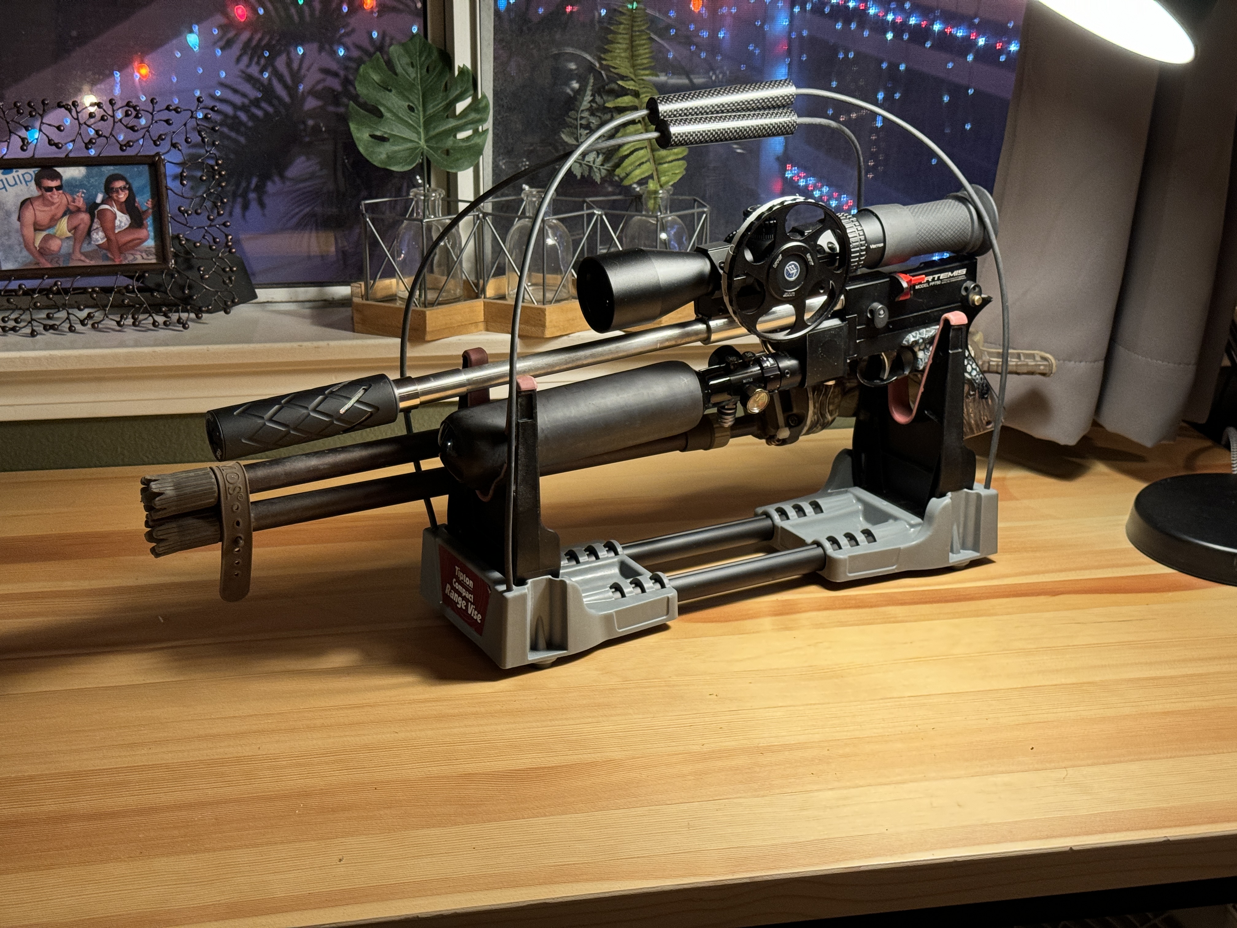

Same problem with smaller pistols using totes made for rifles.
Tipton Compact Range Vise, collapses to shorter lengths, can carry full rifles and bipod:
https://www.amazon.com/gp/product/B00UUBLYGS/ref=ppx_yo_dt_b_search_asin_title?ie=UTF8&psc=1
At corners drilled some holes for 1/8" steel cable covered with shrink tubing, furrel stops on cable ends, open front yoke for cylinder, carbon fiber handles to reduce weight and because all the Kool Kids are doing it.
Lightweight and folds down.

I like this idea, as if I need more excuses and ideas to tinker with! Appreciate it, ill probably make this and a backpack lol.

How did you attach the carbon to cable or are they just free sliding?
