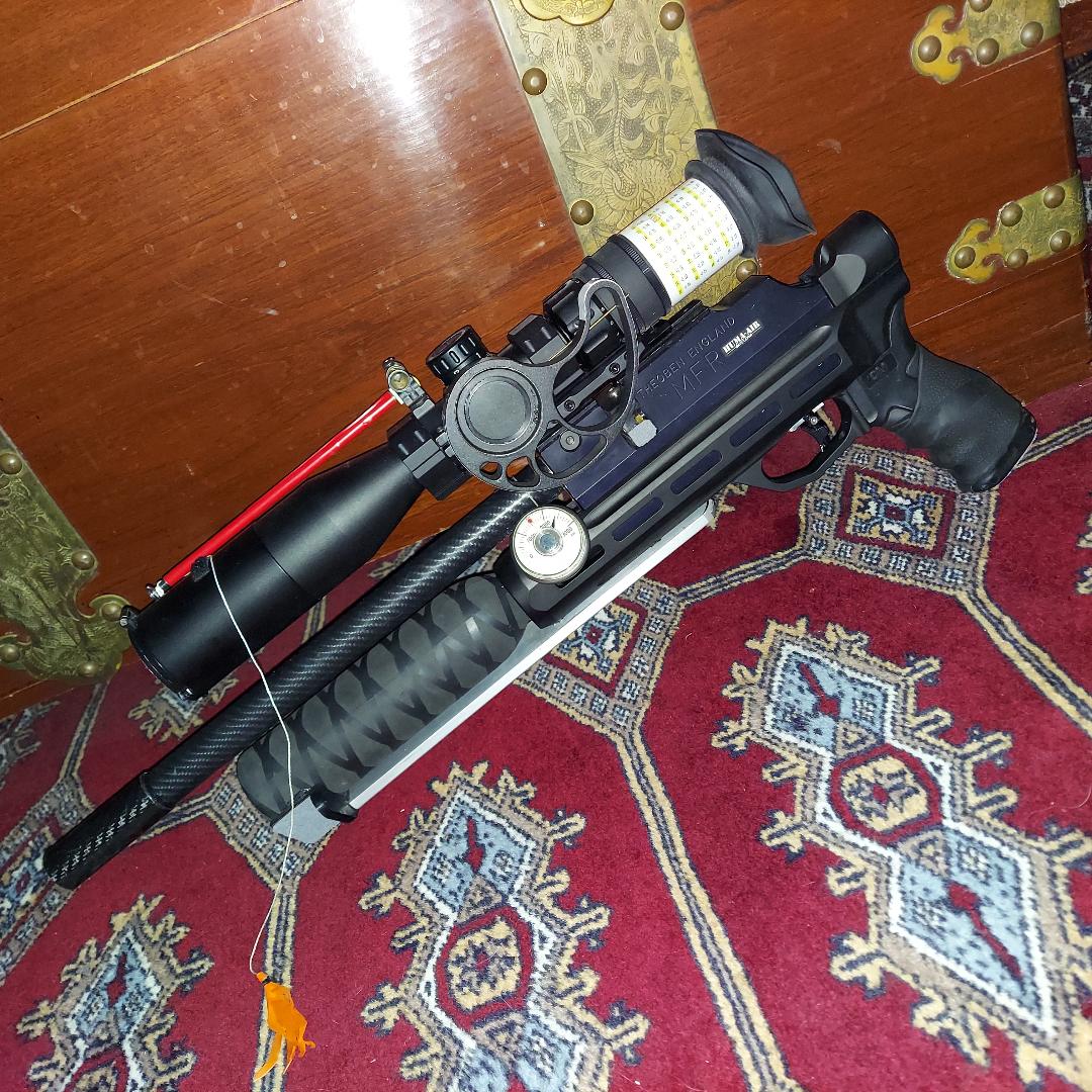

Cameron built this pistol for me using a scope and mount he had on hand. It has a UTG 3-12x44 mini SWAT with mildot reticle. Said for the money the scope ranges very well and I have to agree.
I am with you wishing there was a true pistol/long eye relief scope made with side focus down to 10 yds. I am new to air pistols and after shooting pistol FT and rifle silhouette targets out to 45 yards a few times I appreciate how accurately one can shoot resting one's arms/elbows on the knees and cozying up close to the gun. Couldn't do with a long eye relief scope.
1720 T is a mighty fine pistoli.

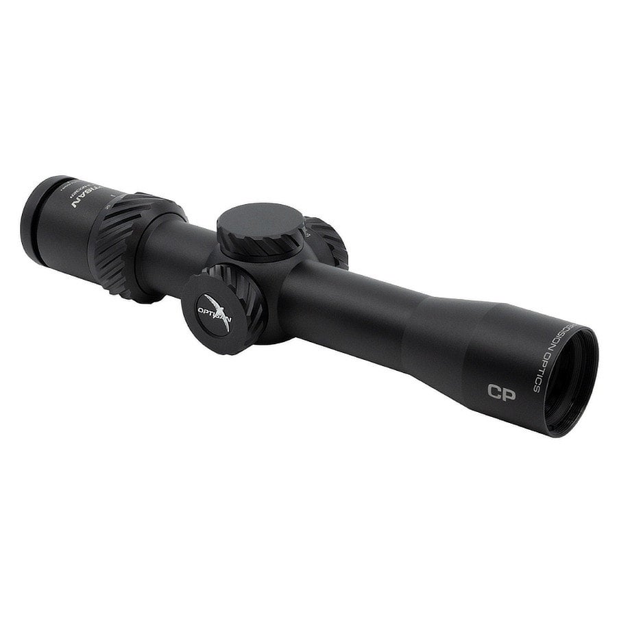

The S-Tac and the Athlons are proven quality scopes. I've considered a Veyron for one of my springers but I'm goosey about cheap scopes. Have you looked at Optisan CP series?? Short, light, FFP or SFP and moderately priced.
I see Utah air carries this one: https://utahairguns.com/product/optisan-cp-3-12x32p-mil-mh10x-rifle-scope/
$320 plus some tax and shipping i would imagine... didn't find Optisan as a stand alone web site? link @jps2486 ?
it weighs a hefty 2 lbs!
the optisan 3-12 weights only 17.17 oz,, the 2lbs under UA web sounds like the shipped weight

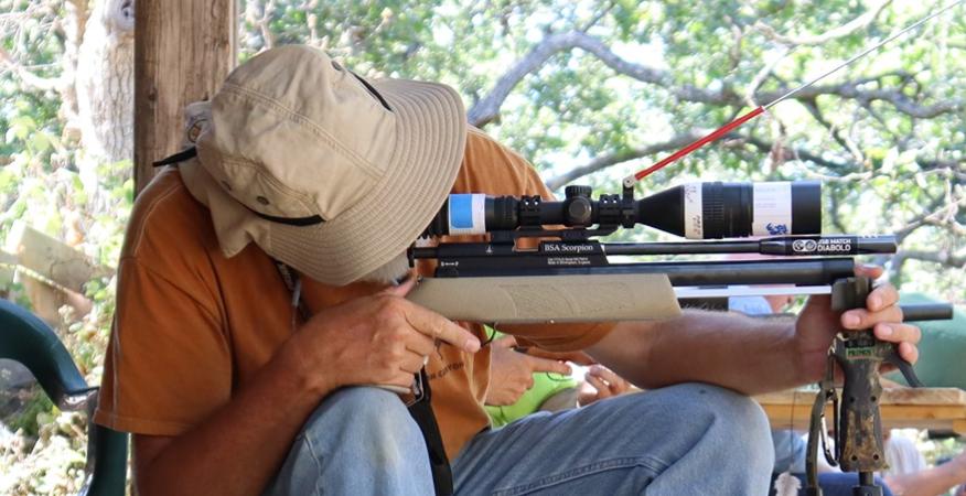

Shot one in PFT "Hunter" for a couple season ... ultimately selling it as the focus NEVER brought the viewed image into being sharp :mad: It ranged well and the no eye relief being able to face check the eye cup did add some stability, but ultimately the lacking of a crisp image started to make my eyes sore after a match from the struggling with focus blurriness.
Since then went back a more traditional rifle scope with a shorter relief Of @ 3" and use a STIFF Bisley eye cup for the face check and added stably.
Mid year & sold the Custom Scorpion pistol and built a new PFT rig using a vintage Theoben MFR ... scoped with a USO TS 3-12x40 that has a very short eye relief, at 12X ranges very well even out to 55 yards shockingly ;)
It set up mounting scope LOW as It would go with forward canilever and using a Bisley eye cup as well. Killer set up and of all the FT pistols I've made the last 10 years think this Theoben pistol is the best yet.
